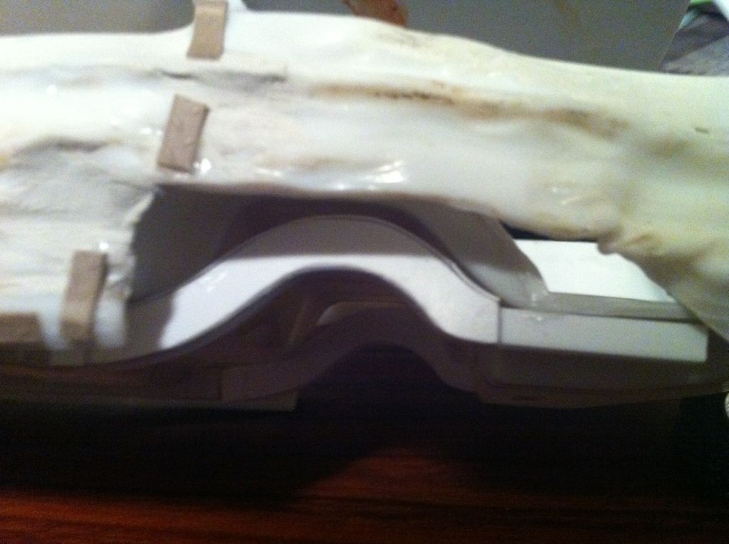

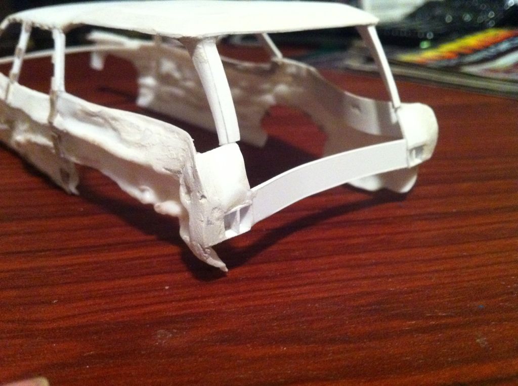

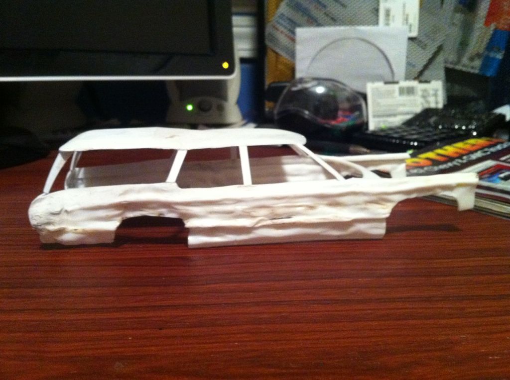

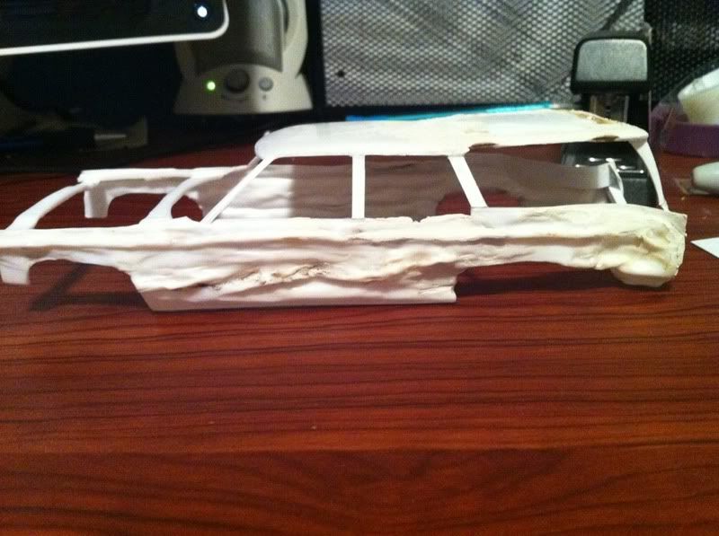

502 Posted January 29, 2012 Share Posted January 29, 2012 I started this build about a month ago. I just work on it here and there when I have the time. Its for a contest in september so I have plenty of time. I started with the amt 76 caprice. The body is really rough and still needs alot of work. I'm calling it a pontiac because the I will be modifing the rear to look like one. However the front clip will be a 76 caprice clip. Im doing this because Im going with a stock body color so I can weather it to look old and rusty. The front clip will be a different color since its supposed to be from a different car. Hopefully I can score more points by doing this. If you look in the picture the the body is cut out behind the wheel opening in the back. Since the gas tank is located there on the real cars when the body bends it gets into the tires really bad. For the frame I will be using a 67 impala frame and tub that will be heavily modified. Quote Link to comment Share on other sites More sharing options...

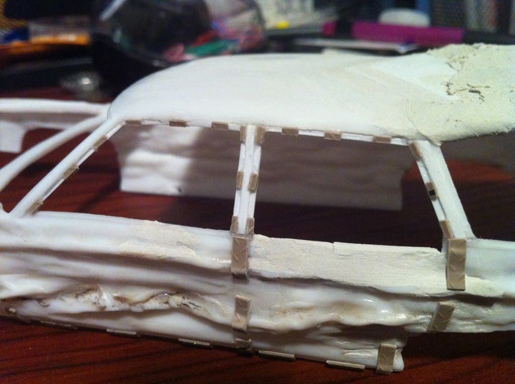

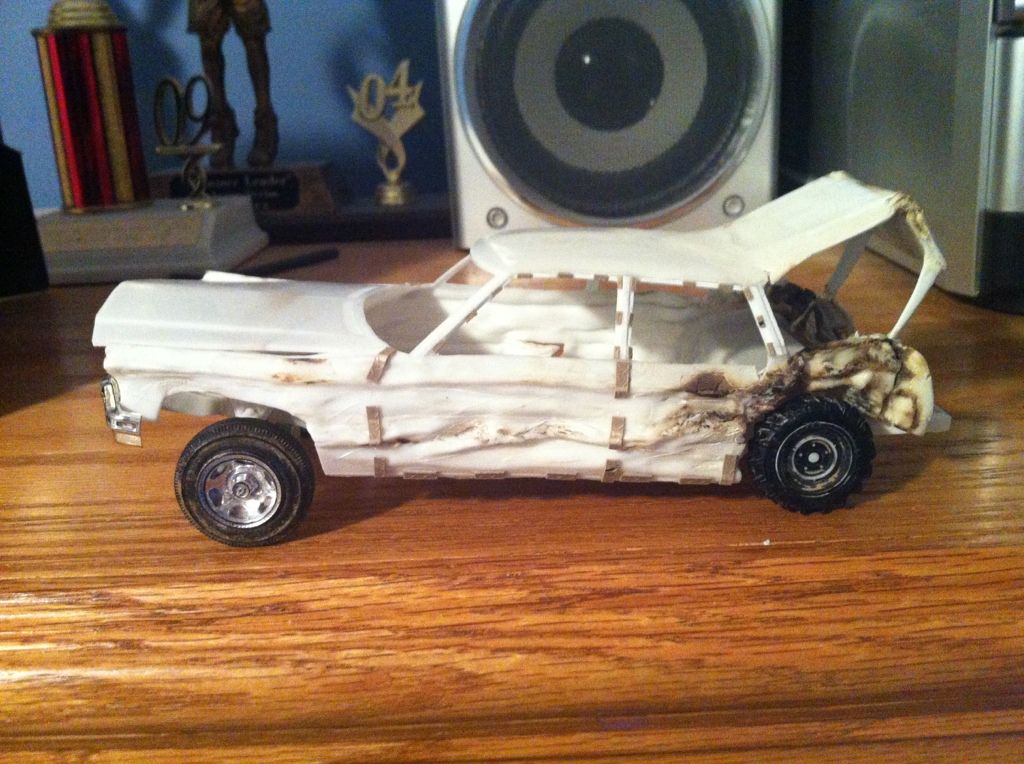

502 Posted February 18, 2012 Author Share Posted February 18, 2012 (edited) I have started on this car again after a little break. I did change my mind on the build calling it a pontiac. Since I didnt convert the front clip Im just calling it a 1976 caprice estate wagon. I will reshape the rear to make it look more like one. The engine Im using is the ls1 from the 2002 camaro. It will have a combination of parts from the 99 chevy silverado because some are better than others. Last night I put some more detail in the door post. Edited February 18, 2012 by 502 Quote Link to comment Share on other sites More sharing options...

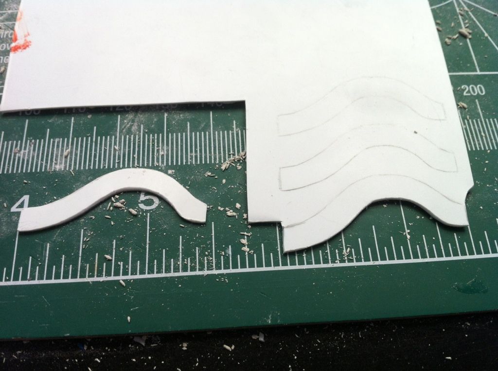

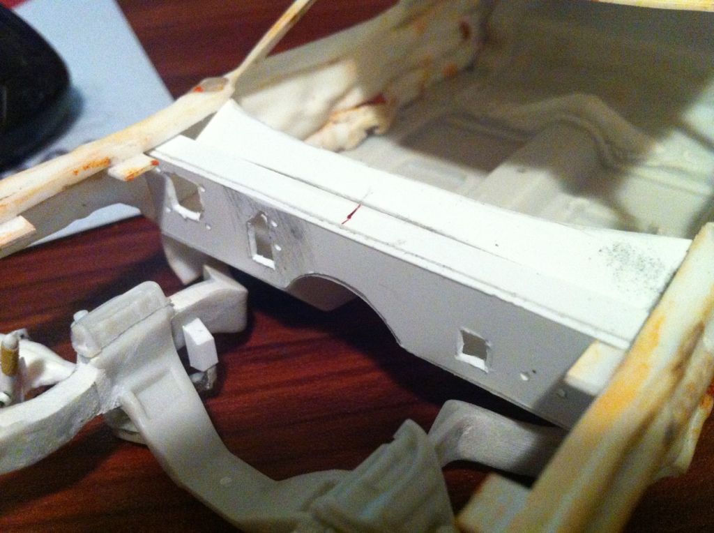

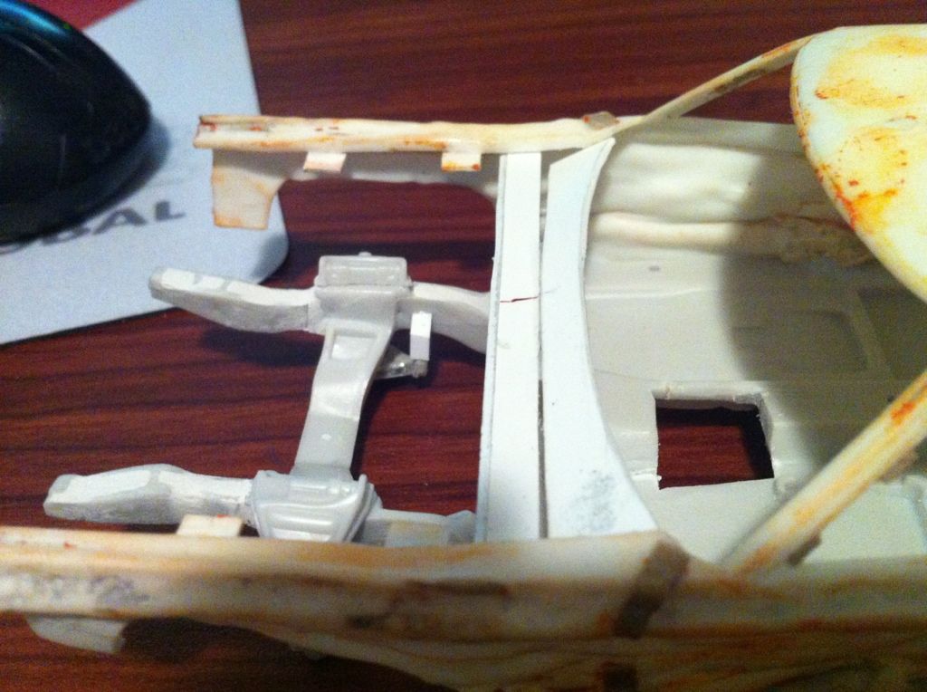

502 Posted March 12, 2012 Author Share Posted March 12, 2012 (edited) Heres some more progress. I cut the rear posts down, started on the tailgate and tailights. I am using a frame from the 1967 impala which is different from a 1976 caprice. I cut the rear frame off in front of the humps and cut the frame in front of the a arms. I took the horns from the 70 monte and put them on. I took the hump from the 67 frame after cutting it off and used it as a template for my new rails. The frame from in front of the humps back on these cars is c-channel which is the main readon for making the new rails. As you can see theres still alot of work left on the passenger side. Edited March 12, 2012 by 502 Quote Link to comment Share on other sites More sharing options...

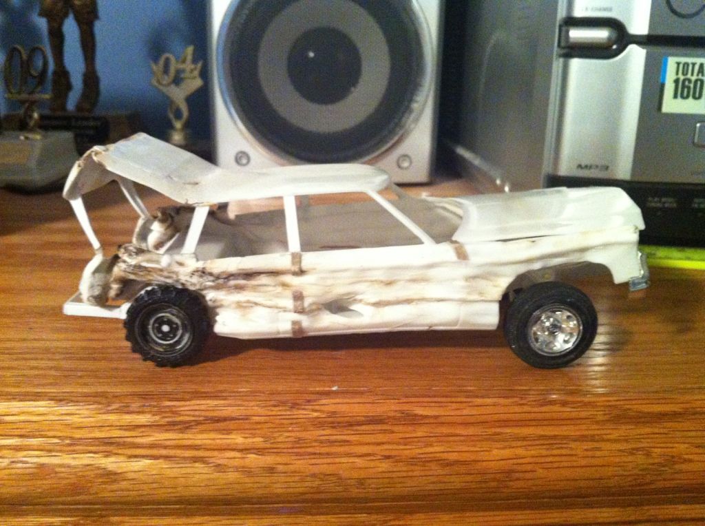

502 Posted May 14, 2012 Author Share Posted May 14, 2012 Some may have thought this project was abandoned. After a couple months of not working on it and almost selling it I have found new inspiration for this build. It looks alot different now as you can see. Quote Link to comment Share on other sites More sharing options...

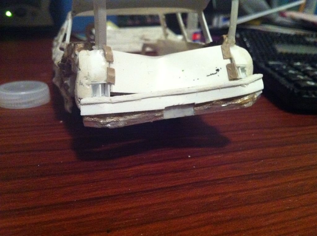

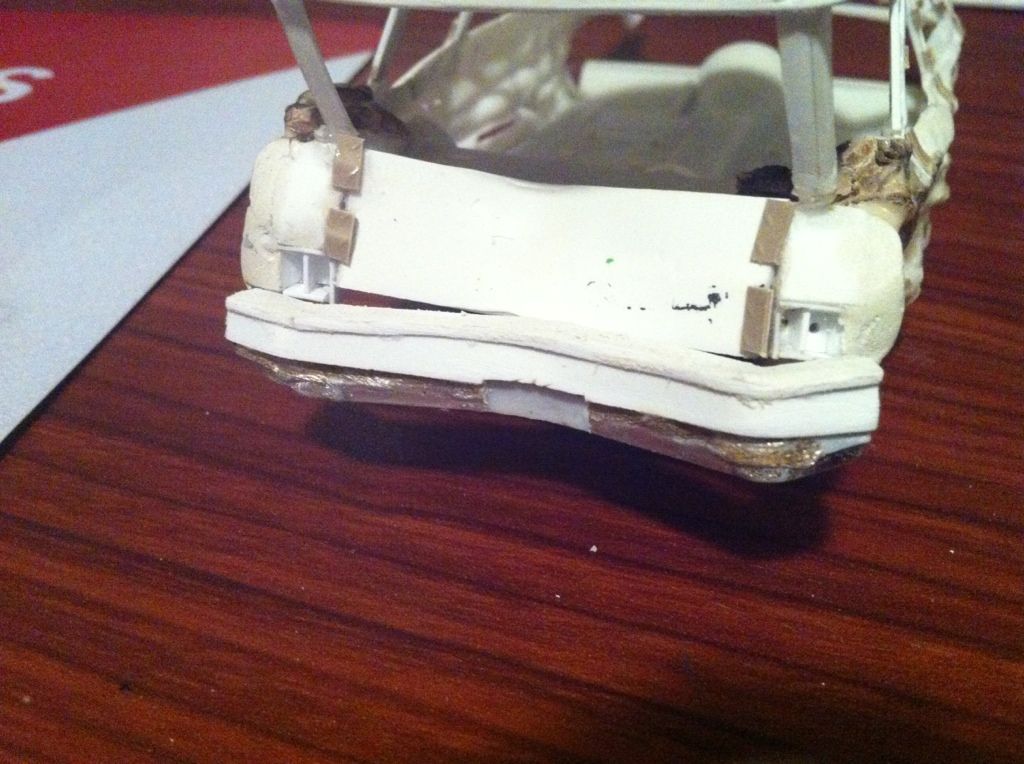

502 Posted June 13, 2012 Author Share Posted June 13, 2012 (edited) I took the bumper from the 76 caprice and added to it to look more like a the bumper from a wagon. I also got the tailgate on. Edited June 13, 2012 by 502 Quote Link to comment Share on other sites More sharing options...

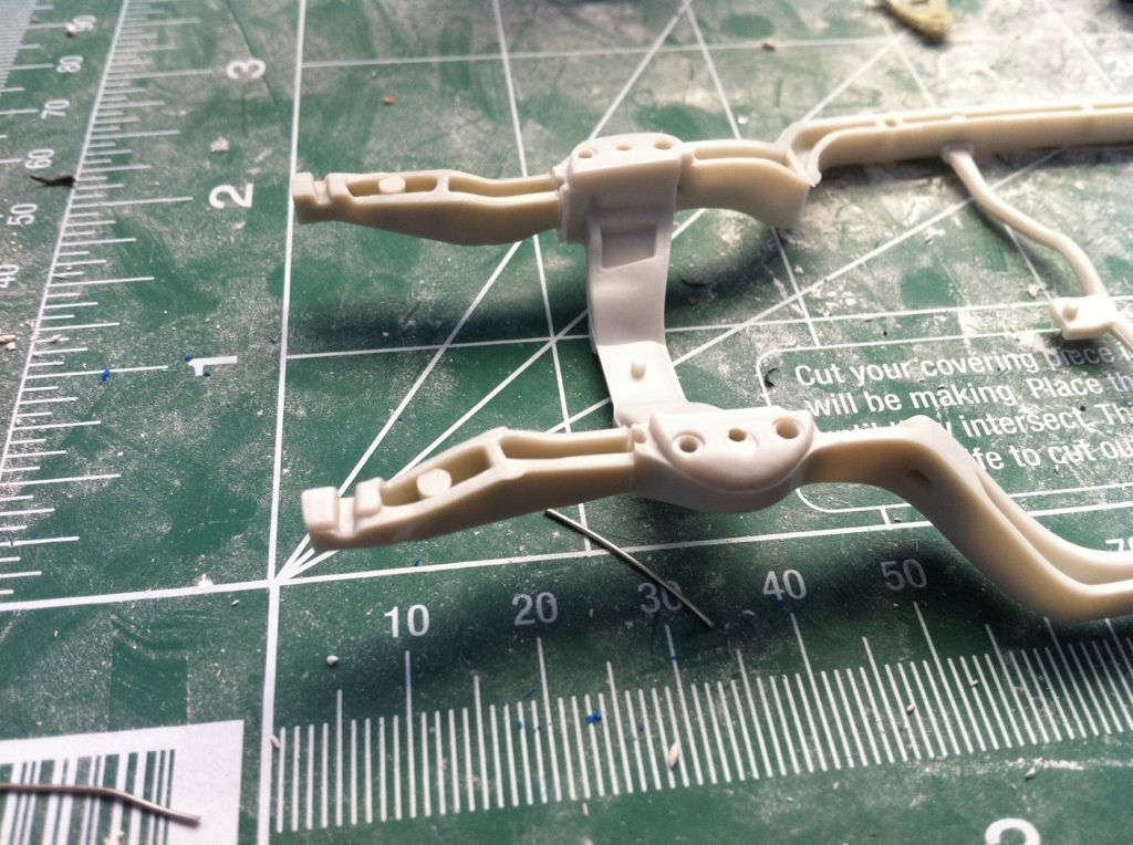

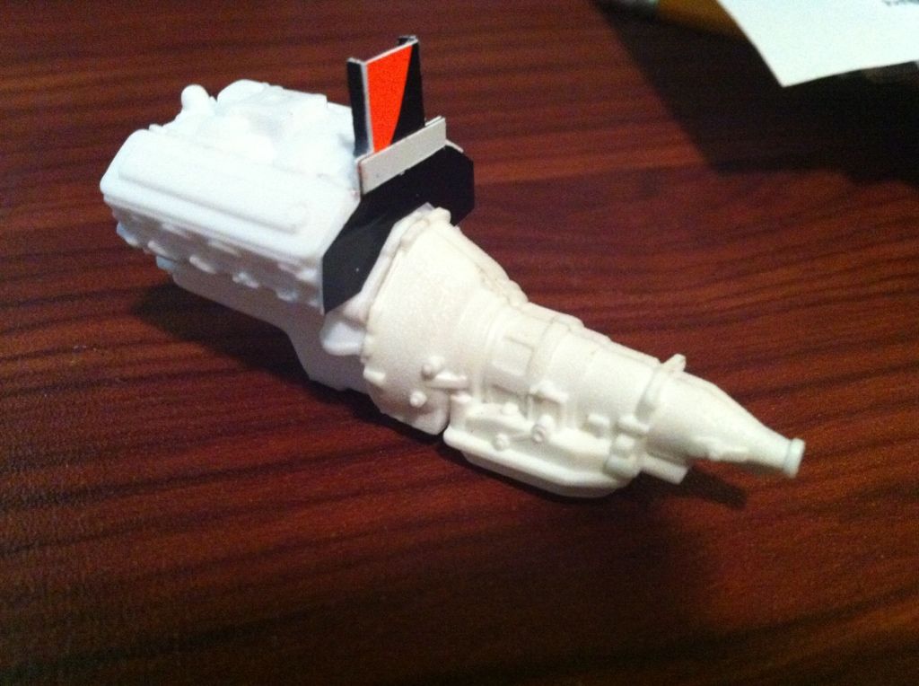

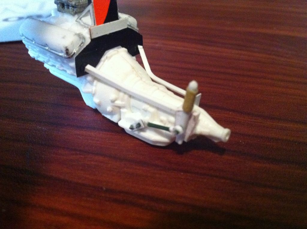

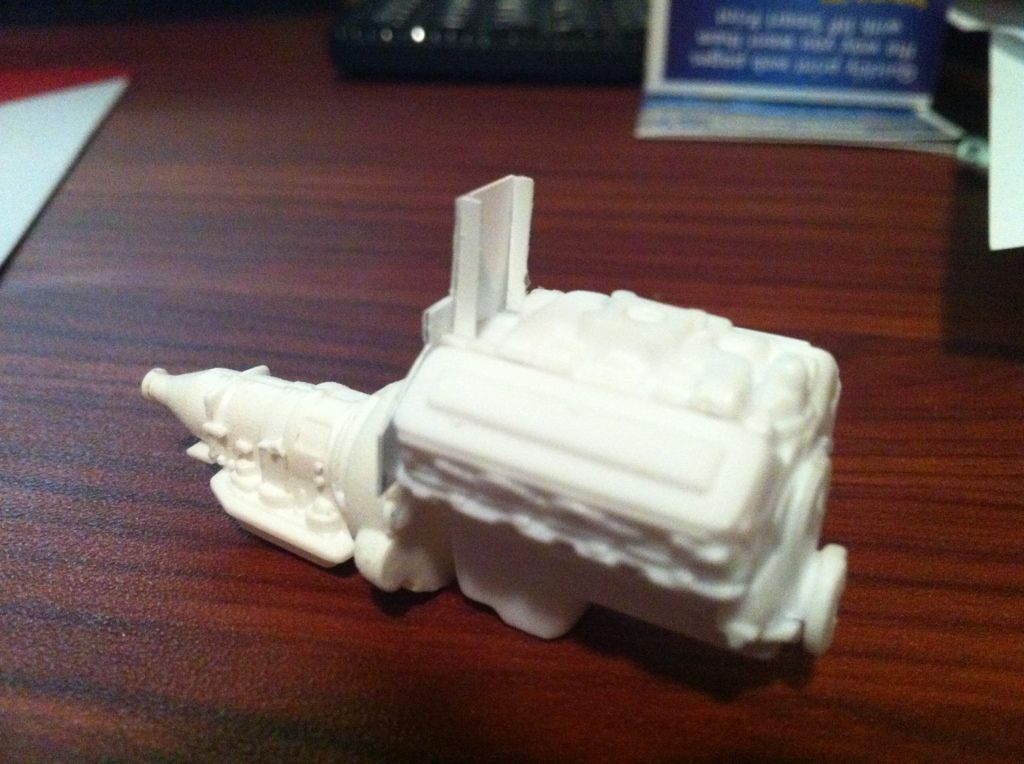

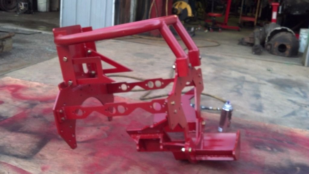

502 Posted July 3, 2012 Author Share Posted July 3, 2012 (edited) I started on the motor. I am using the motor from the 66 chevelle wagon but I cut the tranny off to switch it to one of amt's ford trucks because its really detailed. I started on my cradle and protector, which is supposed to look like the m1 extreme setup. Edited July 3, 2012 by 502 Quote Link to comment Share on other sites More sharing options...

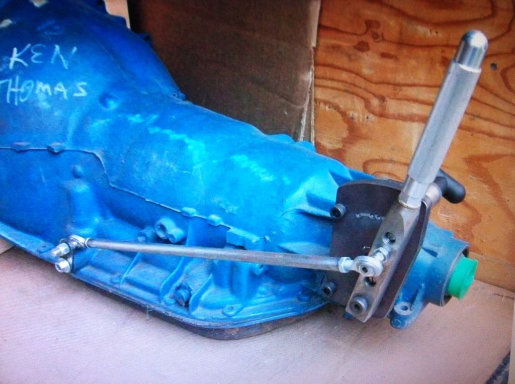

502 Posted July 3, 2012 Author Share Posted July 3, 2012 Heres my shifter and I started my tranny brace. Quote Link to comment Share on other sites More sharing options...
camarofreak82_427 Posted July 3, 2012 Share Posted July 3, 2012 Man that looks so sweet I love the engine craddle n the shifter u really put great detail in this one. If u need referance pics wecrash and we crash proboards. Com have some great pics but ur doing a fine job. Quote Link to comment Share on other sites More sharing options...

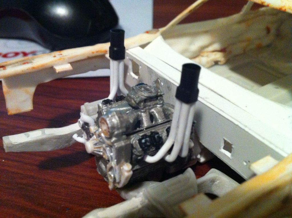

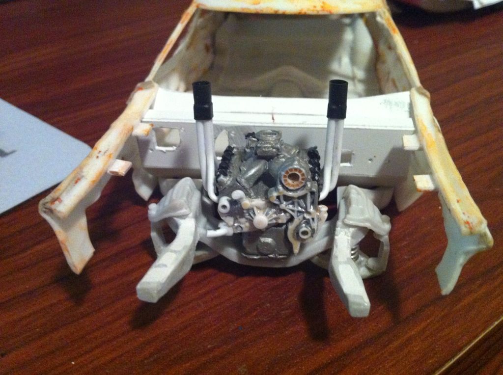

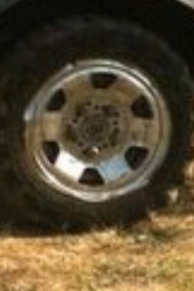

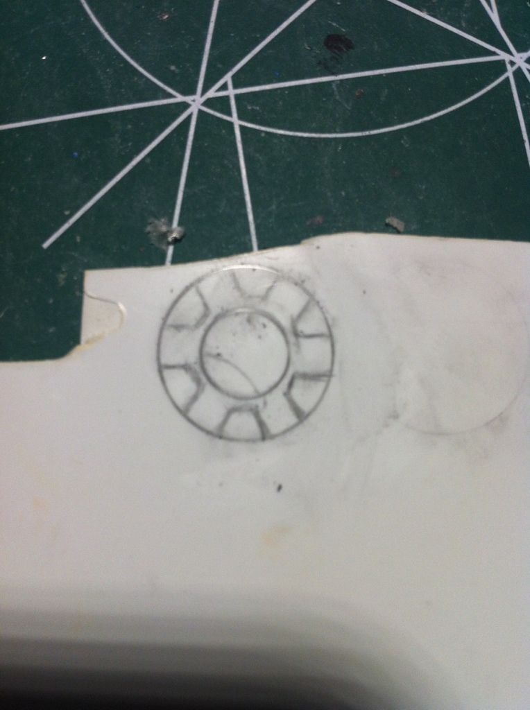

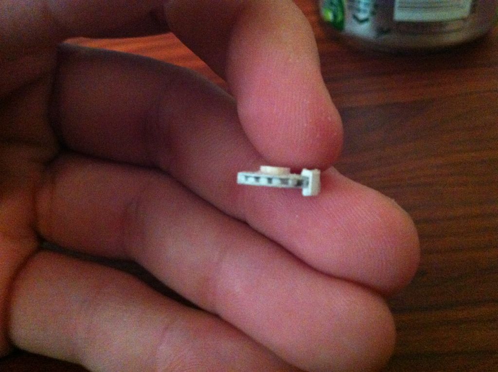

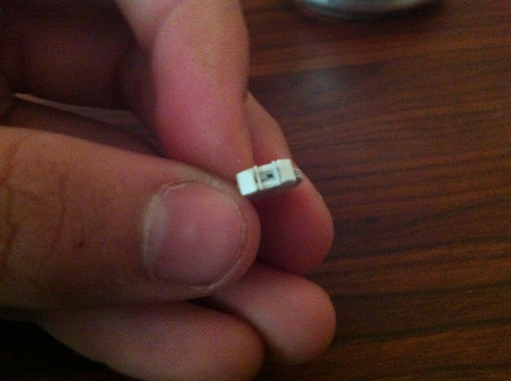

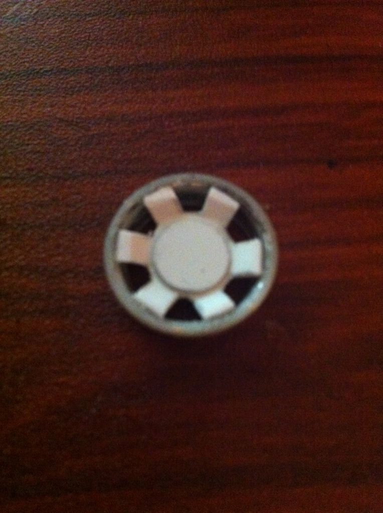

502 Posted July 9, 2012 Author Share Posted July 9, 2012 I decided I would make my own rear wheels. I made them to look like woodward custom wheels that alot of people run on their cars now. This was the 4th attempt, finally found a method that works. Quote Link to comment Share on other sites More sharing options...

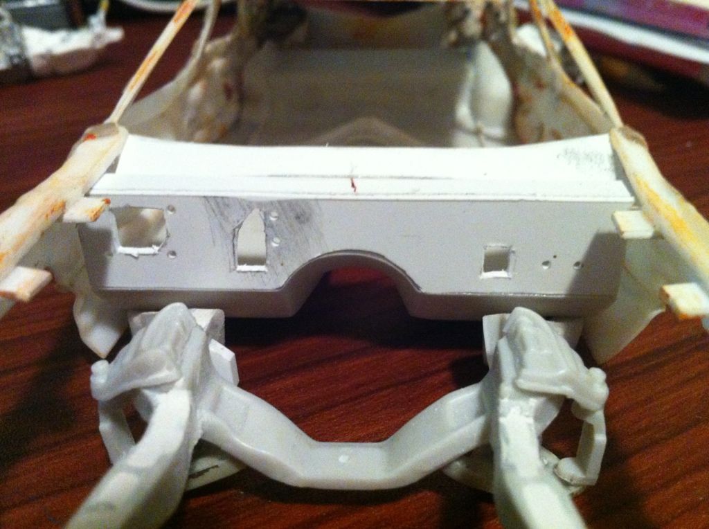

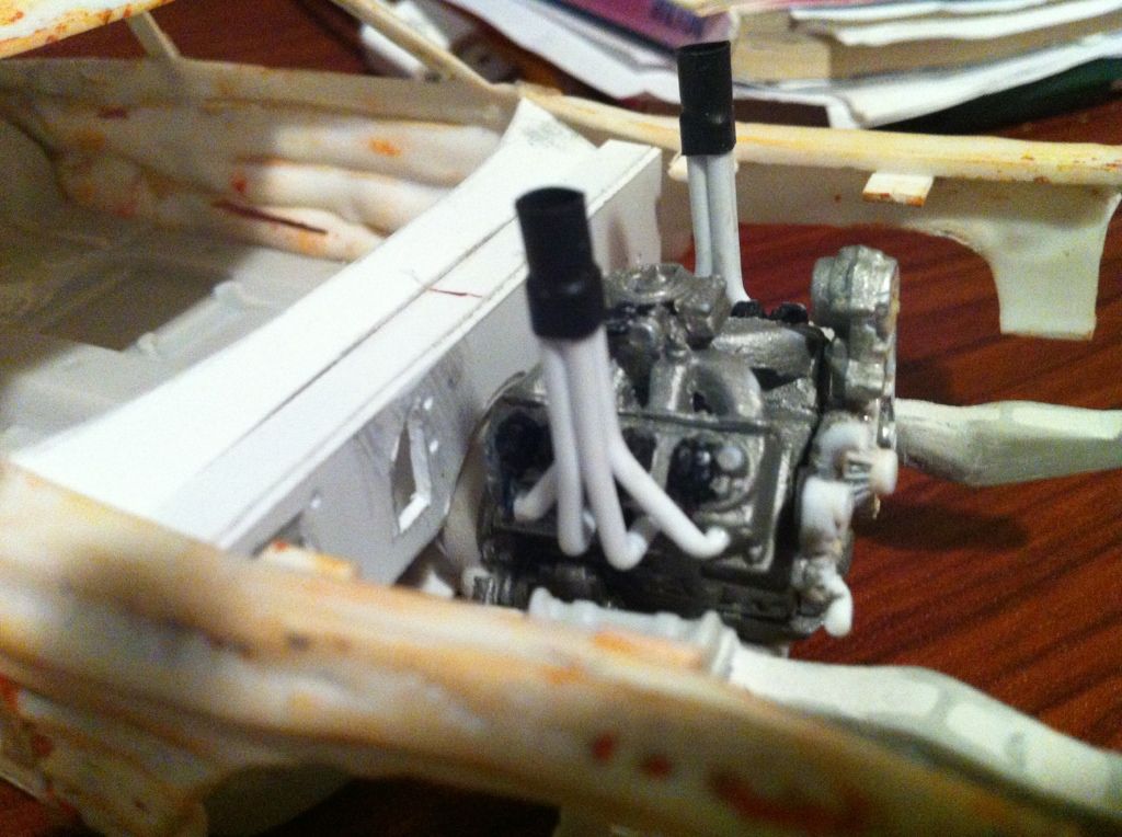

502 Posted July 14, 2012 Author Share Posted July 14, 2012 Had a change of plans, I was putting this on hold but I decided to go ahead and build it. I changed motors to an LS engine but I kept the same tranny. I started scratch building the firewall tonight. Hope to make it to Derby City Shootout with this car but we will see. Quote Link to comment Share on other sites More sharing options...

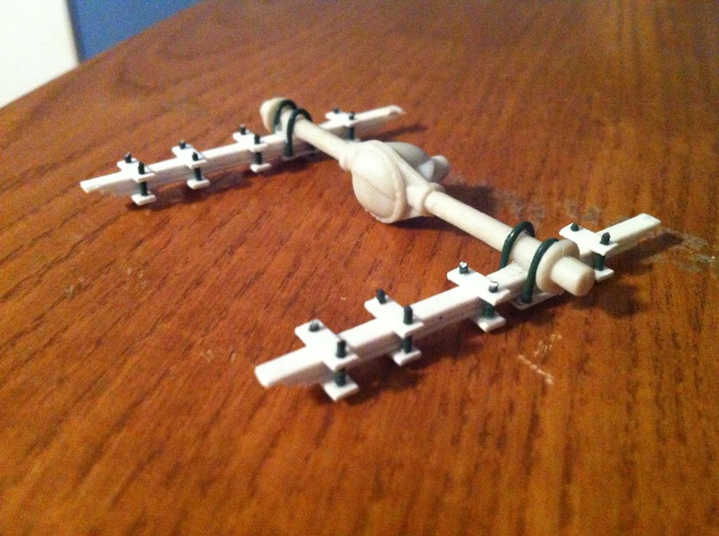

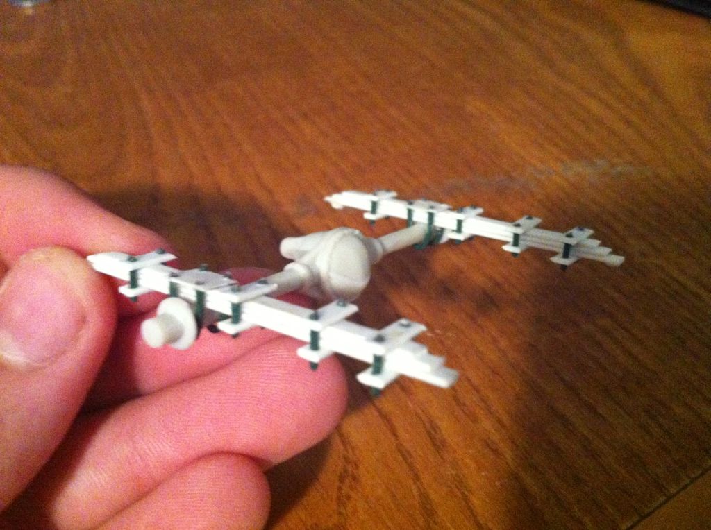

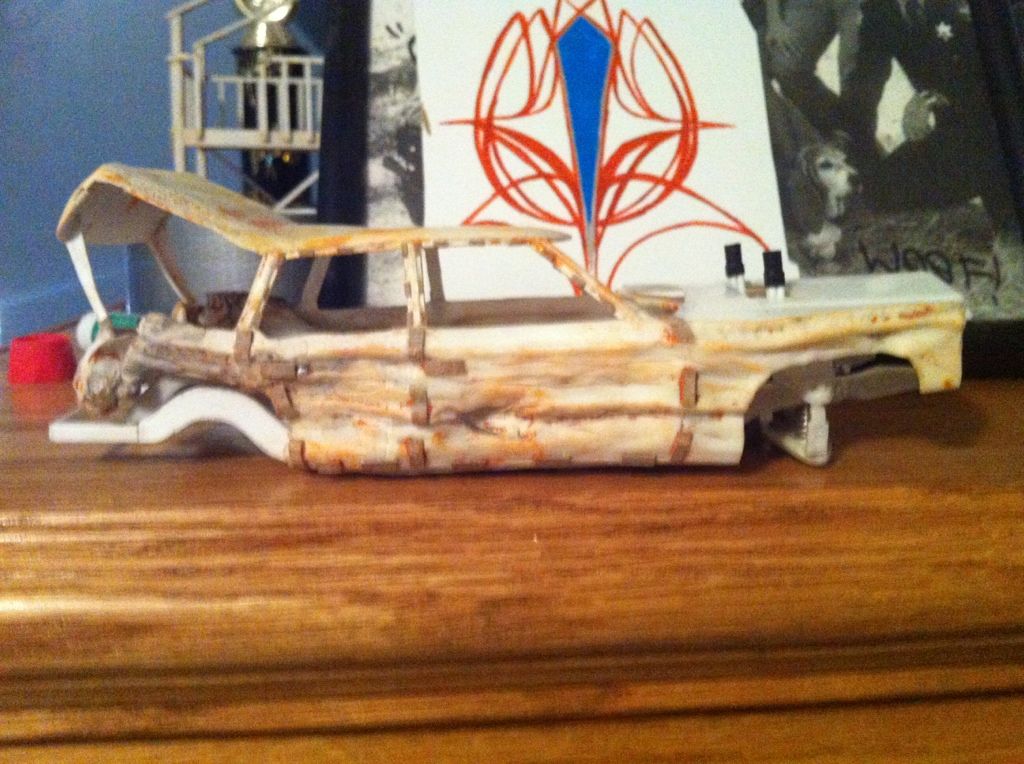

502 Posted August 16, 2012 Author Share Posted August 16, 2012 I really have to get going on this car now. The contest Im building for is september 28th. Latest progress is my leaf pack and driveline brake. Quote Link to comment Share on other sites More sharing options...

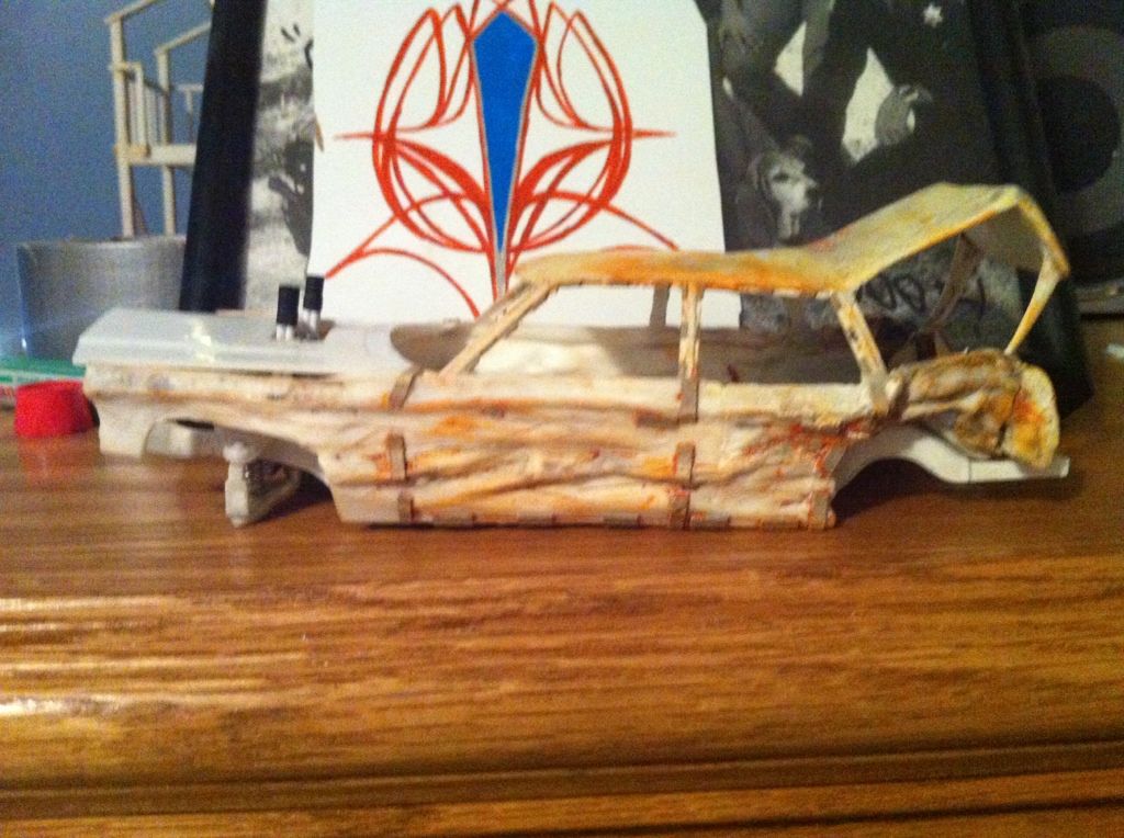

Shane94 Posted August 25, 2012 Share Posted August 25, 2012 I started this build about a month ago. I just work on it here and there when I have the time. Its for a contest in september so I have plenty of time. I started with the amt 76 caprice. The body is really rough and still needs alot of work. I'm calling it a pontiac because the I will be modifing the rear to look like one. However the front clip will be a 76 caprice clip. Im doing this because Im going with a stock body color so I can weather it to look old and rusty. The front clip will be a different color since its supposed to be from a different car. Hopefully I can score more points by doing this. If you look in the picture the the body is cut out behind the wheel opening in the back. Since the gas tank is located there on the real cars when the body bends it gets into the tires really bad. For the frame I will be using a 67 impala frame and tub that will be heavily modified. Quote Link to comment Share on other sites More sharing options...
Shane94 Posted August 25, 2012 Share Posted August 25, 2012 I ment to add stuff to that..lol my bad! How did you get the body so crinkled like that? Like I put dents and stuff in mine but they NEVER look as good as your dents! Quote Link to comment Share on other sites More sharing options...
