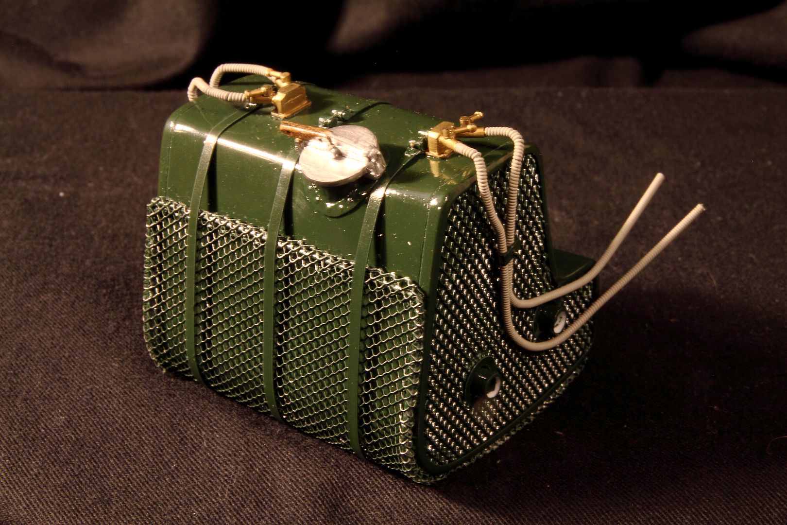

Next, I cut .040" styrene formers using the remains of the kit fuel tank as a template, and "skinned" it with .020" sheet.
The aluminum mesh isn't quite right, but it was the closest thing I could find. (of course, after it was painted and installed I found the perfect material!)

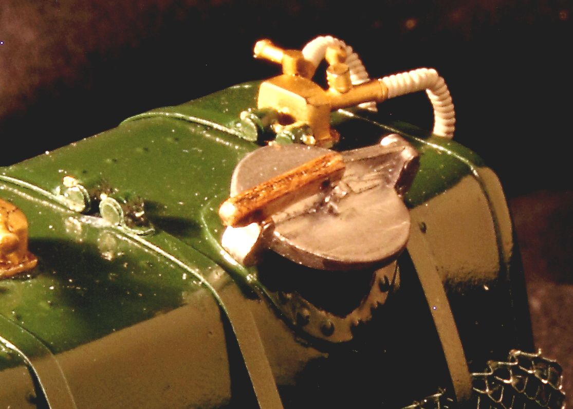

More guitar string, and fuel petcocks made from Evergreen rod. The straps are .005" styrene strips and the rivets are resin decals from Archer.
Here's a closer look at the strap tensioners and the rivet detail.

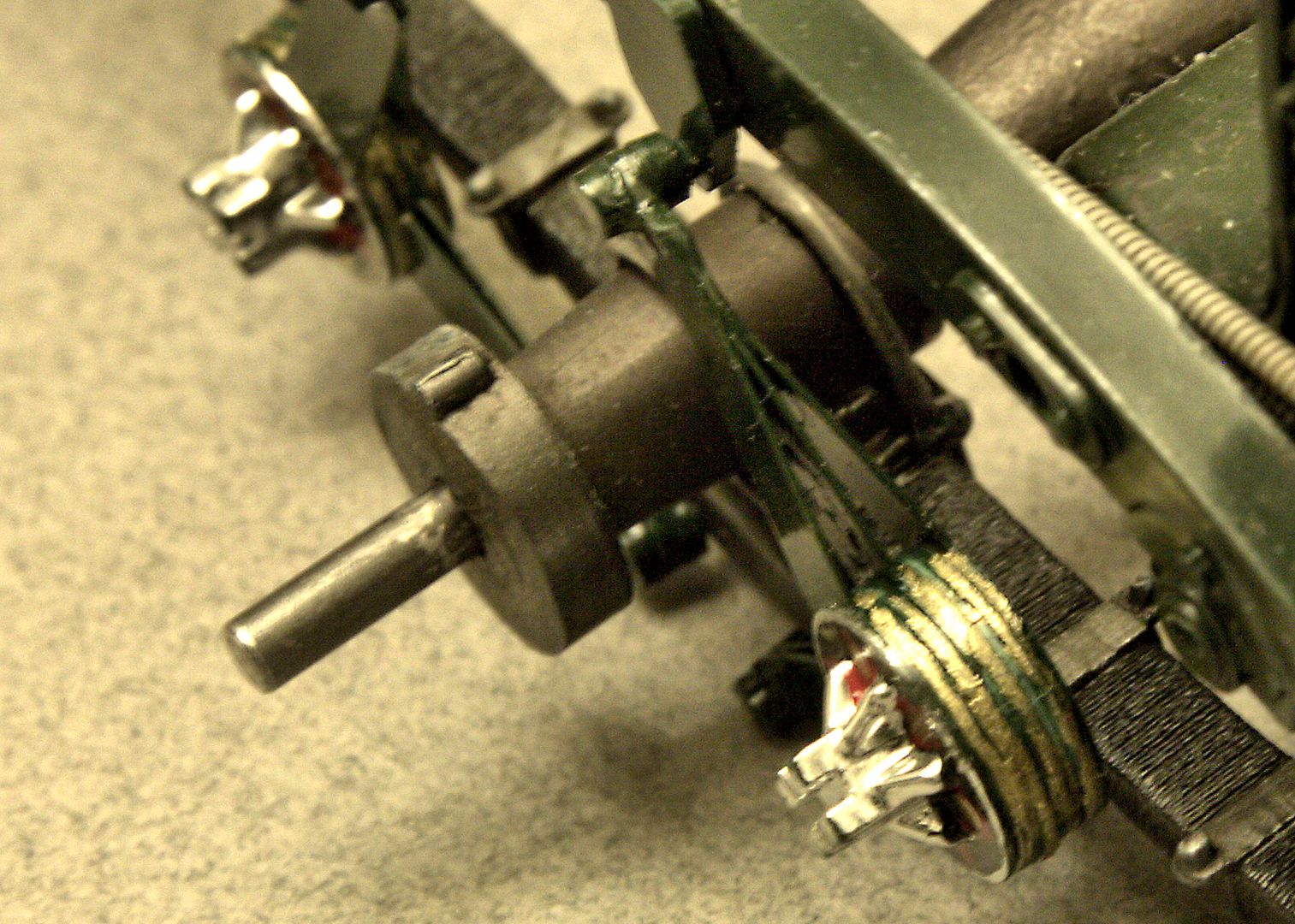

The fuel tank, rear end and dampers have been installed.
Here's a closer shot of the damper assembly: scratch built from .010 & .020 styrene, except for the adjusters which were carefully sawn from the kit parts.
Also, like Harry, I shaved off the wrapping detail from the leaf springs and replaced it with thread.
The cast texture was added to the axle housing with thinned putty and a peice of foam packing material.
