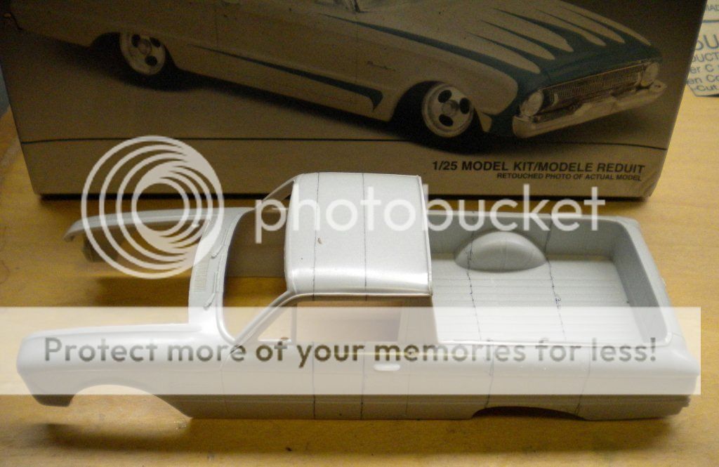

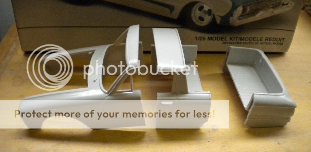

This is one of my favorites, I love the shape... So, I'm going to cut it up! :D
I measured a 1" section for the Bed and an 1/2" section for the Cab with masking tape.
Then I outlined the tape with a marker and removed the tape.
When you cut, be sure to cut inside the lines, don't go over! This will keep things much straighter.
I cut out the sections with a Cut-Off Wheel in the Dremel Tool. Then I placed the sections on a piece of 100 Grit Sandpaper and slowly moved them across the sandpaper untill they were smooth.
Edited by Ira
Share this post
Link to post

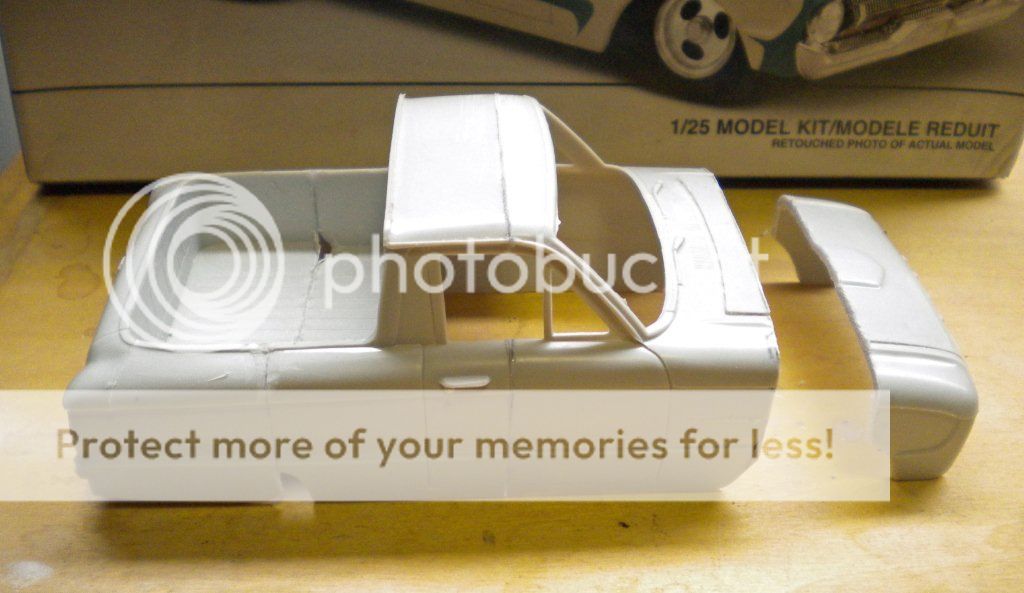

Back Together Again...
I glued the Body Sections back together again, making sure to line up the details!
Next I cut 3/4" from the Hood Section...
I glued it back together with Zap-A-Gap Green Label Glue.

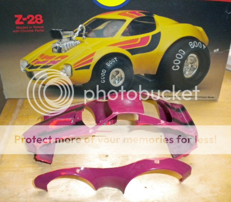

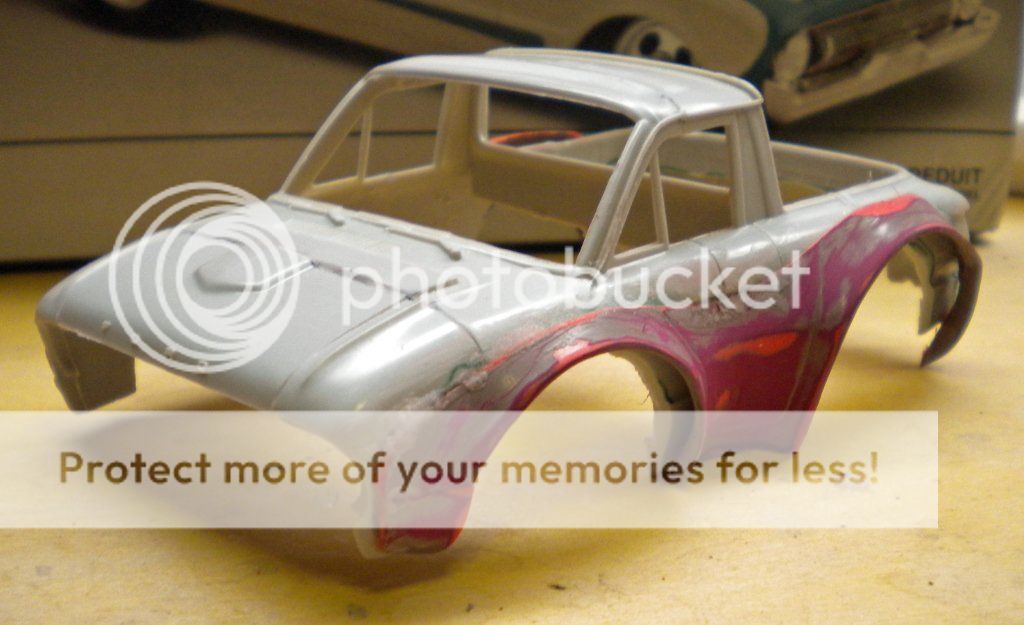

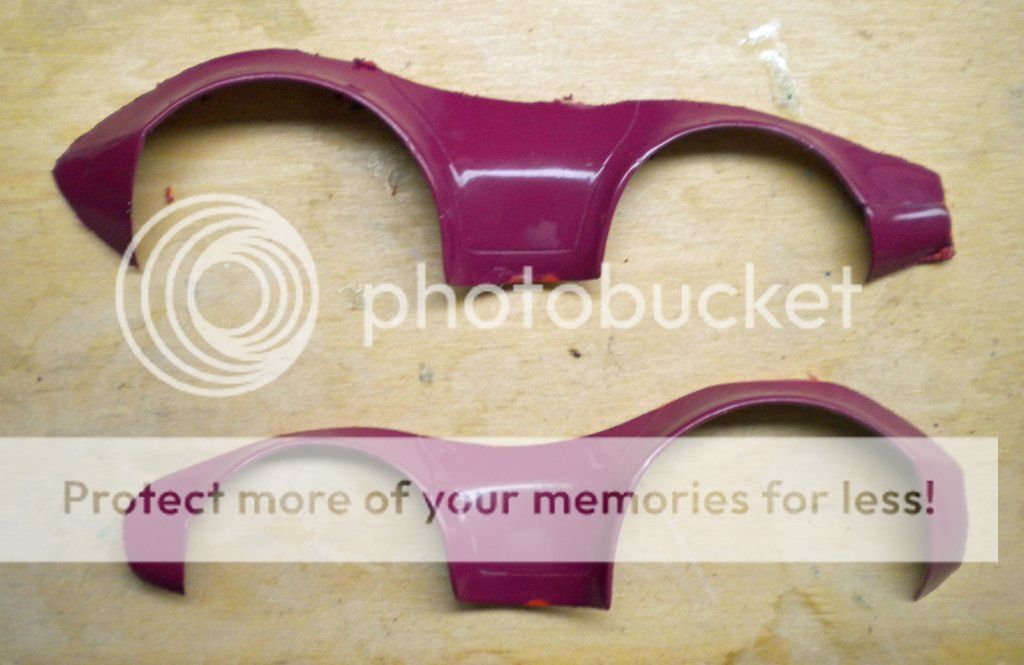

SLICED THE SIDES OFF THE Z-28!!!
Revells Z-28 Funster is the 2nd kit used in this project.
I layed a strip of masking tape down each side of the Z-28 for the cut lines. Then I cut one side off with a Cut-Off Wheel in the Dremel Tool.

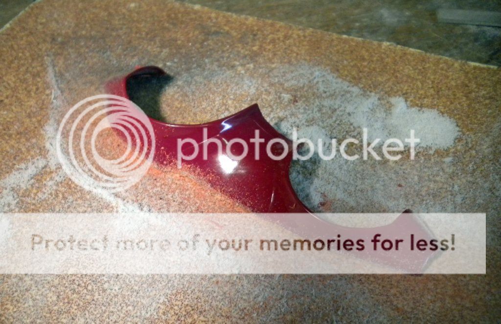

I used a piece of 100 Grit Sandpaper to level the side pieces up.
I cut and fit the Z-28 side to the Ranchero side untill I got a pretty good match.
Then I cut out the other Z-28 side and cut and fit it untill it matched the other side of the Ranchero.

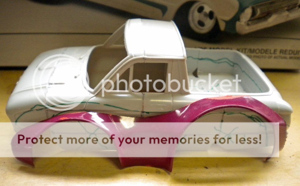

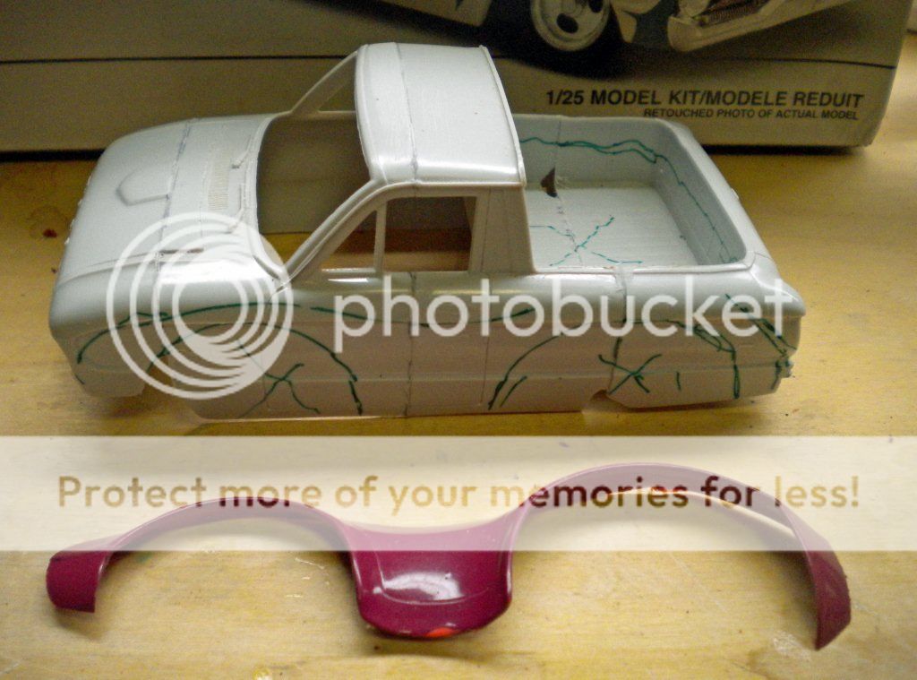

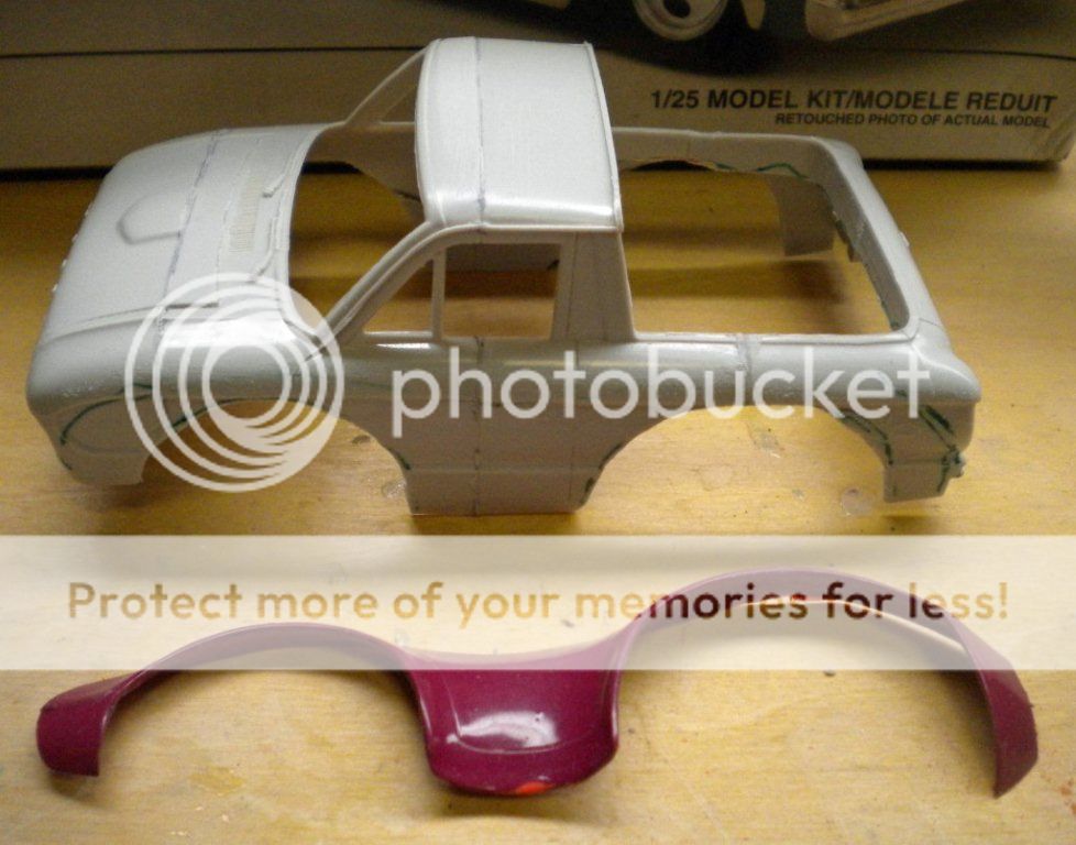

CUTTING & FITTING!!!
I did a lot of this.....fitting the Z-28 sides to the Ranchero, and then cutting or carving the sides untill the fit was tight!
When the fit was right I traced the position of the Z-28 sides, on to the Ranchero. The areas marked with an "X" are to be cut.
Here is the first round of removing the excess plastic from Ranchero sides.

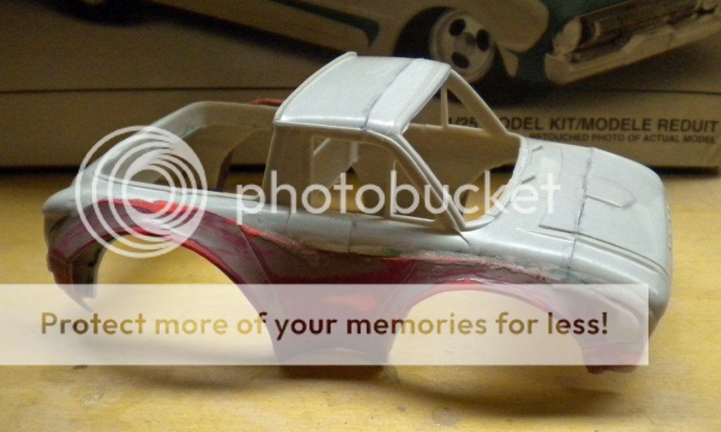

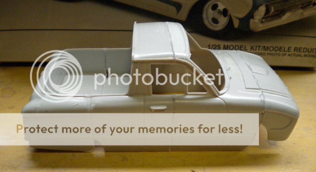

Z-28 RAMCHERO!!!
Here are the Z-28 Sides in place on the Ranchero...
I was thinking, it might be Fun to make this into an Off-Road Truck for the BAJA 500, with Roll Bars, Big Lites and Monster Engine.
Maybe even dirty this one up a bit. This might be a good time to try a little Weathering or at least a little Mud Splatering on the Ranchero...
What do you think? B)
