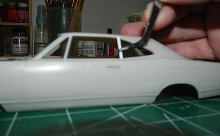

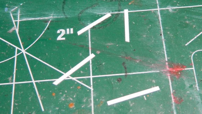

I started sanding the mold seams and then realized that this car had B pillars - the kit doesn't. Okay, no problem. Time for me to jump in and get something started - we need some B pillars.

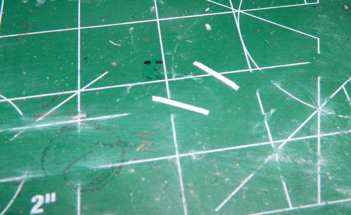

So I pulled out some plastic strip and start trimming until I get it just about right.
Then I realize that there's just these little teeny nubs at the ends of the pillars for support - chances are knowing my luck, I would break them a dozen different times. They need better support. So I cut a couple more pieces slightly longer than the first ones:
Yep, these are going to be used to support from the back - it'll give more contact area so less chance of breakage. I glued the "fitted" pieces to the slightly longer ones as so:
Now, I was able to put these in without worrying about them nearly so much. Here's the results:

Good idea on backing the pillar with another longer one Scott and I'll have to remember that when I fix a broken one. Thanks.

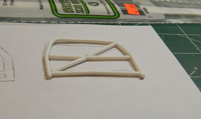

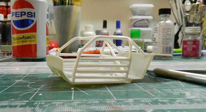

I did get started on the rollcage. Not much done yet, but it does fit so that's a good thing. I got a slight twist in it that I'll need to get out tomorrow. That's it for tonight.

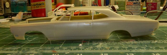

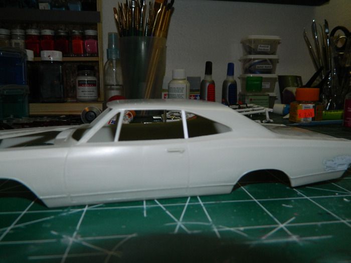

Someone pointed out to me that the body I have is for a '69 GTX and not a '68 Roadrunner. So I will be doing some more sanding to get rid of the GTX trim on the body. I'll post pics when I have an update on that.
Share this post
Link to post

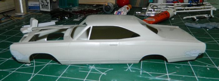

When reviewing the car body, it was found that the B pillars were at the wrong angle - they should be parallel with the wing windows as can be seen in the above photo. This has now been corrected. Also, all of the GTX trim has now been sanded off from the body sides and the wheel wells. This is starting to look more like it should now.
The rollcage is coming along. We're not done yet, but it is starting to take shape now.

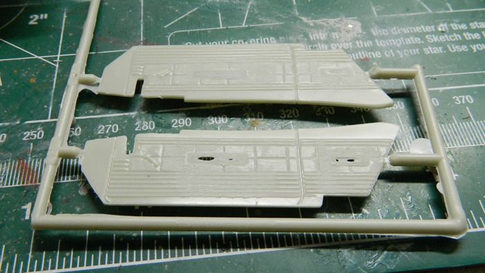

I can't be sure, but it seems that they still had the door panels on the inside of the car at this time. So I figured that I would use them. I sanded off the armrests from the interior doors. There's still some more work to be done on these doors to make them flat, but we're getting there. The only thing that should be on here are the window cranks (if I am wrong, please let me knpw).

Why not swap them left side to right side and use the back side of them??
Just a thought.. :)
Share this post
Link to post
Good idea, Rodney - the back side has an AMT Ertl stamp on it, but it may be less work to fill in the holes where the armrests were and sand down the raised text - thanks for the suggestion.

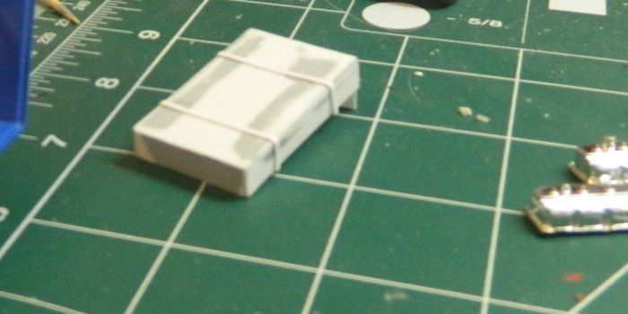

Not much of an update, but I wanted to let you all know that I was still busy on the Petty car.

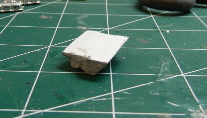

I started working on the fuel cell that will replace the kit's molded in gas tank - it's still kind rough, but at least you can get an idea for what I am going for here:

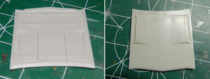

Also, I am going to have to address the hood. It has "cut outs" on the bottom so you can easily cut a hole in the hood - only problem is that this causes it to be visible (and you can feel it) on the top of the hood - I'm going to have to fill that then sand down the top of the hood to make it smooth between the two "bumps":

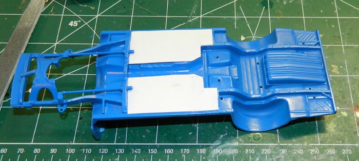

Well, I started covering the chassis pan. I have left the driveshaft tunnel uncovered. If anyone knows if this should be covered, too, please let me know.
Also, the slits cut into the hood have been filled, so I will (hopefully) start sanding the hood down tomorrow. I was going to primer the body today, but weather is against me, so maybe tomorrow.
