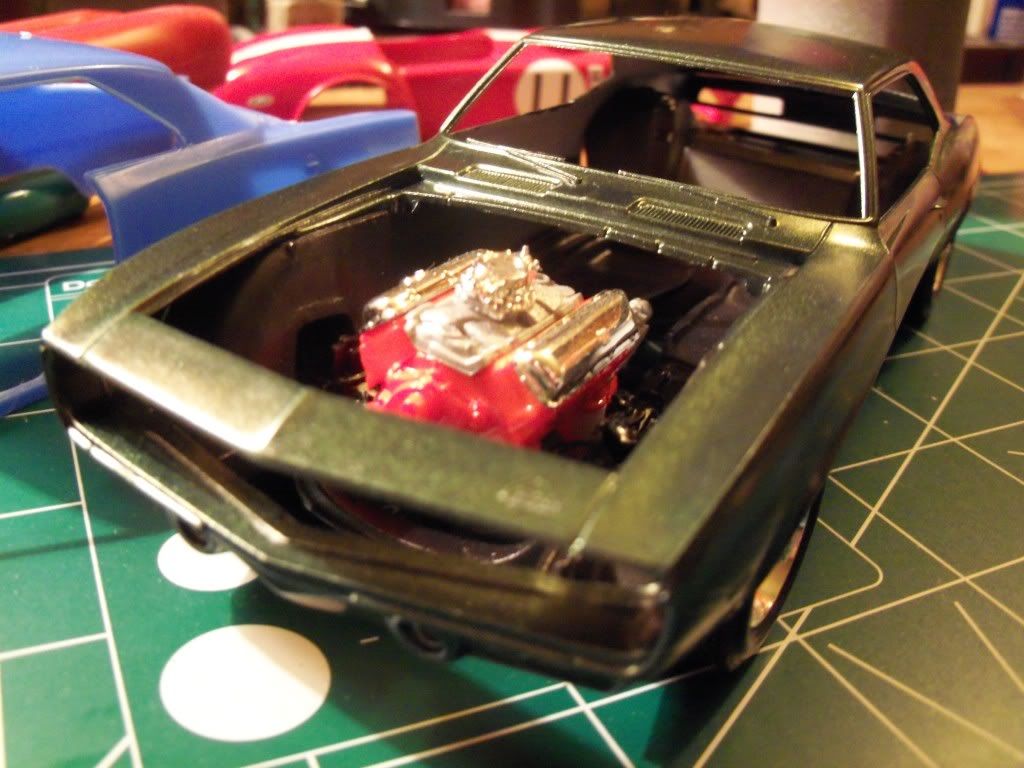

SuperStockAndy Posted April 8, 2012 Author Share Posted April 8, 2012 (edited) Here's what I ended up getting Definitely my best paint job from a can. Gonna clear it and make it like a mirror Thanks everyone, I guess next time I'll turn my air pressure up. Edited April 8, 2012 by SuperStockAndy Quote Link to comment Share on other sites More sharing options...
