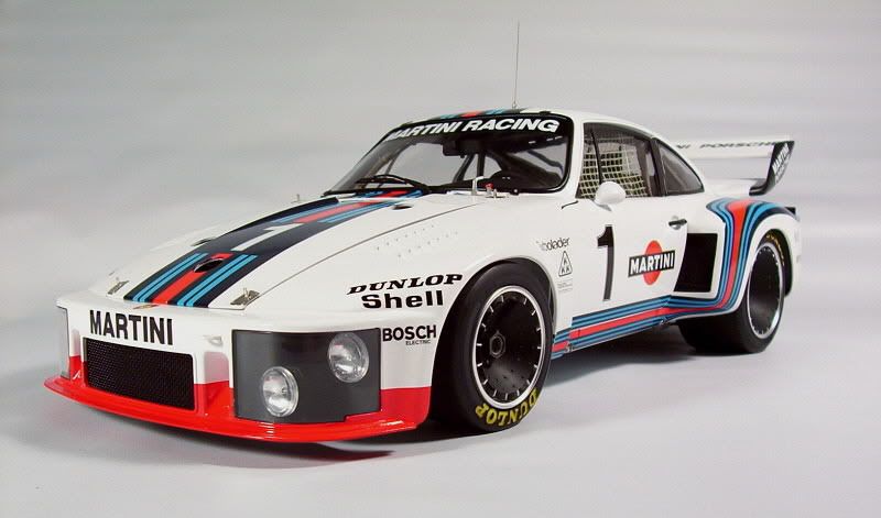

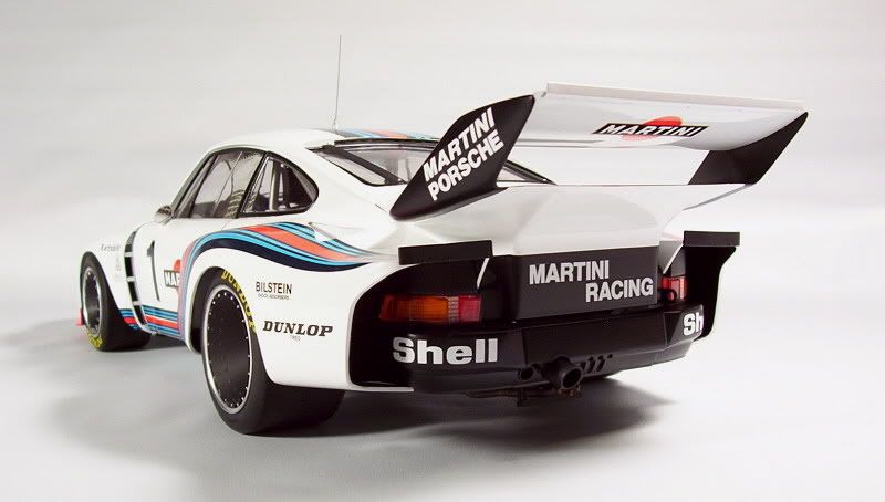

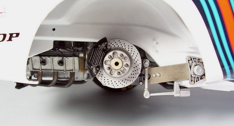

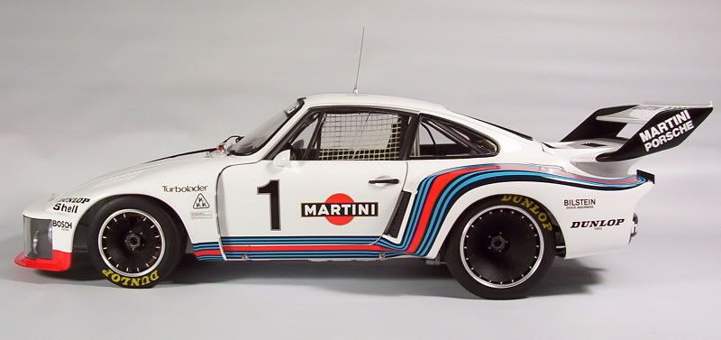

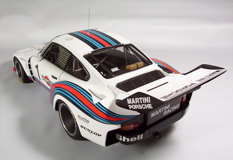

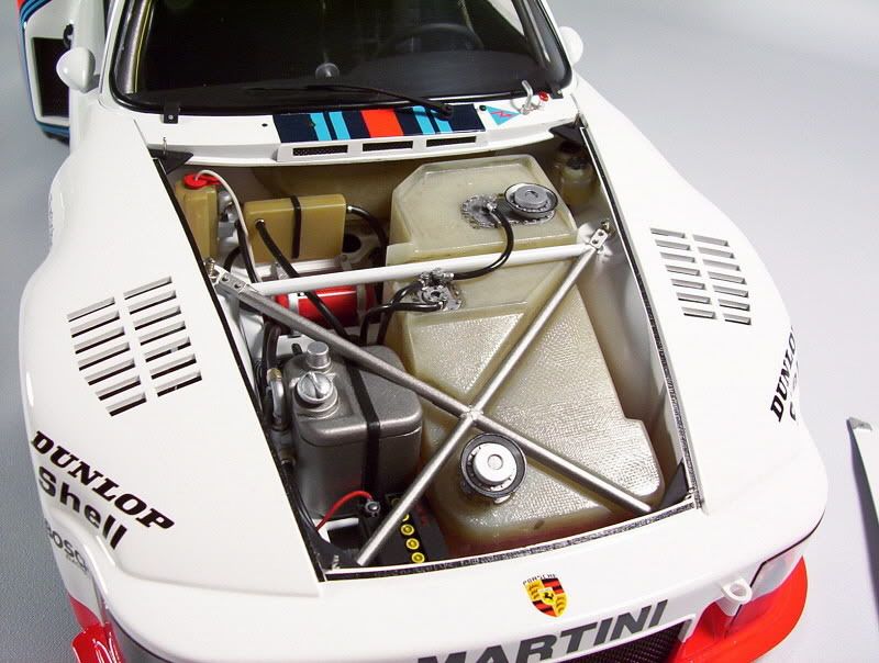

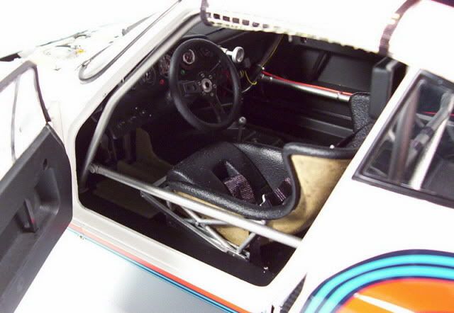

I completed this about 8 months ago (after working on it off and on for a year :roll: ) and I'm finally getting around to taking some pictures of it. Taking pictures of a 12th scale model really makes me realize how much I need a better camera.
Thanks to Gregg and Jairus a picture of this car ended up in the Contest Edition of Model Cars Magazine.

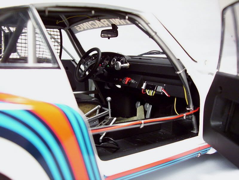

My intentions with this model were:1) To build a model now that I tried to build years ago and failed miserably at, and 2) To take what Tamiya gives us and try to do the best I could with it with minimal aftermarket items.

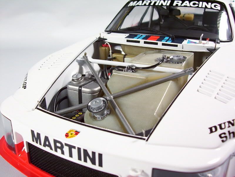

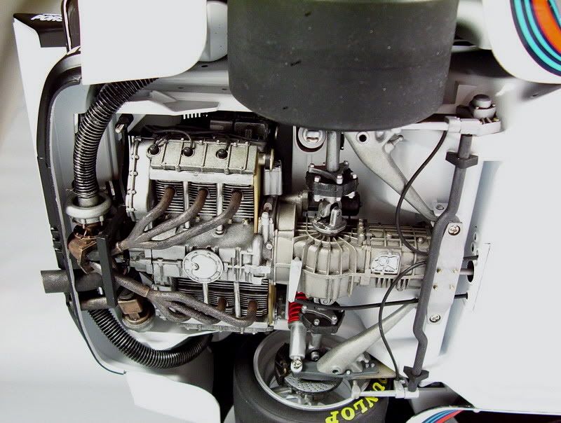

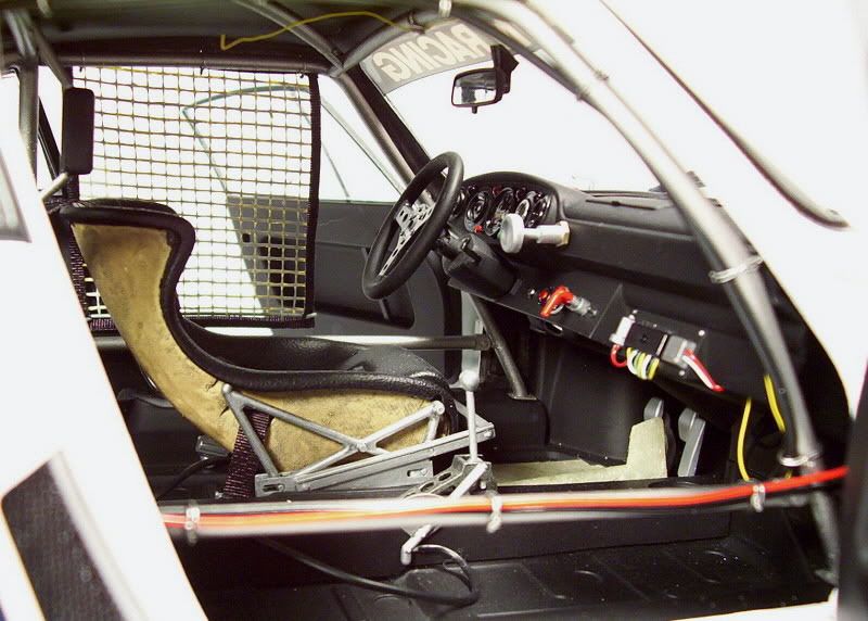

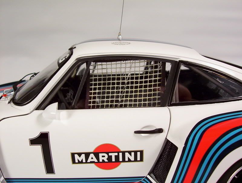

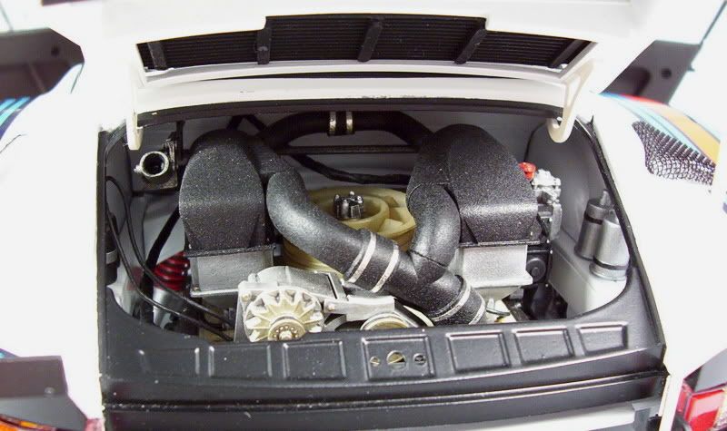

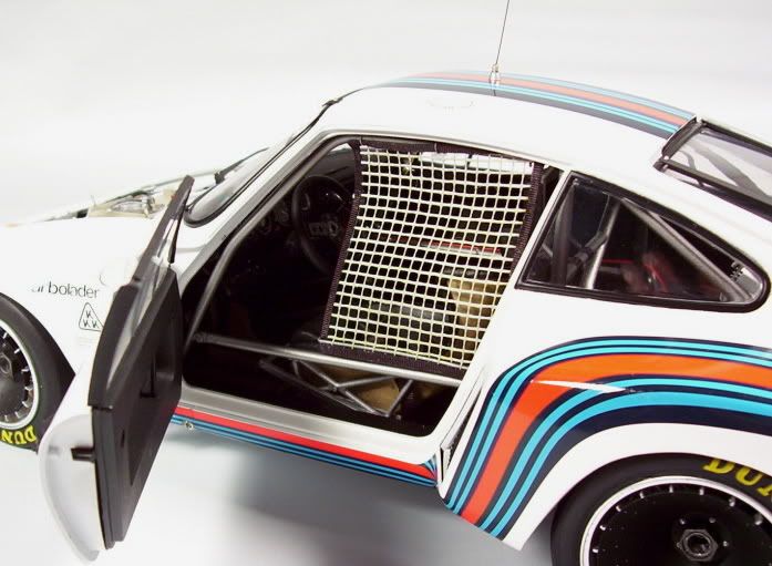

However, I did add some extra wiring and hoses, I did modify some of the kit parts and I used a lot of dry brushing, washes and texturing of plastic parts and I even made a few parts like the window net and rear window braces, I even made working hood pin latches with a pin and overlapping ring but they are a pain in the A** to put on and take off so they aren't shown in these pictures. I painted with colors/finishes that I thought looked more realistic than the recommended Tamiya paint colors referred to in the instructions. My reference, for the most part, was SMS Photo CD of the 935 along with what I could find on the internet.
It's not the most detailed model ever built of this car and there are some things I would do differently if I ever built it again but I must admit, that overall, I'm pretty happy with this build.
Thanks for looking...

Stunning. You have accomplished your goal of the best you can get out of this kit, without too much aftermarket stuff. One of the cleanest builds, I've seen. Detailing & realism at it's best. My hat is off, to you, sir.
I too, would like to know, how you made the bare fiberglass pieces, look like fiberglass. Colors, technique, etc.

Wow.... thanks Guys. This was a long time ago.
Anyway, the fiberglass look was achieved by place a small weave clothe, sort of like a wedding veil material on the plastic part then basically brush painting liquid cement over the material, letting it soak through the material, softening the plastic and then pressing the material into the plastic. once the plastic hardens again as the cement dries you'll end up with this texture. It can also be done with those small clothes used to clean eye glasses for a more random texture.
There is a tutorial on the internet somewhere that I made years ago with photos and descriptions at each step. I'll see if I can locate it and post it here.
What color did you paint the parts, after you did the texture?
