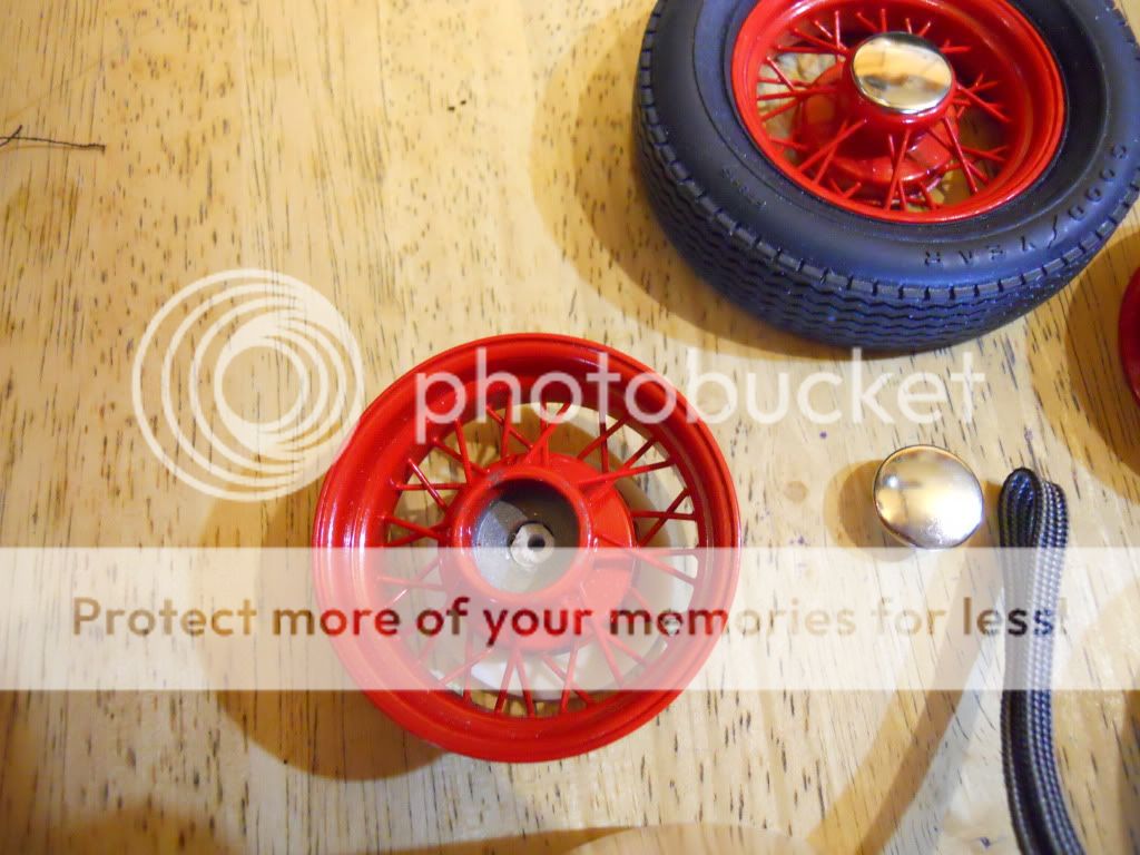

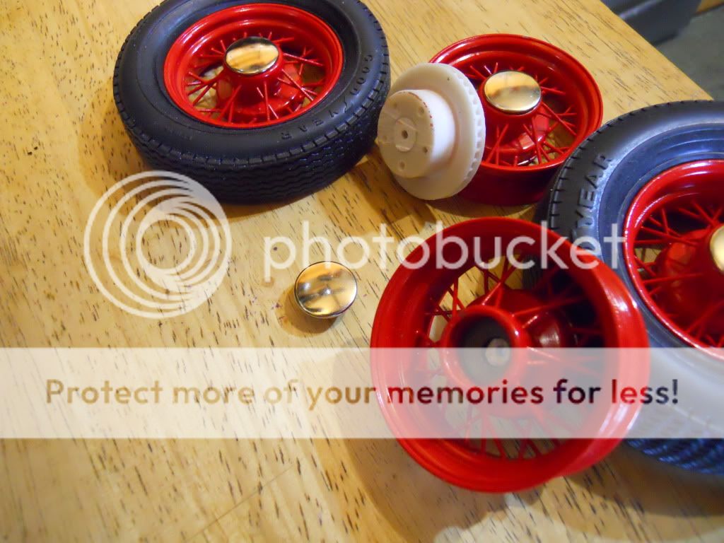

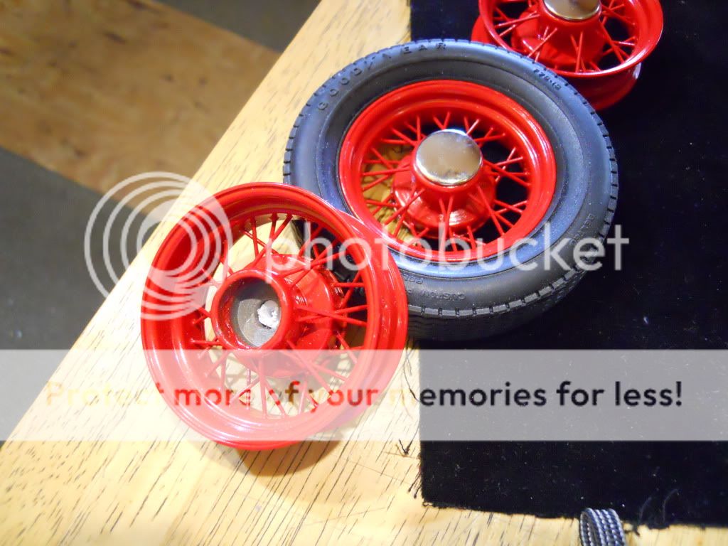

Well let's get this show on the road.......the pics don't do these wheels justice......they were fabricated and laced by Chris Garcia.
The disc brake rotor is a TDR item. Rick G. had these wheels custom made by Chris for a project he had been working on....they are gorgeous.
I'll be stripping the red paint and more than likely faux anodizing them, adding a valve stem, some big & little white sidewall tires and use them on Wildwood.

Those wheels look beautiful. Very realistic. This will be a build to follow for sure.

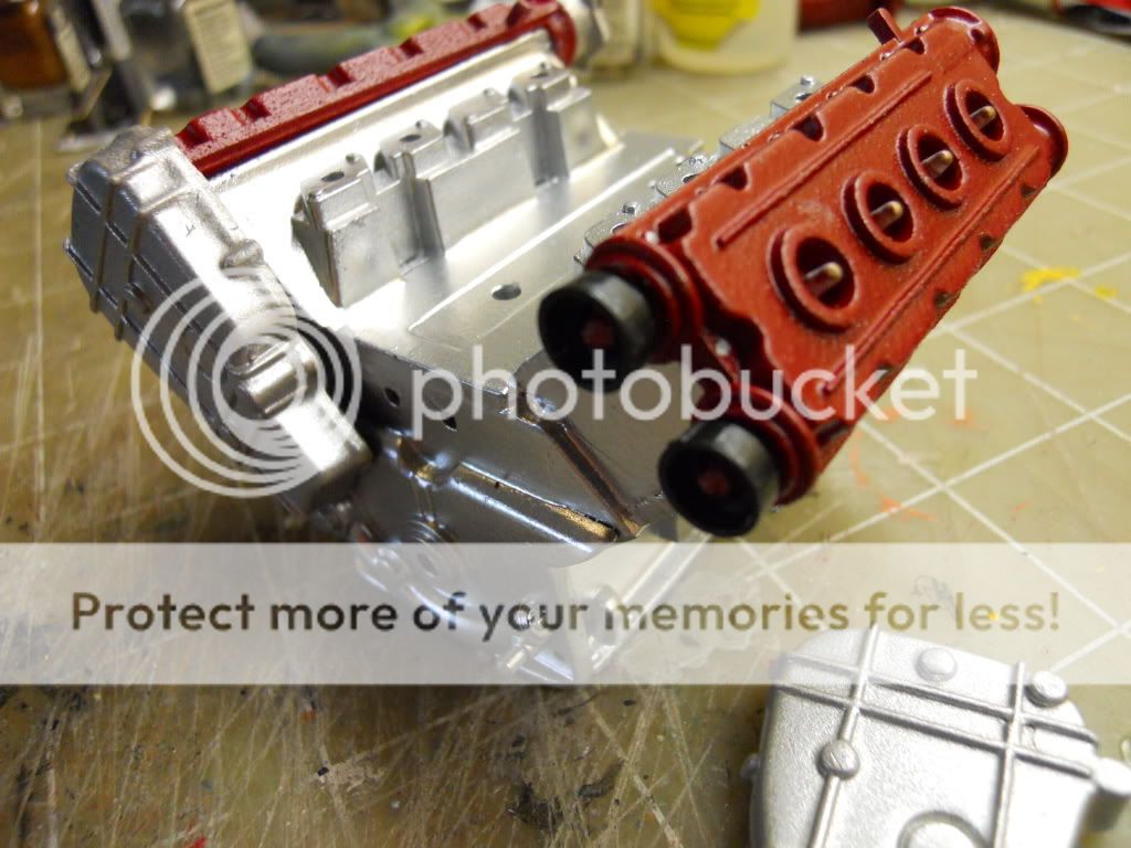

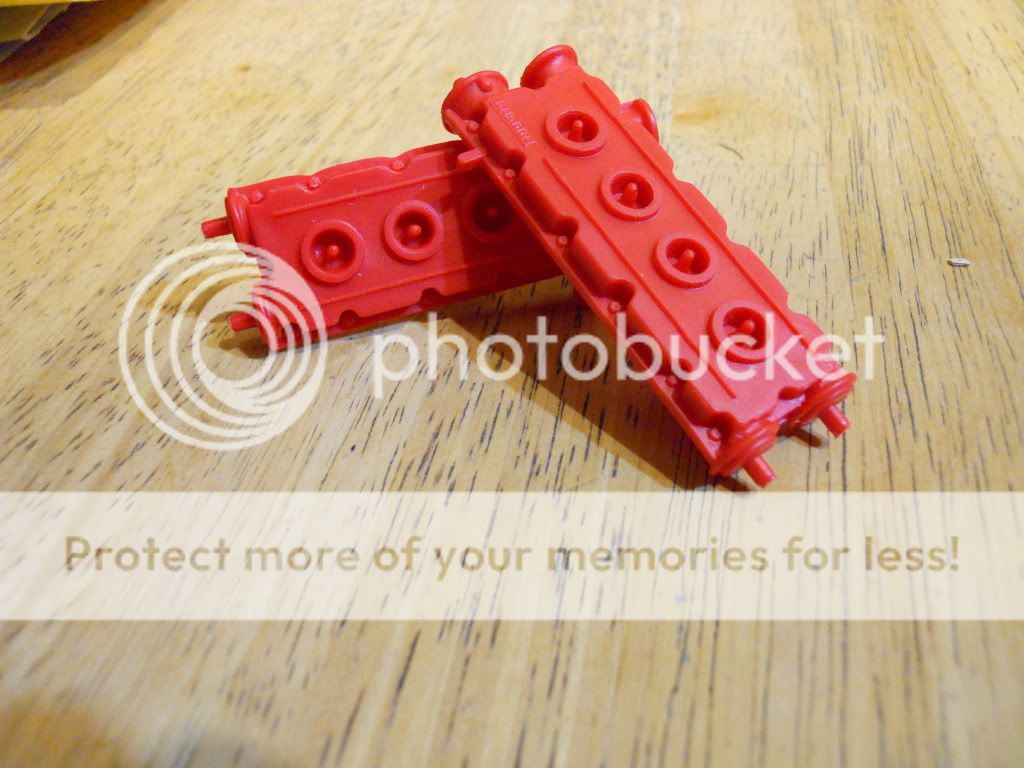

Here's a shot what Pocher figures Rick & I want for cam covers........baby butt smooth and reeking of plastic toy car.
Lets see if I can can give 'em a little personality being this is a custom build.

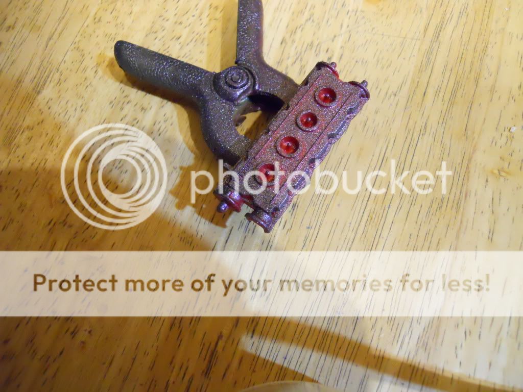

First order of biz is to treat them to a taste of texture (don't want a polished slick look) so I gave them a light dusting with this stuff.
Edited by GrandpaMcGurk

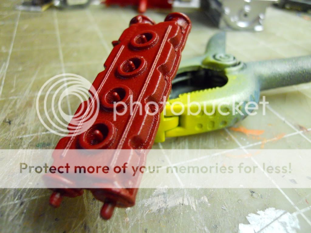

Now for some color....NO WAY...did I want to open the hood of this Willys Woody to be hit in the face with those fire truck Ferrari red cam covers......looked through my Pantone color charts and came to the conclusion that I would have to mix something up that would at least to some degree reflect what the final color (hint) of the fenders and hood would be. These pics are really large and the covers are no where near as gritty as they appear, actually to the naked eye ball the have a very subtle texture.
Being I custom mixed the paint, I figured I'd get to name it...it'll be called "Wildwood Farms Burgundy Wine" Ha, Ha!

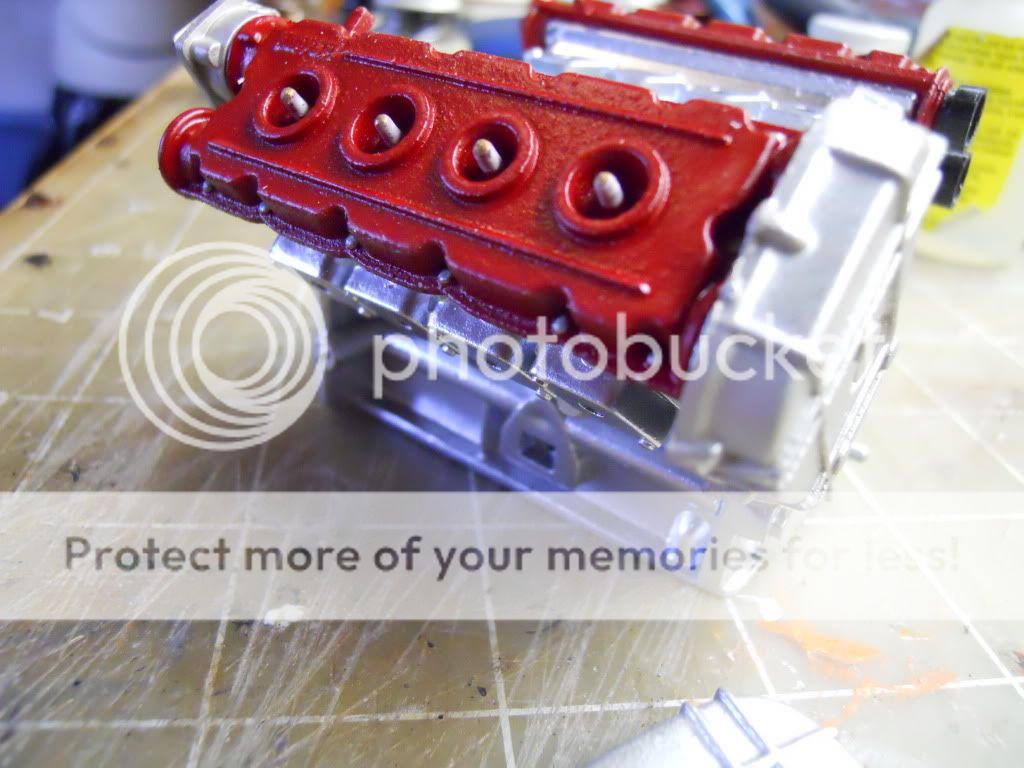

Added the cover bolts, valve cover to belt cover seals, spark plugs... even though they won't show under the boots, started detailing and did a quick eye ball mock-up......may not show up in the pics but the cam belt covers are a different shade of aluminum than the block...just for giggles.
Pocher for some reason didn't bother to put the bolts in either end of the cam covers so I added those as well.

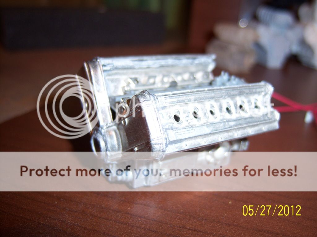

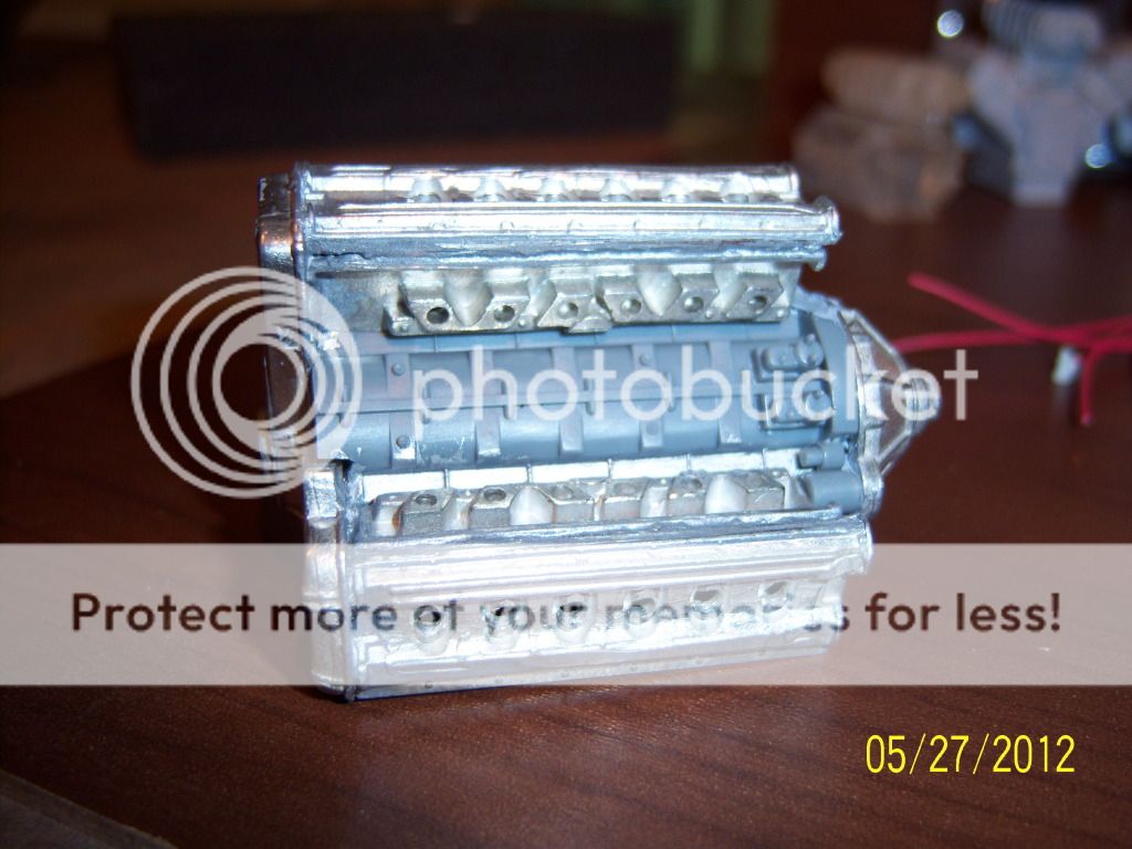

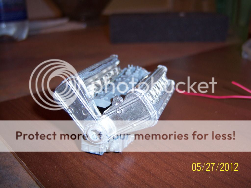

your work is fantastic,
I really love the model using a Ferrari engine
I started to make a V12 block with a 1/16 scale Testarossa flat 12 maybe you want to see what it can look like... I got a lot of work to do on the bloc itself but it gives a good idea of what it will look .
Edited by midengineaddict
