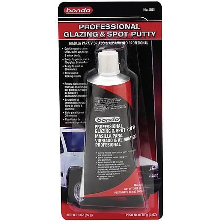

I use this stuff. It's a 2-part catalyzed system, it comes in a reasonably-sized container (not a "lifetime supply" sized can), and it's fairly cheap ($7-8).
Make sure you get the "professional" stuff. The regular 1-part putty comes in a very similar looking tube.
Thats what I have started using, I like it as well, now I am not sure if I got the same one, mine has the stage 3 on it
Share this post
Link to post
I use this stuff.
Is that just the regular Bondo in a smaller container/tube?
More or less, yes. It does use the same hardener, but the putty itself is a finer consistancy than regular Bondo in the can. Spreads very nicely.
