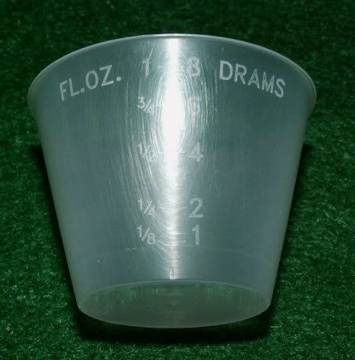

Use these.
“Paint Mix Medical Cups”
I've posted about the soft plastic film cans I use for mixing my paints.
Remember, your container has to be soft polypropylene plastic and not styrene, otherwise solvent paints will eat right through the container.
I've picked the film cans up from WalMarts over the years by the thousands and have a huge backstock.
But, WalMarts are phasing out their 35mm Photo Booths and they're going the way of BlackLight Poster Shops.
So goes the demise of easily available empty film cans.
Here's a cheap and even better substitute.
Clear, graduated Medicine Cups.
The one ounce cups are marked on four sides with different
graduations of measurements.
Capacity is the same as Film Cans but the clearly marked measurements make for perfect mixing.
Look in your Yellow Pages under Medical Supply stores.
The cups are $4 for 100.
The 2 Dram level is perfect for AirBrushes with 1/4oz. paint cups.
This amount will shoot a Colorcoat or Clearcoat for most HotWheels.
