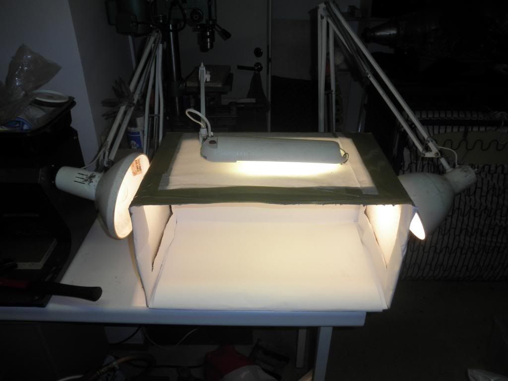

After cutting, you should end up to something like this. Mine is not that bad looking in live, picture makes it look rougher than it is.
The next step might be the hardest thing. Cover the sides of that paint booth with white paper, it must be correct sized. Then find correct size poster, and that will be your "Floor" and the back wall. It needs to be one piece, of course, otherwise there will be disturbing seams on it.
Then find some transparent paper, and tape the holes "closed".

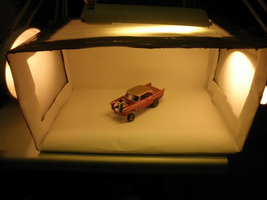

Here is the finished Photo Booth in action! Those lights are someones that I found from the Garage. Now you'll have one light on the top, and two on the sides. There will be no too noticeable shadows or anything. Models look quite good in here, and it's easier to camera to focus on the object, when there's no unnecessary stuff in the back.

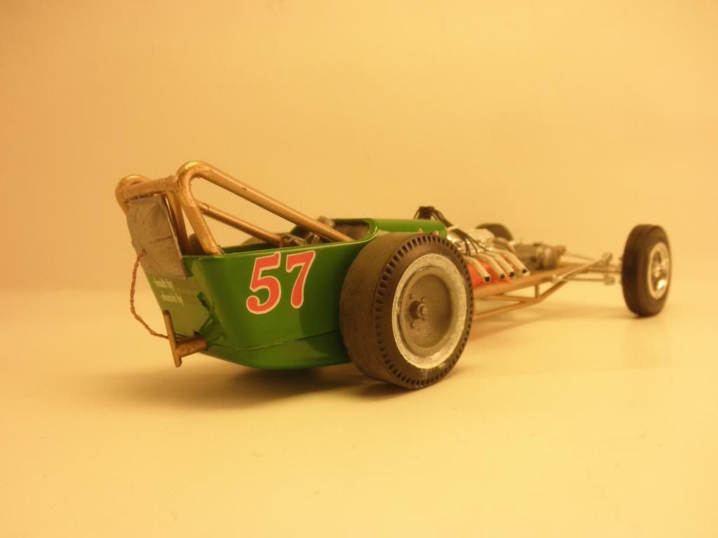

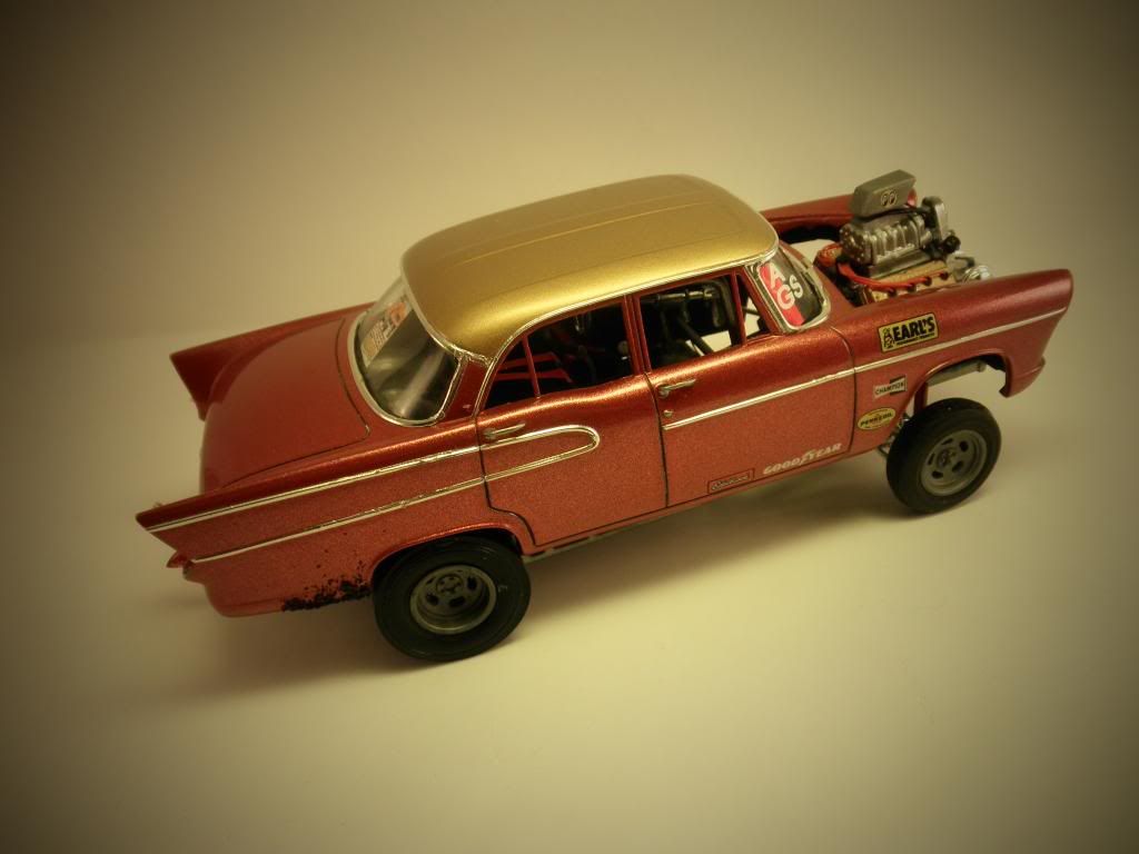

Jacen: Yep, I've used that method for a long time too, but I've noticed that my Models look much worse in the pictures, as they are in real life. Maybe it's because of my camera, but that booth makes life much easier. :lol: Now I can take pictures with same settings every time, without any adjusting or fear that pictures look bad.
