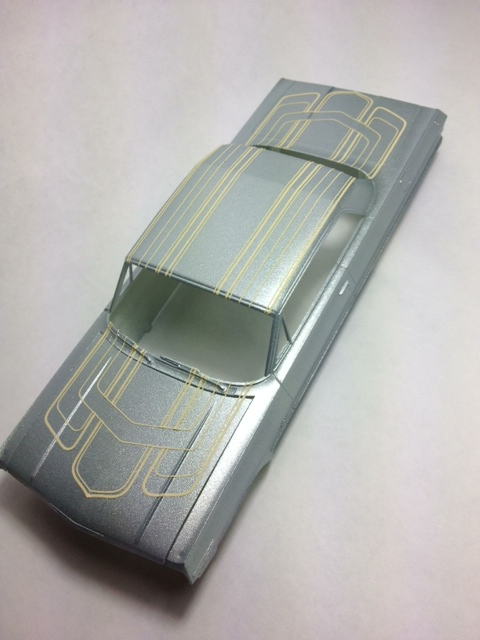

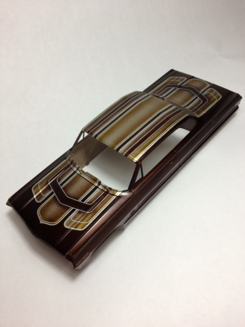

Here are a couple more kandy pattern jobs that I have been messing with. First is a AMT Prestige 63 Impala. This car was a quick job. About 24 hours from bare plastic to paint done, ready for foil and clear. It is kandy HOK Root Beer brown.

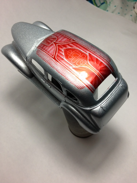

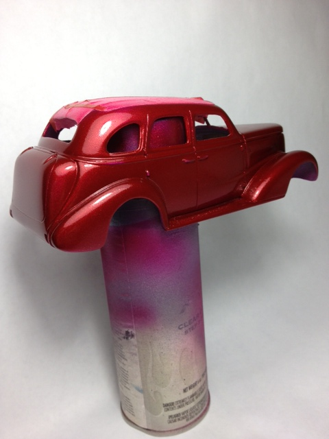

The next one is a 37 Chevy Master Deluxe resin body. It is all HOK kandy apple red with red nail polish for the body color.

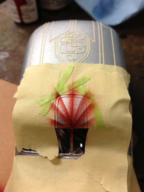

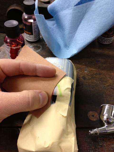

Chris, that is some spectacular work! Let me pick your brain a bit, how do you get the masking tape stripes so fine? I've always wanted to try one of these paint jobs, but just haven't figured out how you guys get the tape so thin, or how you don't get any paint bleed-through on such fine lines.
Link to comment
Take 2 blades and tape them together. The closer then tips of the blades are, the thinner the lines are. Then cut strips from a piece of 2 inch wide masking tape. I have a "how to" thread on Layitlow.com. Look in the model section and its on the first page.
