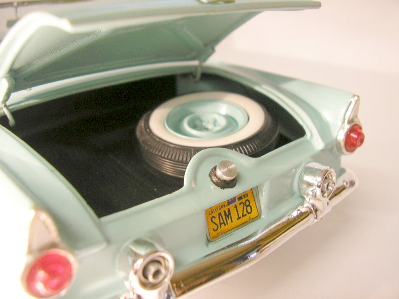

I dislike the connie kits on the '56's as well, so I turned mine into a '55. I built this one back in '99. One suggestion-----I strongly recommend some kind of barrier on the plastic unless your intention is to paint it red. That red plastic is NASTY and is notorious for bleeding through. I used Future Floor Wax to barrier the plastic before I laid one coat of paint on it. No bleed through whatsoever! ;)
One faux pas was the color of the dash.....should be a darker green/turquoise, but I was using pics from an actual car at the time and that's the color its dash was.

Nice job on your Bird, sweet ride! I have never used future, it would seem that using a wax base would cause the paint to peel or blister. Your saying it won't cause a problem? Can't I just use some of my Tamiya primer to coat it and wouldn't that stop it from bleeding also?
Yes, I do remember that the dash was a couple of shades darker with this color, but I think yours is perfect anyway. Great car!
As for the Conti kit, I used to love those when I was a kid, they were also on numerous other cars of the time. They seemed to have made the cars much more "sleek"?

Future Floor Wax is not a "wax" in the strictest sense. It's actually an acrylic clear coating that's used to shine up floors. It's now called "Pledge with Future Shine", and can be found at most grocery stores or at a Wal-Mart for instance. I airbrush mine on, and I keep the pressure about 12 PSI because it can be rather runny. To get the complete rundown on Future, click here as this site gives some really neat tips on Future Floor Wax.
As far as simply spraying Tamiya primer.........that's OK as far as it goes, but there are still solvents in their primer that may bring the red pigments to the fore-----especially if you want your T-Bird to be in lighter colors such as my Thunderbird Blue. One other alternative for using as a barrier coat is something called BIN Zinsser, which is excellent as a barrier for the newer softer plastics they're using these days.
Hope this all helps!
