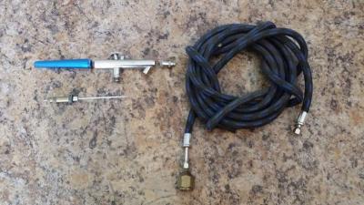

jacoballardtattoo Posted January 22, 2015 Share Posted January 22, 2015 I just found my old airbrush hiding in the tool box, I got it over 10 years ago but never was able to use it. I want to finally learn to use it for both pictures and models but have no clue where to start, so any advice would be great! To start in the pic is what I have now, if you can help me out with what I need from here and maybe telling what it is that I do have. Then thoughts on the cheapest way to start since I am just starting. Thank you. Quote Link to comment Share on other sites More sharing options...

chunkypeanutbutter Posted January 22, 2015 Share Posted January 22, 2015 Looks like a Badger. They were also sold by Snap-On, BluePoint, Matco, etc. Quote Link to comment Share on other sites More sharing options...
Mike_G Posted January 22, 2015 Share Posted January 22, 2015 That's a Badger 150. You're missing the color cup, otherwise it looks like it's all there. Quote Link to comment Share on other sites More sharing options...
chunkypeanutbutter Posted January 22, 2015 Share Posted January 22, 2015 It doesn't use a cup, does it? I have one and it uses bottles with a nozzle that attaches underneath. You'll need a regulator, air tank, and compressor. Don't waste your money on aircans, the replaceable ones. Much more economical to use a compressor. Quote Link to comment Share on other sites More sharing options...
Mike_G Posted January 22, 2015 Share Posted January 22, 2015 It doesn't use a cup, does it? I have one and it uses bottles with a nozzle that attaches underneath. Mine came with both- the cup is better suited to small jobs where you don't need a lot of paint, and it's a lot easier to clean. Quote Link to comment Share on other sites More sharing options...
chunkypeanutbutter Posted January 22, 2015 Share Posted January 22, 2015 Ah. The BluePoint ones have has two small bottles and a large bottle. Quote Link to comment Share on other sites More sharing options...
Mike_G Posted January 22, 2015 Share Posted January 22, 2015 Ah. The BluePoint ones have has two small bottles and a large bottle. Mine may have come with a large bottle too- I haven't used it since I got my Badger 100 Gravity-Feed. I also have an Iwata HP-C that I haven't used. Quote Link to comment Share on other sites More sharing options...
jacoballardtattoo Posted January 22, 2015 Share Posted January 22, 2015 (edited) This one had 2 cups different sizes and 3 bottles when I got it. I thought it was a badger but want sure, it does have sears stamped into it. It's a duel action. Is outa decent airbrush? Is it suitable for a beginner? I do have a compressor (I think it's a fifteen gallon) that I was using for auto painting (it's basically useless for anything else I have tried) I'm not sure if it would work for the airbrush? I have been looking on amazon fora cheap one that might work but don't know what I would need. I'm working with maybe 50$ tops right now. Edited January 22, 2015 by jacoballardtattoo Quote Link to comment Share on other sites More sharing options...

Mike_G Posted January 22, 2015 Share Posted January 22, 2015 This one had 2 cups different sizes and 3 bottles when I got it. I thought it was a badger but want sure, it does have sears stamped into it. It's a duel action. Is outa decent airbrush? Is it suitable for a beginner? I do have a compressor (I think it's a fifteen gallon) that I was using for auto painting (it's basically useless for anything else I have tried) I'm not sure if it would work for the airbrush? I have been looking on amazon fora cheap one that might work but don't know what I would need. I'm working with maybe 50$ tops right now. That airbrush and your compressor should work fine as long as you have a good pressure regulator and water trap on the compressor Quote Link to comment Share on other sites More sharing options...
jacoballardtattoo Posted January 22, 2015 Share Posted January 22, 2015 Cool thanks, looks like I need to find a regulator and water trap now. Can anyone give me an idea of aproximitly what pressures I should be working with? I'm sure it changes with different paints but hoping there isa starting point? Quote Link to comment Share on other sites More sharing options...
Mike_G Posted January 22, 2015 Share Posted January 22, 2015 Cool thanks, looks like I need to find a regulator and water trap now. Can anyone give me an idea of aproximitly what pressures I should be working with? I'm sure it changes with different paints but hoping there isa starting point? 10-40psi is a good usable range I spray at ~25psi mostly Quote Link to comment Share on other sites More sharing options...
