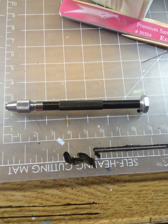

Here in my Tamiya:
949509FF-CF28-4DA9-87DE-01B4FBAF68B0-104
Share this post
Link to post
Here in my Tamiya:
Erik's suggestion is good and I have two of these. I seem to always have several different size holes to drill at the same time so I have two of them.
If you are only going to have one then buy this one. Also a Tamiya tool. http://www.tamiyausa.com/product/item.php?product-id=74050
I am suggesting this for a hidden reason. None of the information that I can find talks to this but the thing has four collets! I had mine for years before I discovered this. It comes with one double ended collet mounted and if you unscrew the swivel end there is a second double ended collet inside. With four different sized collets it will hold anything from and 80 up to a 1/8". Very versatile.
