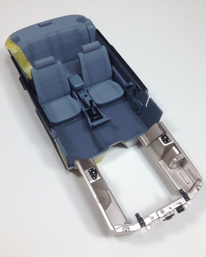

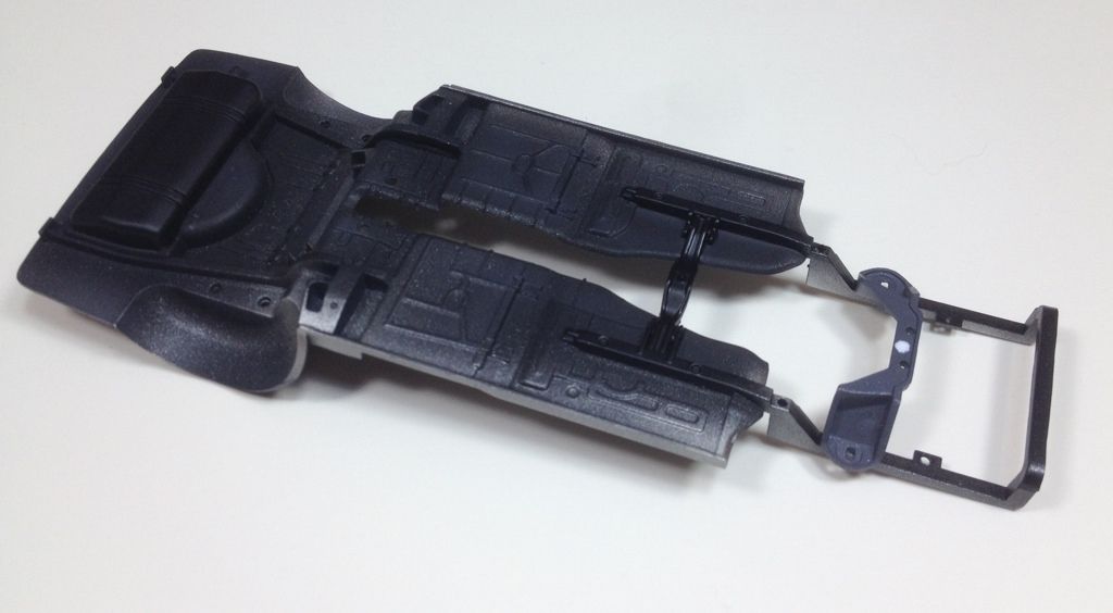

Progress for the weekend:
Interior tub and engine bay.

Chassis:
CEAB43E4-200A-4CE4-BDBE-8DF84E93273C-212
Both still need more detail painting, but major colors are in place

Fred, Ford was funny about the rear ends on these cars. They were left unpainted, but the brake backing plates were painted Black and the sway bar was Black. Upper and lower control arms were a natural steel (but looked to have some aluminuization), along with the Axle tubes. Carrier case was natural Iron. That pig-heavy weight was natural Iron, and the quad shocks Black.

The front facia on that body looks super crisp! What technique did you use to give the interior its correct appearance? The seats, carpet, and shifter boot just look incredibly realistic. Nice work, so far.
Seats are Tamiya light gray airbrushed. I prehaded the seat than applied the gray. The vinyl sides are just one coat of future - it adds a nice semi gloss look. The carpet is the Tamiya light gray with black added again airbrushed. I kept the AB a little farther away than normal to get more texture in the paint. Shifter is Tamiya semigloss spray paint - my favorite semi black.

How's it coming, Erik?
BTW, You and Bradley indicated the chassis should be primer gray with body color overspray along the rockers, correct? However, I have a couple of shots of an LX on a lift and the chassis is red oxide primer. What can you confirm?

All 4 of my current Fox Chassis' have Gray primer with a heavy dose of body color overspray. The 88 Coupe I started into the FOX world with was the same way, and the 85 Coupe I just picked up is also Gray with body colored overspray.
