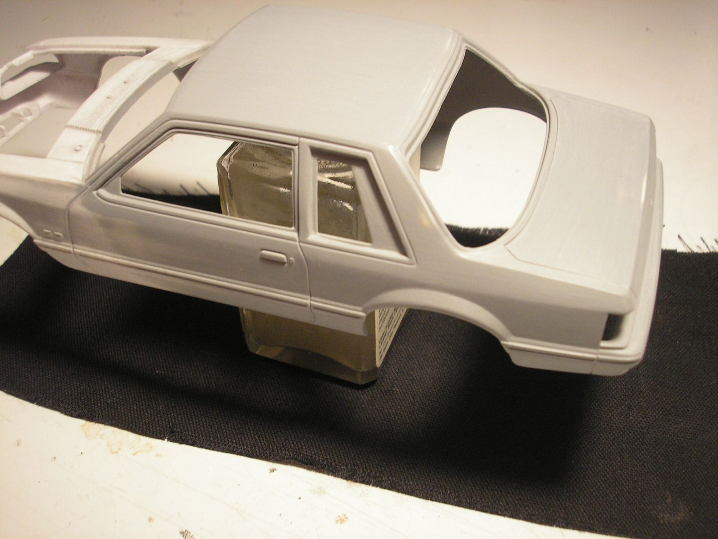

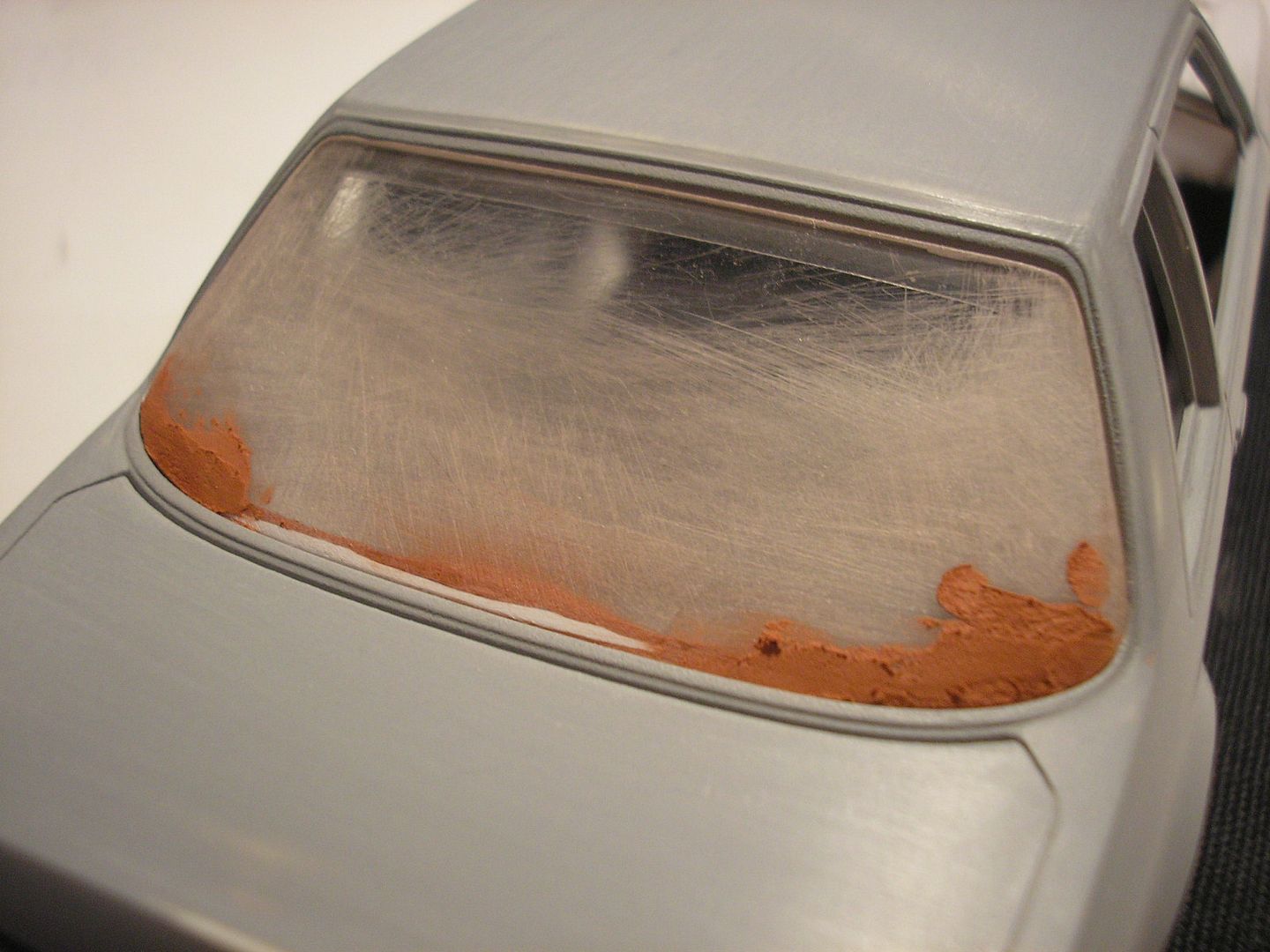

Maindrian Pace Posted July 29, 2013 Author Share Posted July 29, 2013 (edited) Perfect! Im messing around with the same kit but im not going to go as far with the body. I applaud you for taking on this many corrections and look forward to the finished product. Whats the plan engine wise? Like my driver, the engine will be a bone stock 5.0 with automatic and air. After a few more rounds of micro-sanding and priming, I'm calling the body work done. The final step is to get the window glass in order. I'm modifying the stock glass to be used as vacuform masters, this involves lengthening them with plastruct and using super glue/accelerator and glazing putty as filler. I've never done this before, so hopefully I'm on the right track. -MJS Edited November 3, 2013 by Maindrian Pace Quote Link to comment Share on other sites More sharing options...
Danno Posted July 29, 2013 Share Posted July 29, 2013 I'm modifying the stock glass to be used as vacuform masters, this involves lengthening them with plastruct and using super glue/accelerator and glazing putty as filler. I've never done this before, so hopefully I'm on the right track. -MJS Looks like you are (on the right track) to me, Mike! Great work. {PS - It'd be nice to get this body of yours cast.} Quote Link to comment Share on other sites More sharing options...

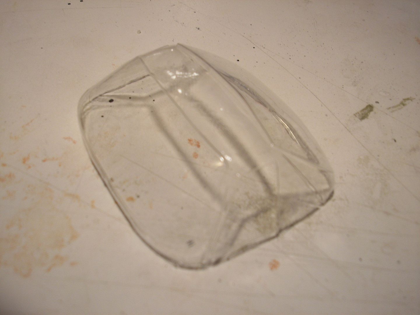

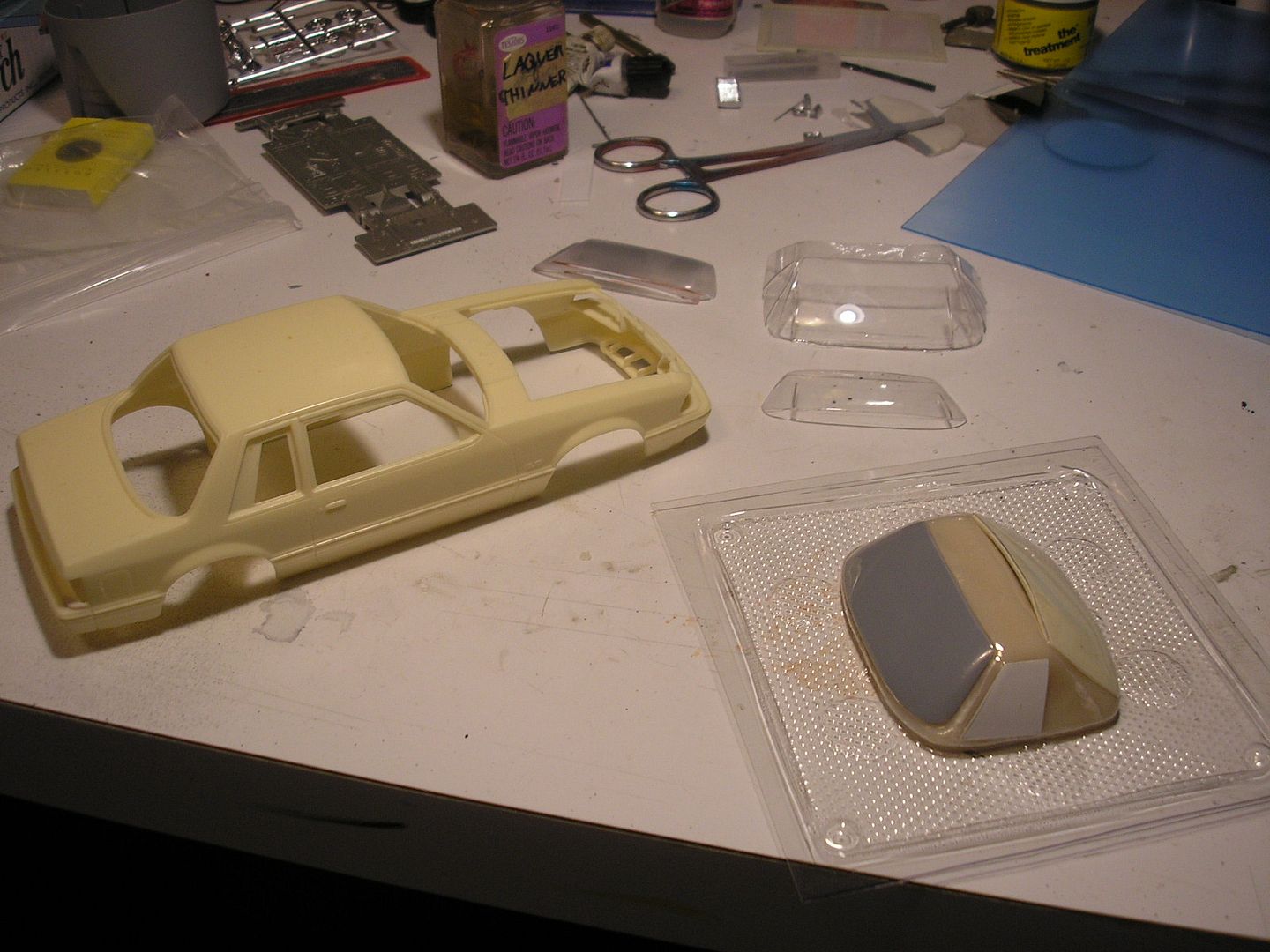

Maindrian Pace Posted September 16, 2013 Author Share Posted September 16, 2013 (edited) I got the glass master made up for the vacuforming. With no better idea, it's made of Sculpy oven bake modeling clay; I'm sure there is better stuff to use, but this will do for now. Pull one was not very successful, I waited too long with the sheet under the heating element, so it drooped down too far, and I got runs in the windows. Pull two was much better, I didn't let the sheet droop as far, and I got no runs. You can see the first windows behind it. The first usable window unit: We're making good headway on this. -MJS Edited November 3, 2013 by Maindrian Pace Quote Link to comment Share on other sites More sharing options...
Abell82 Posted September 16, 2013 Share Posted September 16, 2013 Have you compared a convertible front windshield to the new body, after you raised the roof ? It should be a pretty close fit, with minor trimming on each side. Quote Link to comment Share on other sites More sharing options...

Maindrian Pace Posted September 16, 2013 Author Share Posted September 16, 2013 Have you compared a convertible front windshield to the new body, after you raised the roof ? It should be a pretty close fit, with minor trimming on each side. I have tried the Monogram convertible windshield. Height isn't a problem, but the glass is flatter with not enough curve. And we all know what happens when you try to bend clear styrene. Great job, Mike. I know you are having fun. I started the hood mold over on our forum. I liked that it did not have the usual rough areas that would normally represent under hood insulation. Greg, it is fun to use that machine. But it also brings me back to my less than fun dental lab days. However, I suppose that without working at the lab, I wouldn't have known about the machine, so it all fits together somehow. -MJS Quote Link to comment Share on other sites More sharing options...
Abell82 Posted September 16, 2013 Share Posted September 16, 2013 Yes,but it should be able to provide a viable "buck" if nothing else. Quote Link to comment Share on other sites More sharing options...
