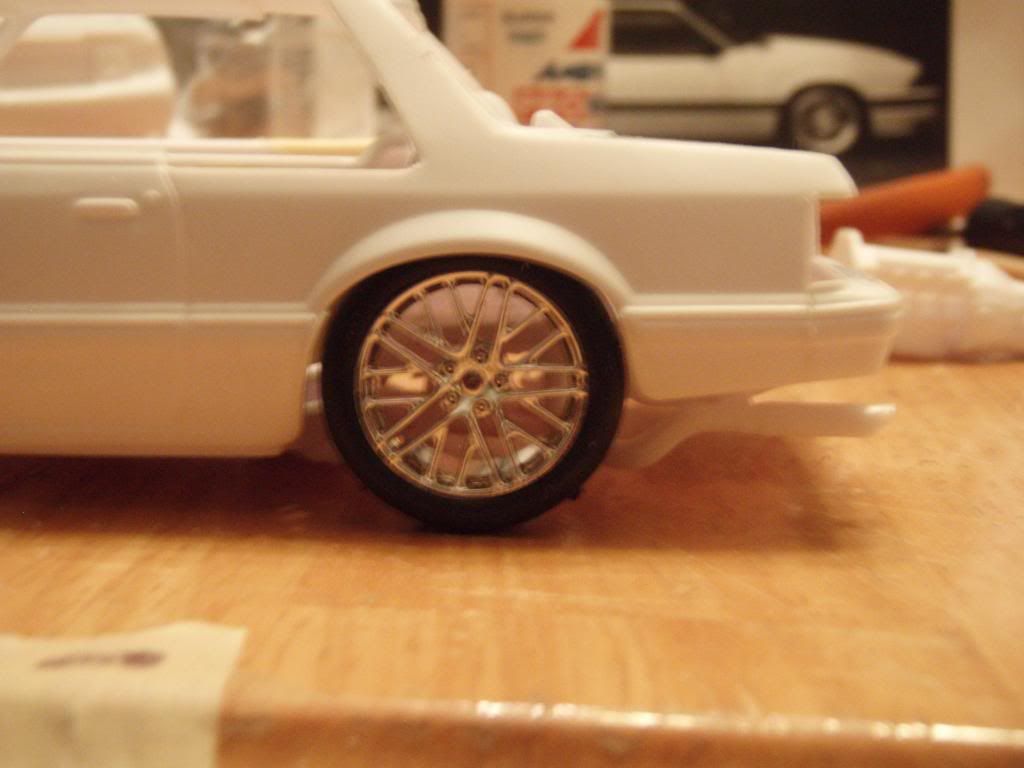

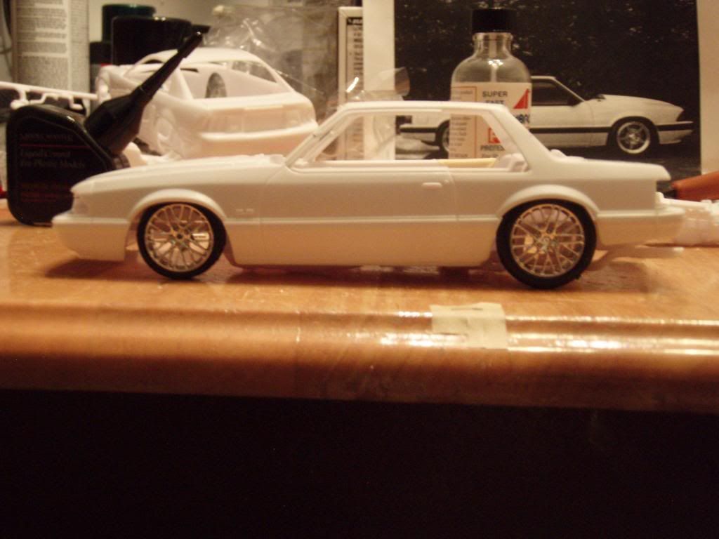

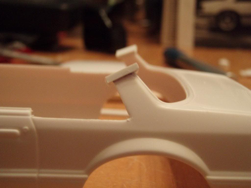

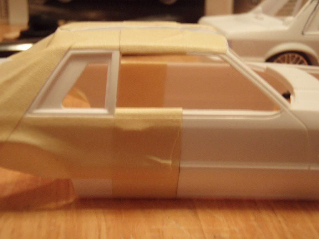

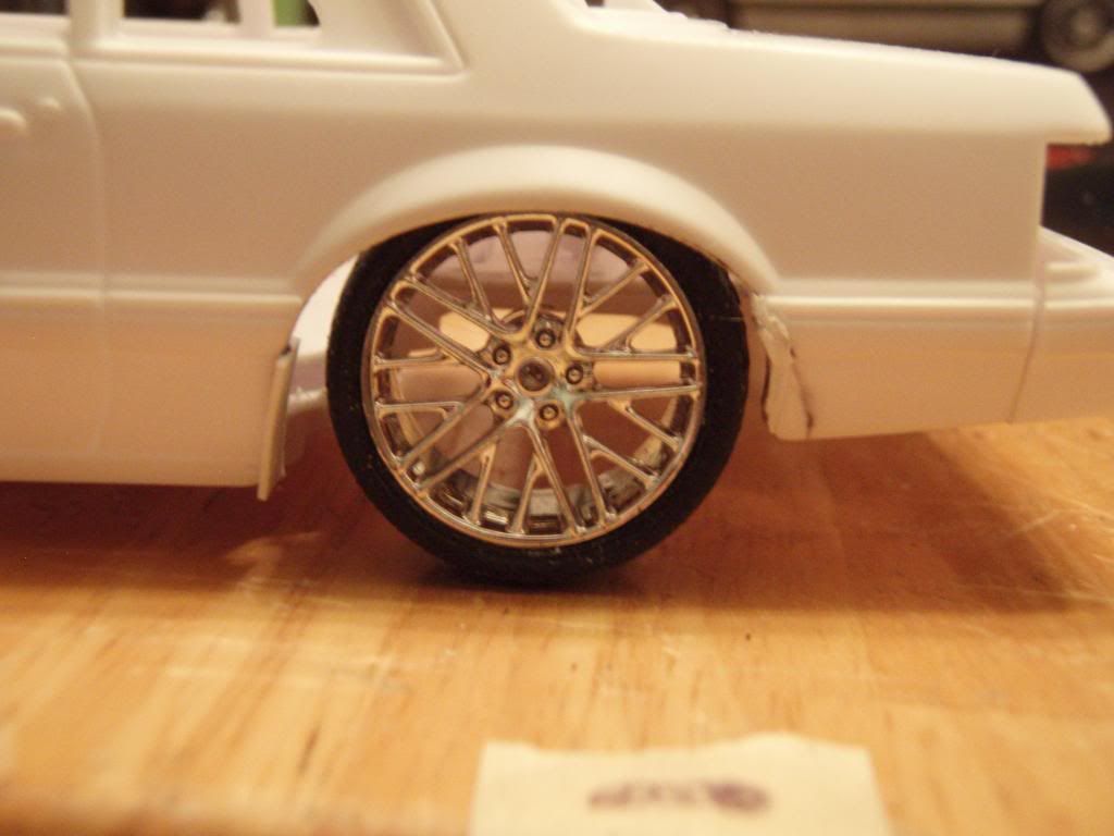

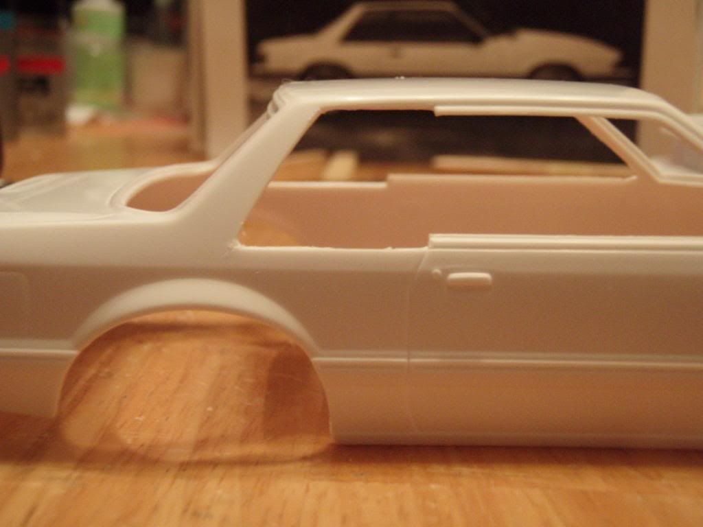

whale392 Posted June 16, 2013 Author Share Posted June 16, 2013 About time I get home and am able to show some of what I have done. I have 3 Coupes going right now, with a 4th cut into a Hatch. Work is not the best, nor is the photography. Took the roof off right above the window moldings (after removing the door window casings, to be glued back in when the major body work is done). Looks a bit rough right now, but it will be OK once all of the work is done to finish it up. [/url Adding the styrene blocks to the front and rear of the rear wheel well openings. Got a bit carried away and had to re-add/sand material there. This is the first body. Second body to follow. Quote Link to comment Share on other sites More sharing options...

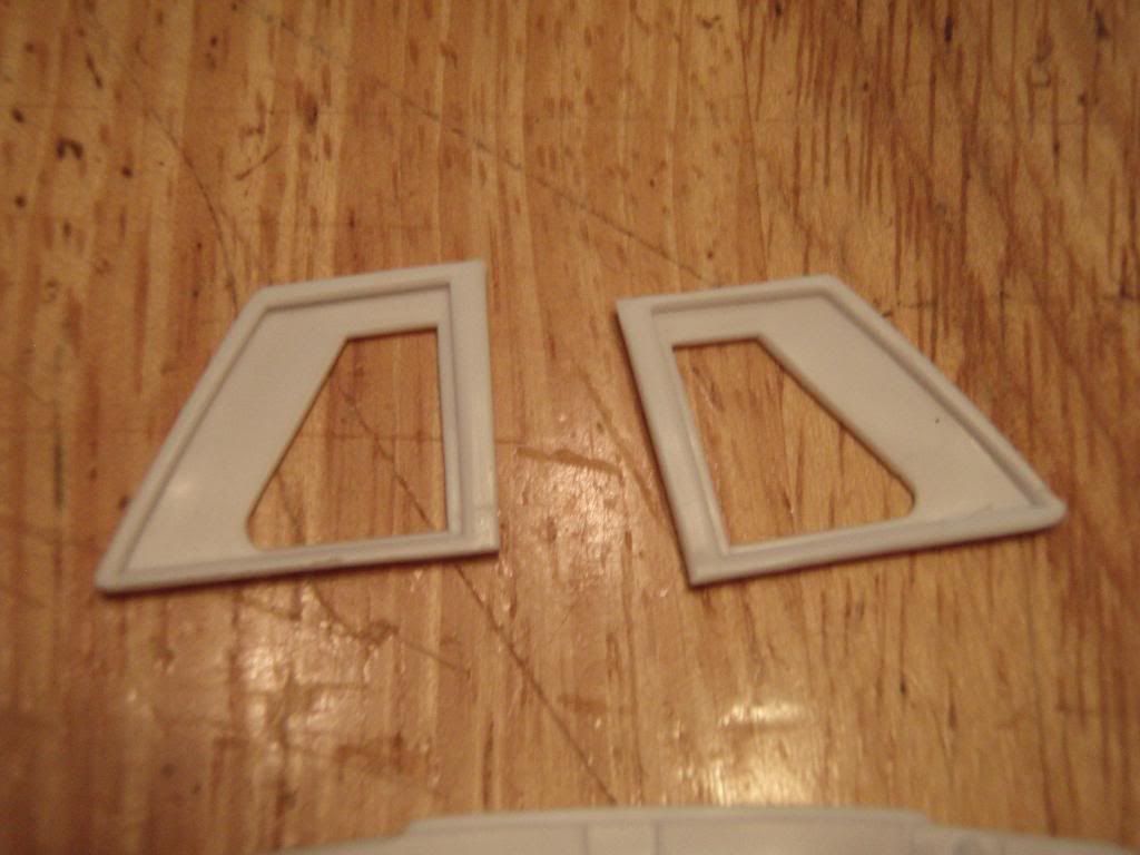

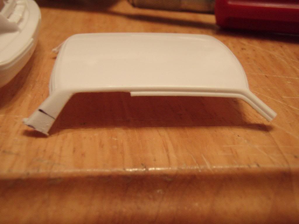

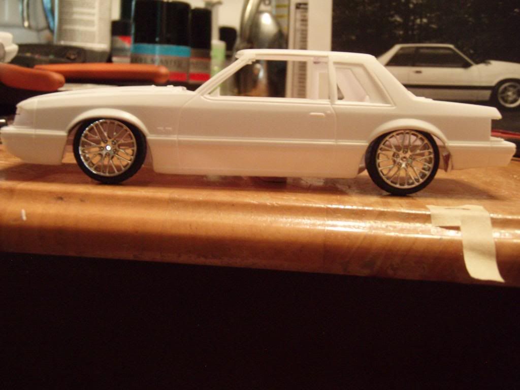

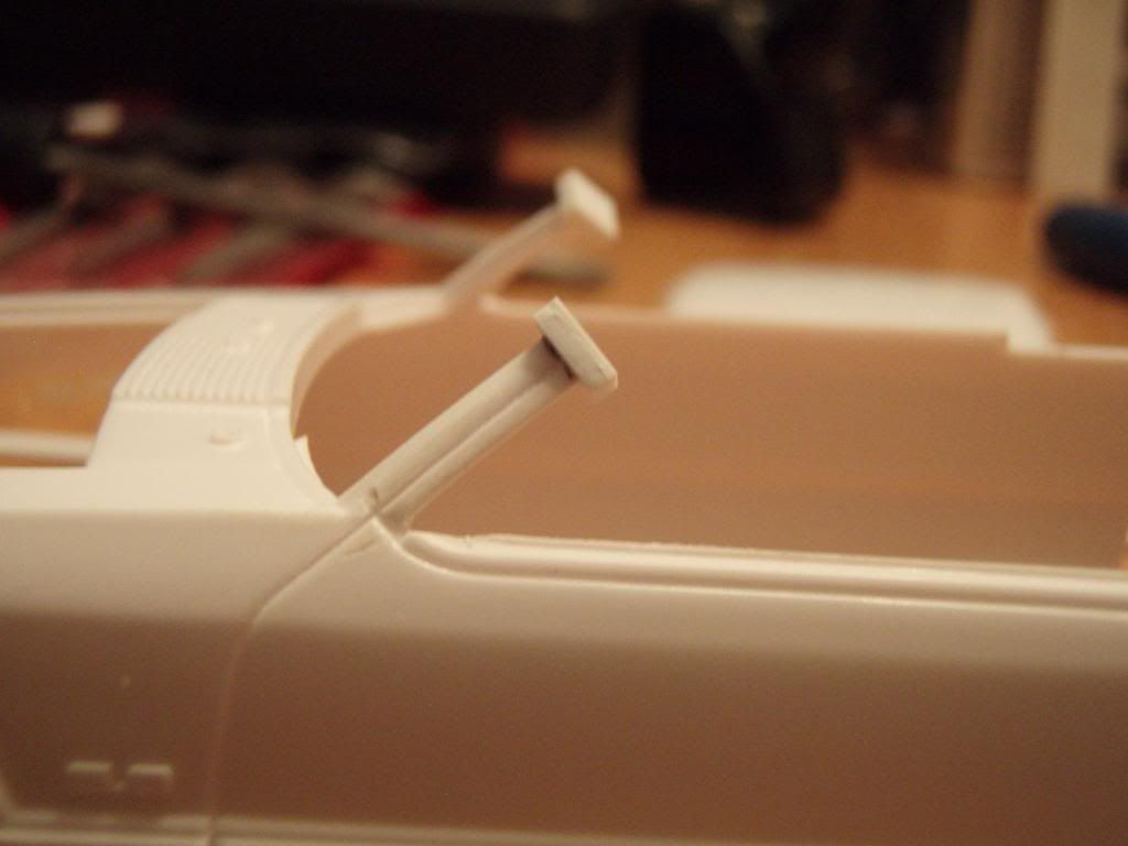

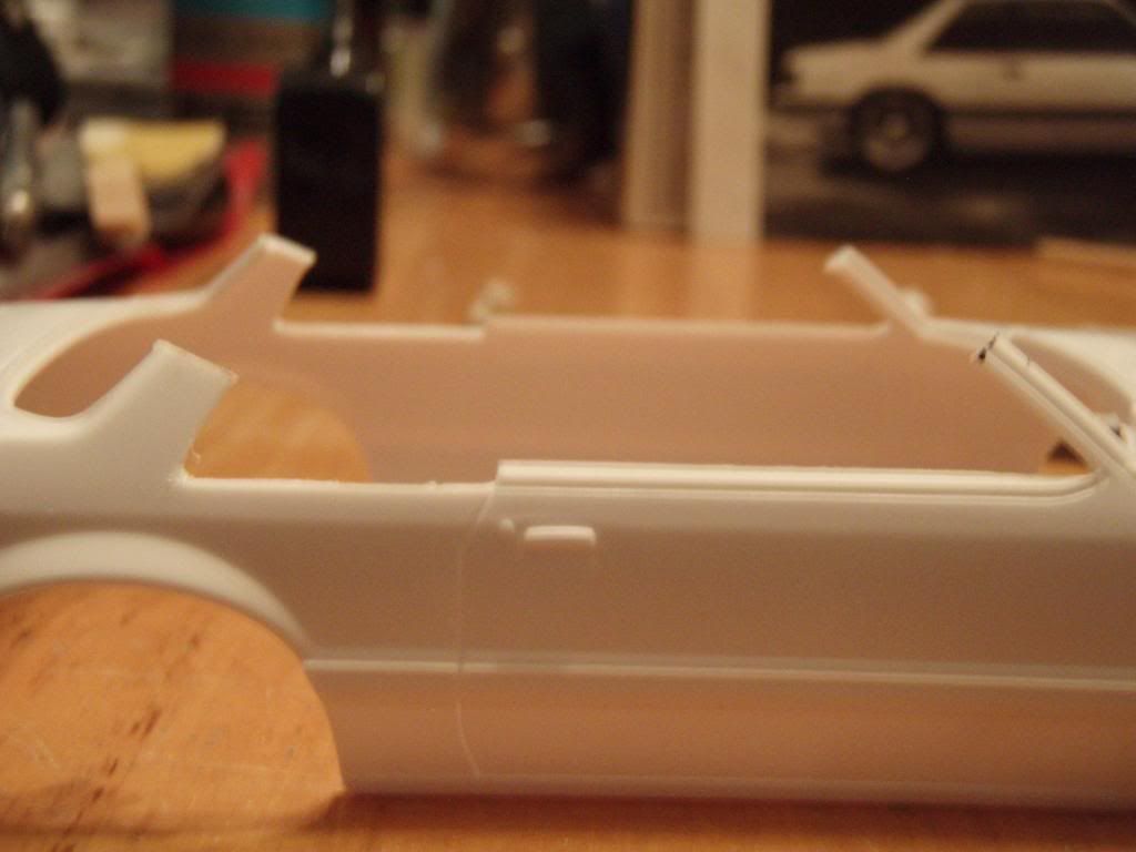

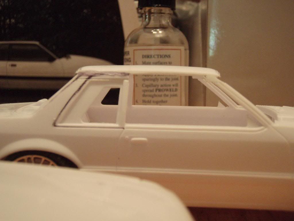

whale392 Posted June 16, 2013 Author Share Posted June 16, 2013 Ok, body #2. Removed the door window casings and the quarter windows. Cut the top, added .060" styrene to the legs, and glued the roof back on. I will be adding the needed .080" styrene to the quarter windows and door window casings and gluing them back in after the rest of the major body work is done. Even though my measurements say the roof length was dead-nuts on, I went ahead and shortened the roof skin just enough to get everything to line back up. I also took .080" styrene and glued/shaped it to the rear lip of the rear wheel well opening and used .404" at its front edge. The rear bumper has also been shortened about .020"-030". Quote Link to comment Share on other sites More sharing options...

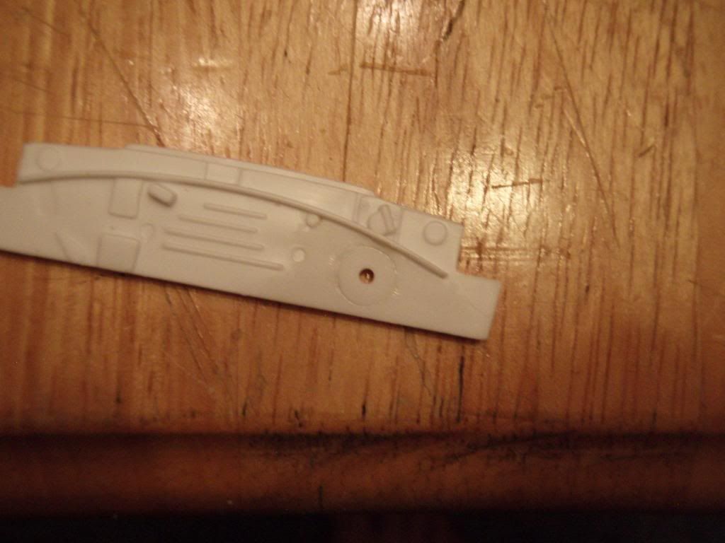

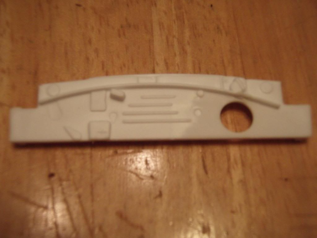

whale392 Posted June 16, 2013 Author Share Posted June 16, 2013 Cut the brake booster off and will be filling the hole. A 99 Cobra model will be giving up its Hydroboost brakes, drivetrain, and IRS/exhaust for this Coupe. With minimal angle change (not done here yet) the 99 Cobra exhaust fits nicely to the Coupe. There is a 99 Cobra IRS cradle sitting up there as well, behind the Corvette ZR1 wheels. The wheels will get a lip job and will be used on this build too. Quote Link to comment Share on other sites More sharing options...
