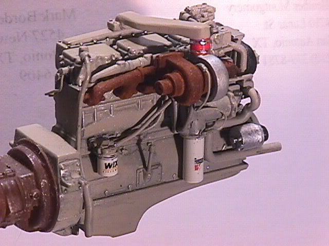

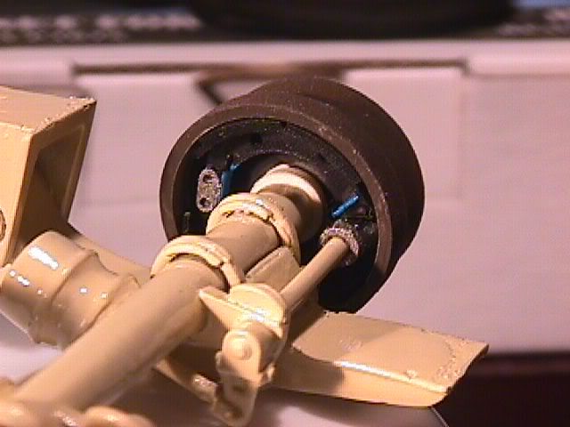

I think you might get more help if you change the title of the post to show your looking for ways to "rust" things. I use a product called Sophisticated Finishes Rust Antiquing Set. It's sold at Michaels Craft stores and I believe at Hobby Lobby as well. It's made by a company called Triangle Coatings. It's a two step process that actually rusts the plastic part. The first step is to paint the part with two coats of a special paint that comes in the kit that is loaded with super fine iron particles. Once this dries, you paint it with the second part which looks like Windex. This actually makes rust form. Here's some pics of it used on an exhaust manifold/turbo and a brake drum.Cummins2.jpg
