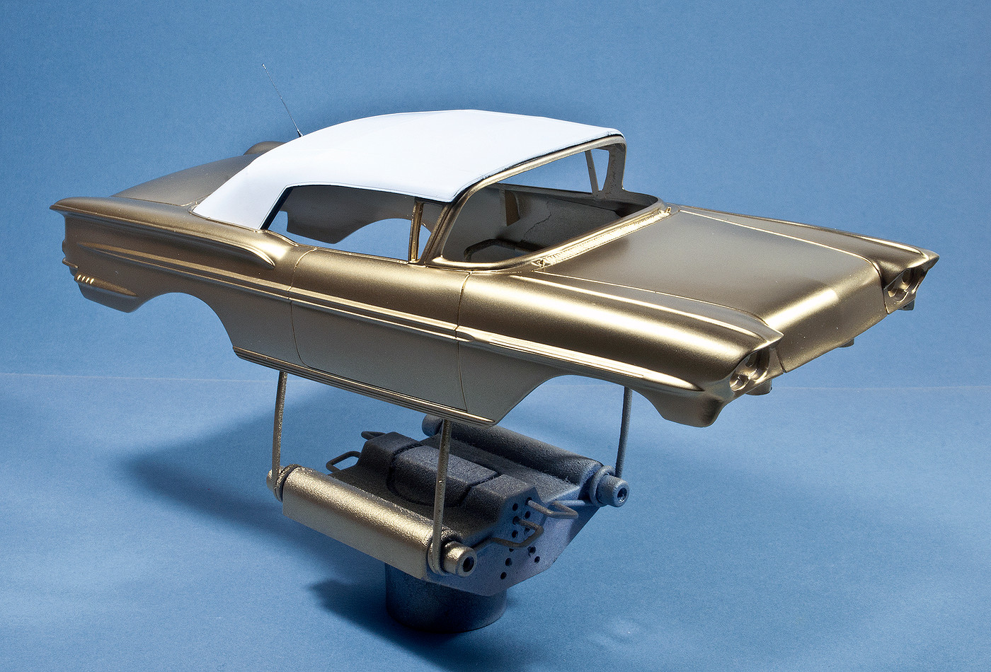

John Goschke Posted January 18, 2017 Author Share Posted January 18, 2017 Base coat applied for a candy-style paint job. Top and scratch factory accessory "tuna boat" aerial. Quote Link to comment Share on other sites More sharing options...

High octane Posted January 18, 2017 Share Posted January 18, 2017 Interior attachment points The process of disassembling this old model when it arrived required grinding off the interior attachment posts and tabs inside the body where cement was used unsparingly by the original builder. This left the interior with no firm mounting points, a problem compounded by my desire to build a top-up convertible requiring the removal of the package shelf behind the rear seat and replacing it with some sort of representation of a floor for the top well. Before making the top well floor I wanted to make sure I could install, remove, and reinstall the interior in the same place consistently, and to have top edge of the interior and the top edge of the body line up every time. To do this I shaped two tabs of Plastruct ABS plastic to fit and cemented them inside the body, lined up with the door opening. I then cut a slot in a piece sheet of styrene to fit on the tab. The slotted piece was cemented to the side of the interior tub after the location was marked with a sharp pencil while the interior was held in place. Note that the side of the tub needed to be built out a bit because there was a step near the top edge. This is the first time I've used this technique and it worked great, and will come in handy in future rebuild projects. Great idea! Quote Link to comment Share on other sites More sharing options...

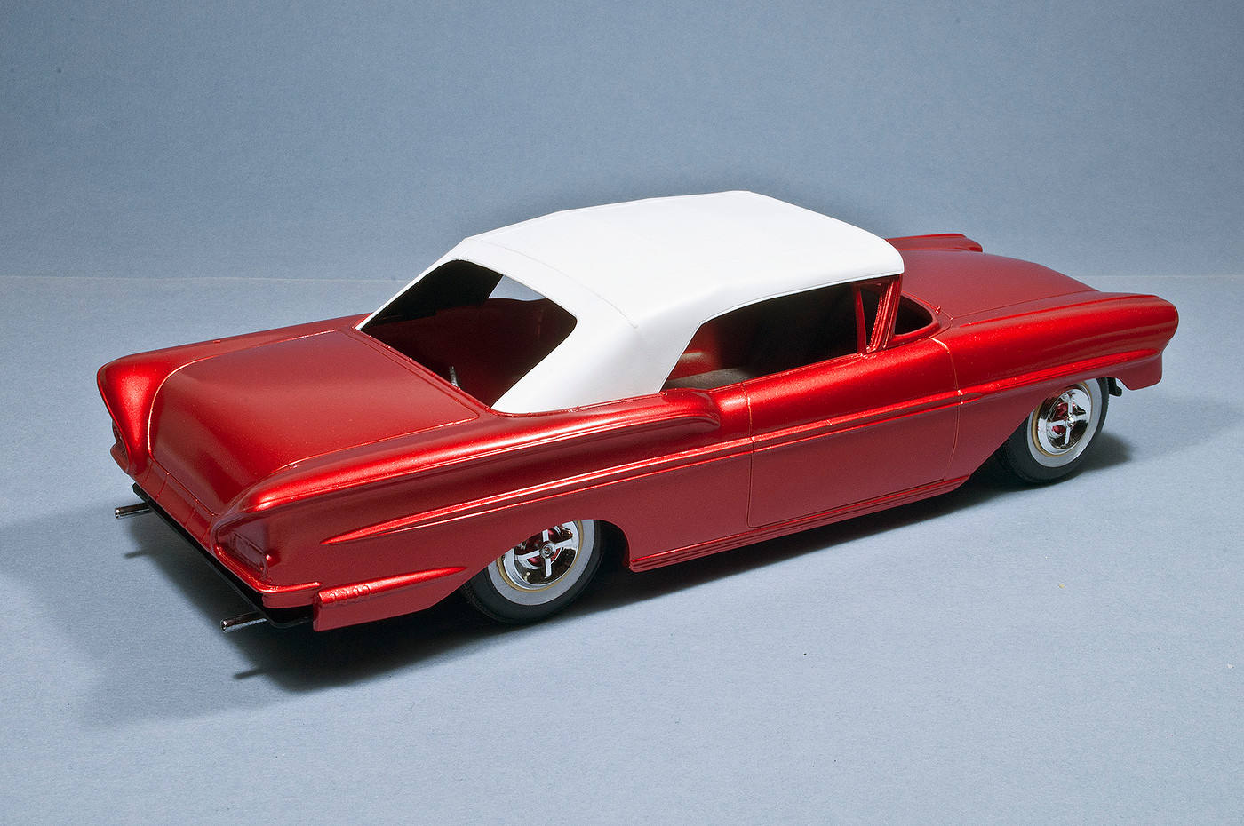

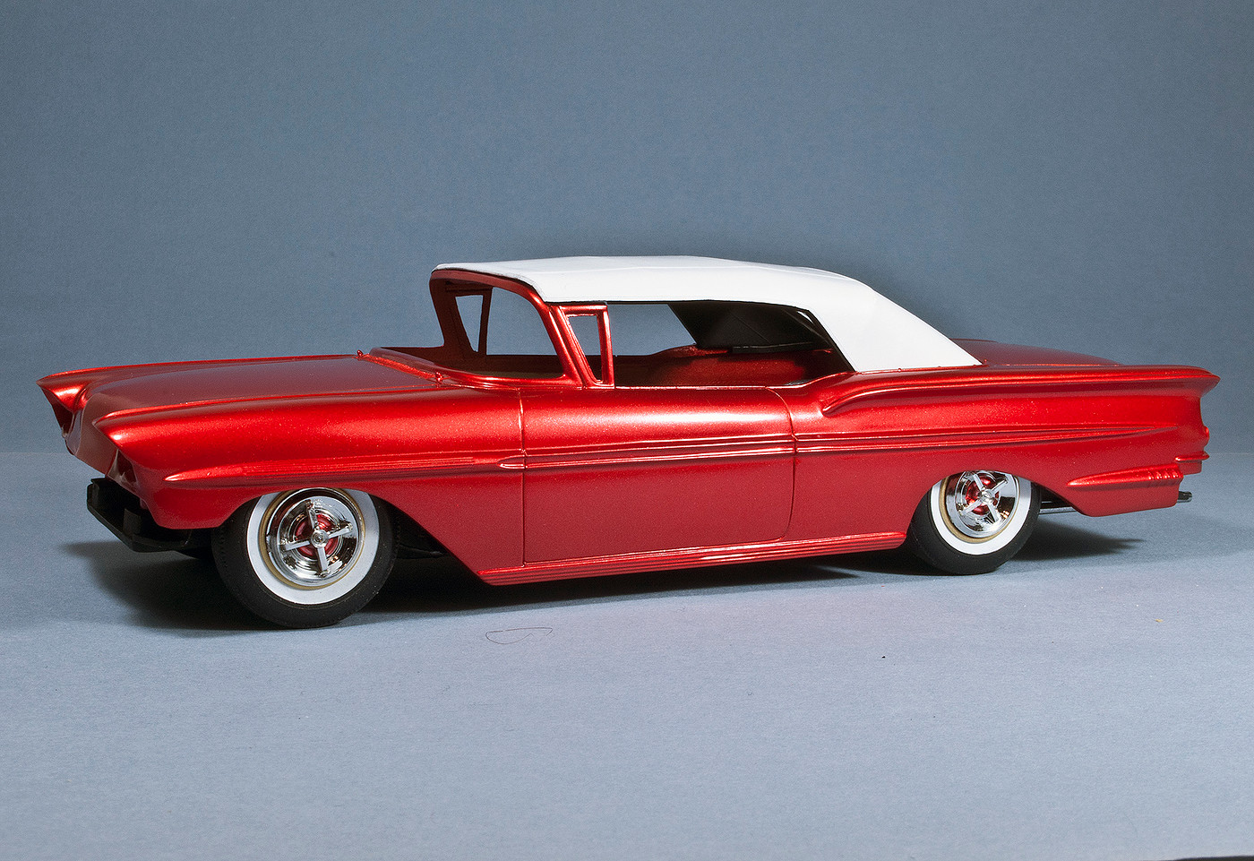

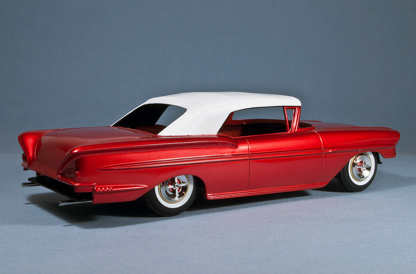

John Goschke Posted January 20, 2017 Author Share Posted January 20, 2017 (edited) Looking good. Thanks, James! Here she is with Tamiya Mica Red applied over the gold. The wheels have been painted gold with the center of the Lancer caps picked out in Mica Red. Edited January 20, 2017 by John Goschke Quote Link to comment Share on other sites More sharing options...
James2 Posted January 20, 2017 Share Posted January 20, 2017 Outstanding! I bet the BMF will really make'er pop too. Quote Link to comment Share on other sites More sharing options...
MrObsessive Posted January 20, 2017 Share Posted January 20, 2017 WOW!! Looking good John! Your uptop looks better than the one I did for my '58. I got the shape of the quarter windows a bit too rounded as yours show they should have sharper corners. Some pics I had showed a round profile to the glass, while others didn't. She's gonna be a real beauty! Quote Link to comment Share on other sites More sharing options...
CabDriver Posted January 21, 2017 Share Posted January 21, 2017 Looks GORGEOUS in red! Stunning! Quote Link to comment Share on other sites More sharing options...
John Goschke Posted January 21, 2017 Author Share Posted January 21, 2017 Outstanding! I bet the BMF will really make'er pop too. Thanks, James! Got some work to before foil, but I'm getting psyched to finish this one up! WOW!! Looking good John! Your uptop looks better than the one I did for my '58. I got the shape of the quarter windows a bit too rounded as yours show they should have sharper corners. Some pics I had showed a round profile to the glass, while others didn't. She's gonna be a real beauty! Thanks, Bill! Most photos I looked at show a sharp corner to the quarter glass and some old photos showed what I'm guessing were original tops that had a sharp corner. As the tops got old this stretched a bit resulting in a softer corner. Replacement top profiles could show curved corners. I love ragtops with the tops up – every one has a distinctive look that's often better than with the top down. Looks GORGEOUS in red! Stunning! Thanks, Cabbie! Quote Link to comment Share on other sites More sharing options...
