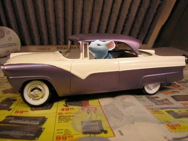

;) Clay, by tamer, he probly means the engine won't run,or the radio won't tune, or the wheels won't mount using 5 little lugs or....... :(:rolleyes:;)
Not being made with the intentions of Stuart Little driving it? :blink:
