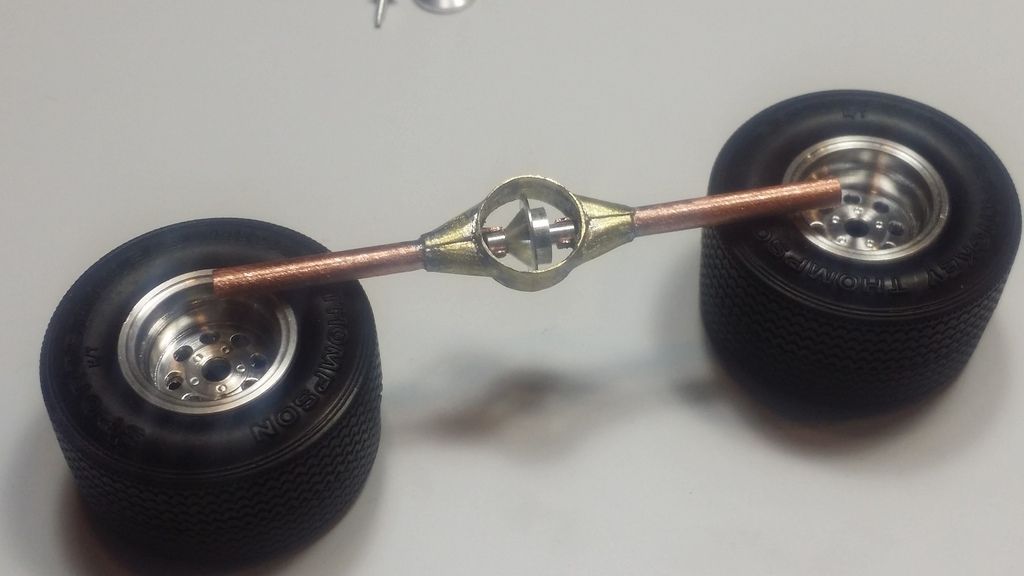

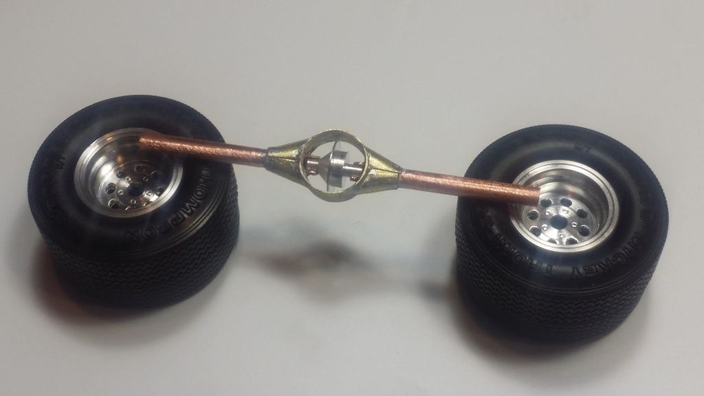

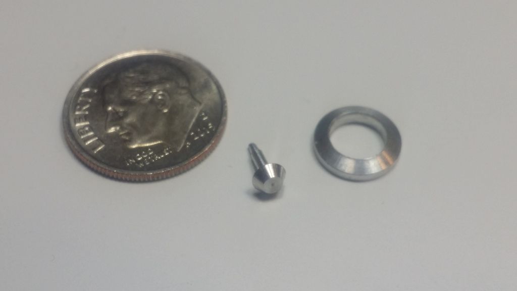

So its been a long time since my last update. Been working on this alot recently although there isnt much to show for it but here we go. Been working with brass and aluminum! A first for both and soldering brass also.
For my firt time working with brass im really happy with the rear end so far. The spool gear assembly needs to be redone ill use this one to measure and make one correctly. The ring and pinion set is the second attempt. Once the spool assembly is right ill cut the gears.

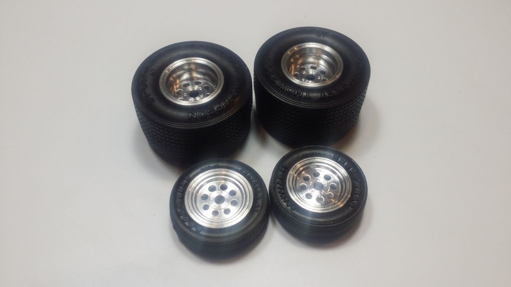

Also went with wheels from micro nitro well worth the money
Any questions comments or opinions welcome
Jason
