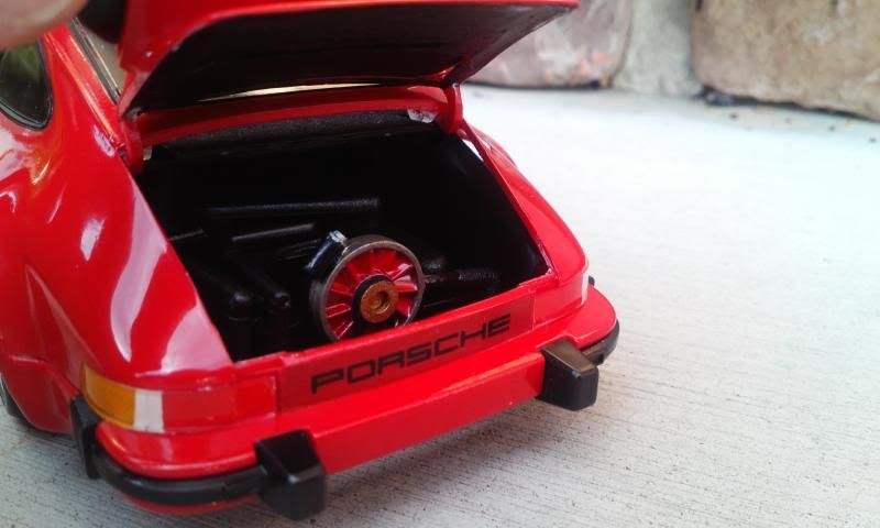

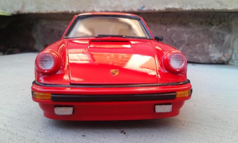

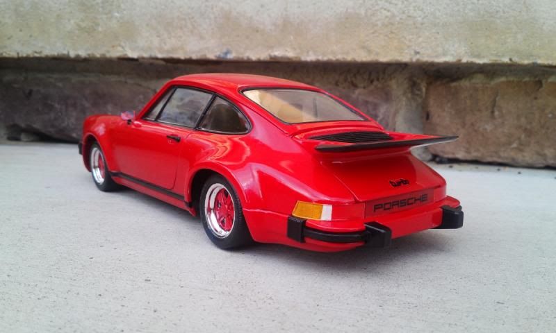

1985 Fujimi/Testors Porsche 930 Turbo

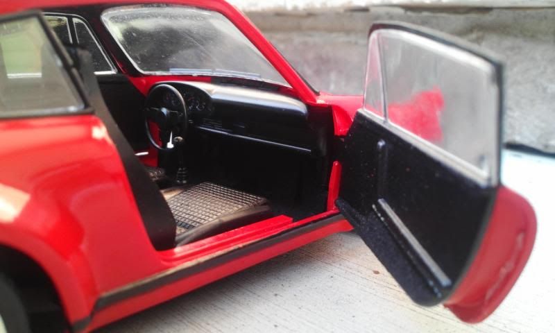

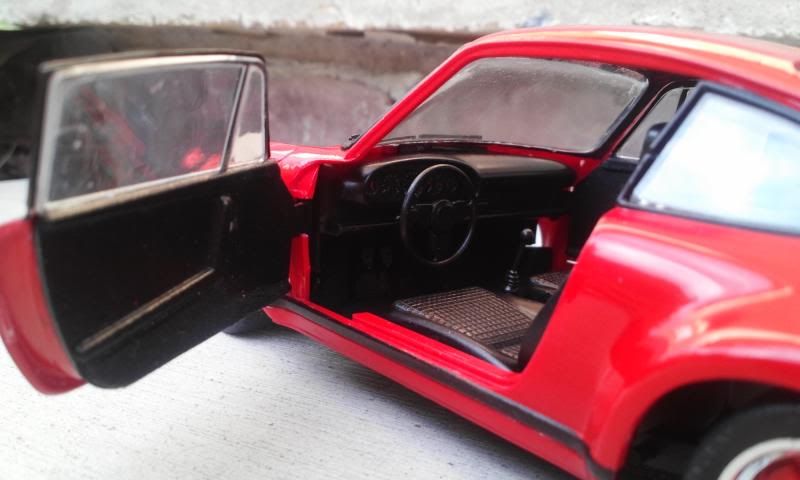

As a kid I used to stand in Kay Bee toys in the mid 80's staring at this kit on the shelf, wishing I could buy it. Back then $30 was allot of money to an eight year old. Even after mowing lawns, and doing chores for allowance I could never ...save up the money for this before someone else bought it. They only kept one on the shelf at a time. Fast forward 28 yrs later and I finally found one. I really wish I could have done something about the poor quality out of the box on the glass but it was molded with the imperfections deep in the plastic. No amount of wet sanding could save it, I tried. First time I have ever been disappointed with a Testors/Fujimi kit.

Forget about the glass,you did a great job here anyway!

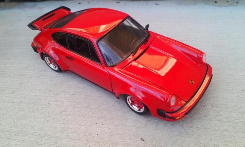

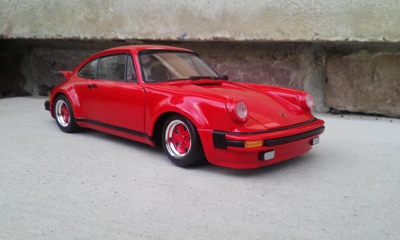

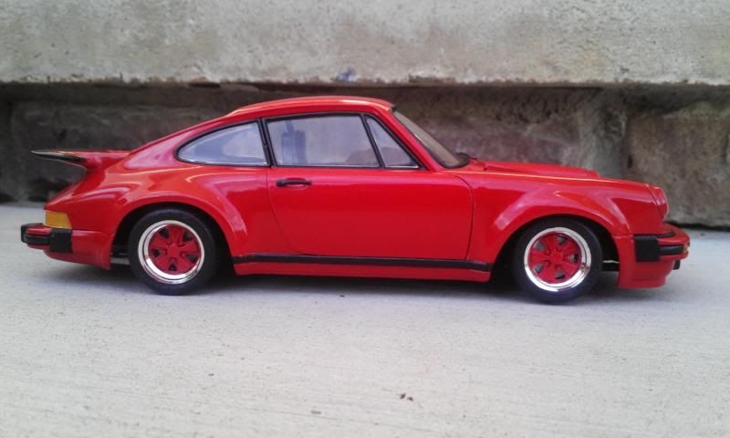

That paint is absolutely flawless. What did you use ?
The paint consists of 3 coats Testors Italian red lacquer, and 4 coats of Model Master Ultra gloss lacquer clear. I then wet sanded using 4K,6K,8K, and 12000 grit, followed up with polishing compound and brazil carnauba.

Looks beautiful! I didnt see anything wrong with the glass until the door was open and you looked thru the windshield.....No one will be getting SMALL to drive it so I wouldnt worry about the glass! Excellent job!

You did a great job on that! Is it the one done 1/20th scale?
Correct,1/20. I myself didn't realize the scale of it until I went to put it into a brand new display case and it wouldn't fit lol.
