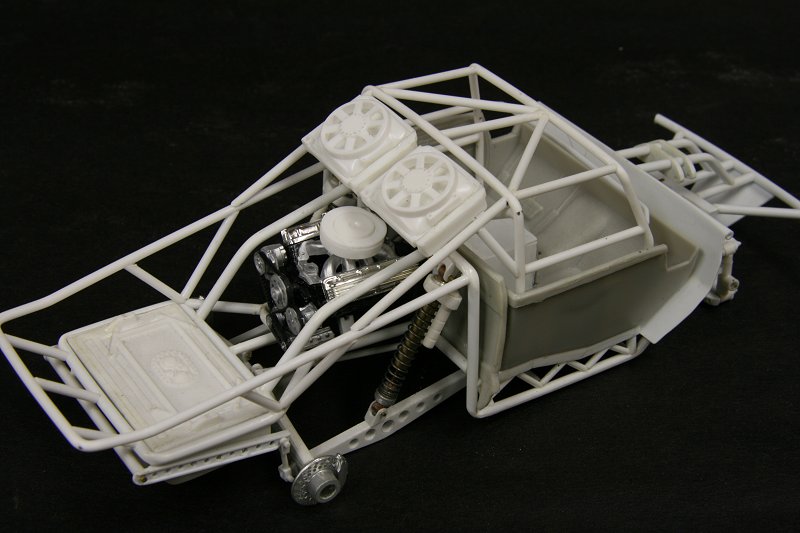

It might not be 100% accurate, but who cares. I love the freedom model building gives us. I started using the frame from the 1984 GMC kit but later decided to get rid of it , things just weren't going the way I wanted it to. The major reason for scraping the original frame was ground clearance. I had WAY to much. These trucks seem to squat quite low and the axle needed to pass the frame.
I'm still using the interior but wish I would not have now. Too late, to many things are designed around it.
The truck will be using a fair amount of parts from Nascar kits. Seats, engine , fuel cell so far. Shocks were made with various tubes of aluminum and brass....
Some pictures of the rear suspension in the up and down position. Everything is just pinned together for now. The challenge with this build is I want to make things permanent but can't as it will all need to be disassembled and painted first. Sooner or later I'm going to have to give in and get the airbrush out.

I found some tires at Modelhaus that suit this truck much better so will be using them. The are lower and wider. I was having a hard time finding rims wide enough . I went back to the parts box as grabbed two Nascar rims and sanded the backs down. A perfect fit. Added a bead lock rind and disk brake. Looks to fit the bill.
I've added a cab roll cage.... might add more to it yet and some rear frame bars. I need to get the cab tied into the rear suspension some how but can't. I'm having a tough time figuring out a way to do it where I can take it all apart for painting.
Here is where I am at now. So far the suspension is functional and the front tires steer as well.

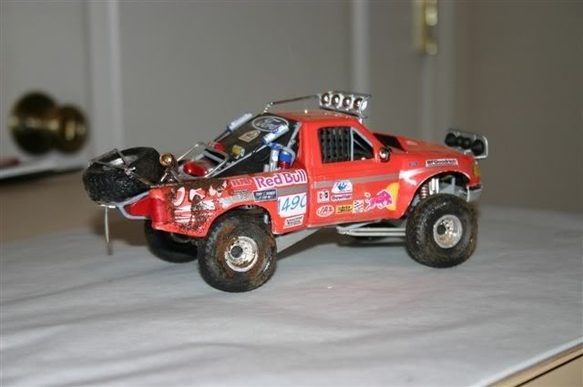

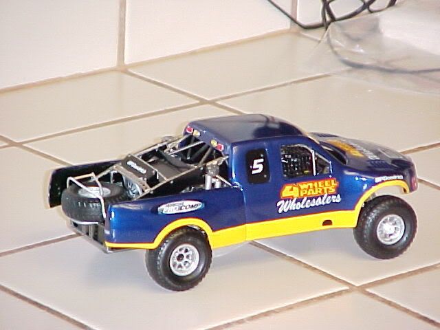

Here's some pic's of the models I have done using things like the Jello cups.
pick a product that fits your build ( look wise ). You will take the cup and use the bottom side of it as the ( top of the fender ) the roundness is what gives you the flair look and style for you build. You then line it up to your stock fenders trace the wheel well out on to your Cup and then cup it out. Mark out what you will need to cut away from your stock fenders then glue into place ad filler / putty to shape into your to your build then sand when ready. The rear can be done the same way but with less flair.
The Bonco was done this way. the back fenders are just the newer year molded in.
The Coyne TT was done using this also , both front and rear.
The Ranger the same.
Chase 1

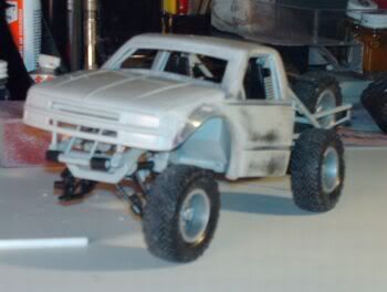

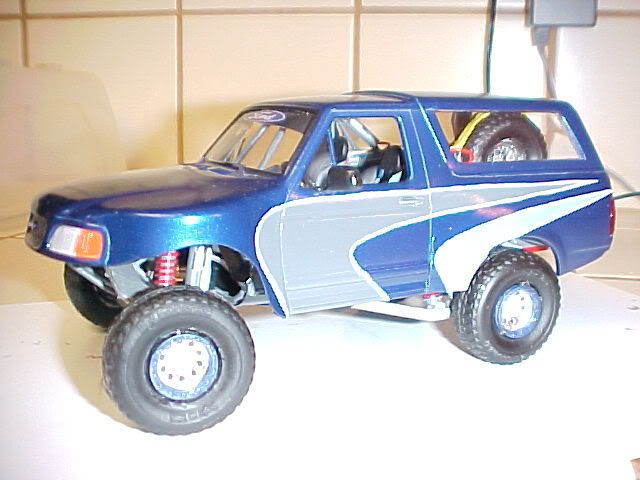

For the flares,also try lollipop molls...they come in many different shapes and styles,and usually there are at least four molds to a tray..Cheap too...Here are the pop molds i used on my chevy...
Before paint.
And after..
