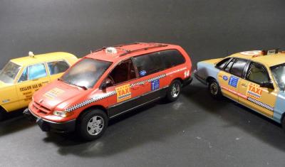

Wow! Didn't realize that I had put these aside for so long. I got involved with the NNL East preparations and that took most of my hobby time until now. I've decided that I do need to get a few things off the bench. And when I was at the Mid-Atlantic NNL this past weekend someone asked about these projects. So here's what I did this week...
We had a fair amount of conversation on how to do the windows on this kit. Some folks have just flat blacked the rear glass, blocking off any view of the interior. Others have suggested a variety of ways to tint the glass, which I will try on a future build. I've seen models on display that they did nothing at all, which left the sides clear, where the real truck has metal between the side glass panes. That just doesn't look right. About 80% of Caravans had the factory tint package, but there were a lot of cheapies that just had the clear glass. Those had the black mask visible. The same mask is on the ones with tinted glass, only you don't see it readily in photos. It is visible in person depending on how the daylight is hitting it. I have a 1:1 '96 Grand Caravan in my driveway for reference.
So I decided to take the difficult road with this build, figuring that a taxi would have the cheap glass. Or if ordered new, a fleet operator would want the clear glass for security reasons. So I drew up a set of glass masks. I made a template for the rear glass and one for the side glass. Then I traced them onto Avery name tag labels. I found these worked well because they will peel off easily. I have other white labels (I have a roll of UPS ones) that will never ever come off. Be careful what you use. The above photo shows the masks in place ready for paint. Note that I had already colored the front glass with a Sharpie so I just masked it all off. Next time I'd do that with a mask and paint also.
Another view of the masks in place. Important to know that I cut out the side masks at the same time. The name tags come two to a sheet, with a perforation line between them. I merely folded this over, drew my cut lines on one side, and cut a pair at the same time so they'd be exactly the same.
The templates. I did these in card stock so I could use them over and over. Notice that the rear glass template was folded in two. That was cut like a paper doll, so that both sides would be symmetrical. Templates worked for me since I went through half a dozen sets of stickers as I tried to get them to the right size and position. I probably had two hours invested at this point.
Here's the rear glass for the CV Caravan. Note that the side glass was done in body color to make a panel van. So I had cut the clear window piece apart.
IMG_0627-vi.jpgHere
Here we are with the glass shot painted and masks removed! I used Testors Flat Black for paint. It worked very well and I'm super pleased with the results. Note that the paint is on the inside of the glass. I had masked of the entire exterior glass.
Side view, glass just held in place. It looks exactly as I hoped it would. A quick aside - the phone number on the taxi is my old home phone from when I lived in New Jersey. Just for fun!
Rear glass in place looks good too. I will add the rear third light and a wiper.
This was the hurdle that kept me from finishing the pair of Caravans. I still have to repaint an area of the CV in silver so that's what I'll do next. Then it's onward to final assembly for the pair!

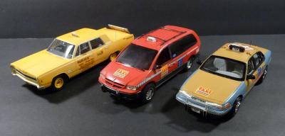

I just slammed this one together when they first came out, Used the Revell Caprice stickers for the cab decals.
post-13341-0-15430300-1400108735_thumb.j
What to do with extra kits that you bought for parts, 'call me a cab'
JoHan plymouth
Lindberg Ford CV
post-13341-0-93220200-1400108835_thumb.j
Your cab is neat I did not just have time for the details
greg
