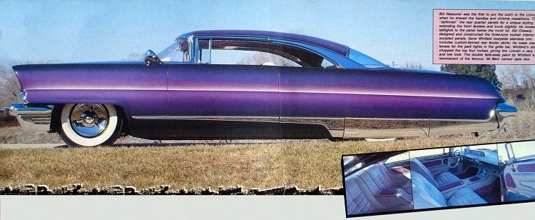

goosedude Posted August 13, 2013 Share Posted August 13, 2013 I want to chop a Modelhaus 56 Lincoln Premeire. The front pillars are very thin and I'm not sure how to glue it back on. What would you guys recommend for glue? CA glue? I'm trying to build a replica of this car... Quote Link to comment Share on other sites More sharing options...
