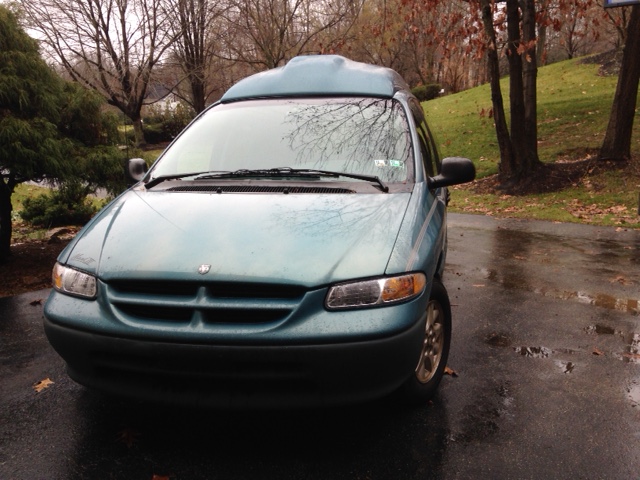

Tom Geiger Posted September 5, 2015 Share Posted September 5, 2015 (edited) My favorite auto part was the Chrysler air filter casing. The ribbed rubber hose between the filter casing and the fuel injection had cracked so it was sucking in dirty air from the engine bay. I try the auto parts store... nope, OEM only. I go to Chrysler and they only sell it as a unit for $200! No reason for that at all since the hose has a clamp on either end! Hello junkyard, found a decent one, air filter box and all for $10 Headlights weren't an issue though. Many of the older ones have gone opaque and past polishing back to clear. I found a pair on eBay for the Caravan for $65 postpaid. I also bought two new bulbs from a different vendor for $10 postpaid. Both of these purchases showed up the next day. Amazing, the lights came from CA to PA. I look them over against my worn ones, and they are exact to the makers marks. Either OEM the supplier for Chrysler or an amazing exact replica. And then I notice that the unit has all the bulbs in it already. I thought the lights were a bargain without the bulbs! So I kept the extra pair I bought for another day. i Caravan with brandy new headlights! I can see again! I buy a lot of my auto parts on eBay or Rock Auto. Much cheaper than buying locally from one of those chain auto parts stores like Pep Boys who doesn't have what you need half the time. Delivery is often the very next day, never more than 3 days. Edited September 5, 2015 by Tom Geiger Quote Link to comment Share on other sites More sharing options...
