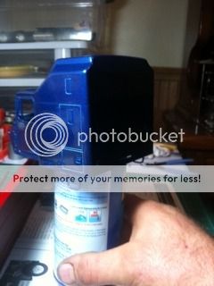

tbill Posted October 1, 2013 Author Share Posted October 1, 2013 epic fail after a few days of work, i have drenched the cab in paint.....oooops..., it all started with a good cleaning, followed by a 600 wet sand, dry, primer, dehydrator. [next day], sand with 6k, smooth as silk, re prime, dehydrator. tonight, wet sand [looks great at this point], paper towel dry, and in the can for 30 minutes. warm the paint [rattle can], set up the 'booth', and spray away. this is the point that i turned back into a little kid first dusting looks good, so lets pound the paint to it........ so, we are off to get some purple for the pond in the next day or so... upside is, what isn't sagging or pooling, looks awesome no orange peel or dry spots, so a lesson was learned here so, after i get the stuff to de-paint it, i'll give it another go.... Quote Link to comment Share on other sites More sharing options...

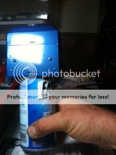

tbill Posted October 4, 2013 Author Share Posted October 4, 2013 well, I had my first experience with the 'pond' [in my case, green], had to remove all evidence of my first failure after some soaking and scrubbing, I almost had it clean, I finally got it back to square one, but now I need some more help here is where I am at now, now, my question is this [well, one of them anyway], see the sleeper door panel lines, they are way more white in person, what causes this? the cab door lines look ok, but the sleeper lines don't, is this due to them being deeper? or did I just not get enough paint in there? or should I scribe and blackwash to help avoid this in future? also, pic of the rear of cab is to highlight my 'peel', what are my options here as far as smoothing it out? should I clear it, then sand that, or color sand this, then clear? or say good enough for my second first paint job and do better on the next one? as always, thanks for reading. Quote Link to comment Share on other sites More sharing options...
clayton Posted October 5, 2013 Share Posted October 5, 2013 If you are using Testors enamel that could be it.that stuff wants to run,sag separate on corners.have to paint with fine mist and let it build up. I stopped using that years ago. Went too krylon and Duplicolor. Peeling don't know. If you want too sand it and repaint and clear, I have done that. Quote Link to comment Share on other sites More sharing options...
