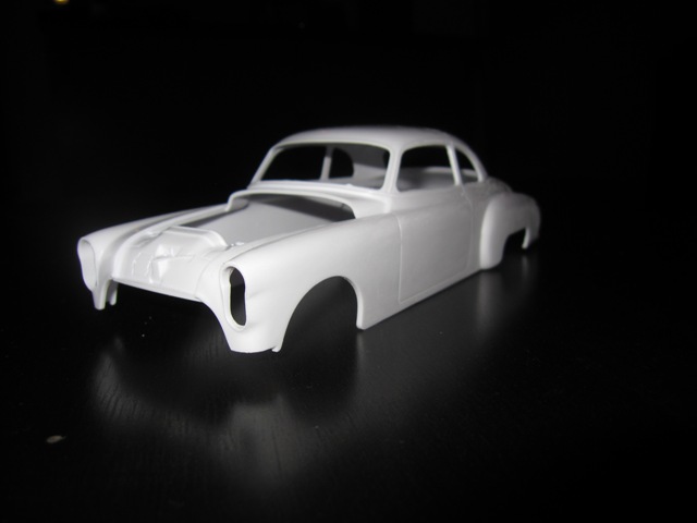

Not my normal choice in builds, but this is a group build so kind of stuck with it. Decided to get a bit adventurous (for me at least), aiming for a smoothed convertible dropped to the weeds in this one.

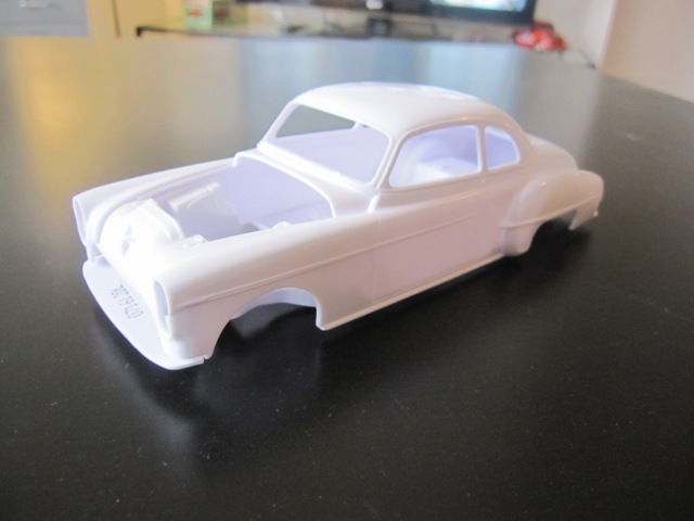

Spent today getting inspiration (found it), shaving the body trim...
post-10435-0-20701900-1384059394_thumb.j

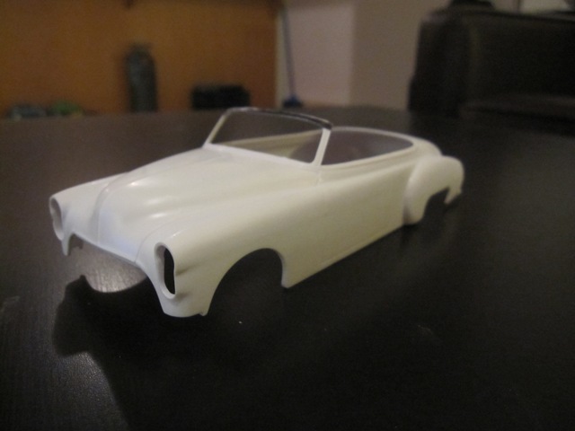

and losing the roof.
post-10435-0-54008600-1384059393_thumb.j
Next up is to find the wheels then figure out how to drop the suspension and fit them in there.

Great idea! One of the main areas that people screw up when doing this to 1:1 cars is in the windshield header. The convertibles had a shorter windshield, so you may want to chop that sucker down a bit. Take the advice posted above about using the '51 Chevy for the top and interior parts, and you'll also get the correct door vent windows that you can measure how far to chop the windshield off at. Also, the top corners of the windshield frame are a little less rounded off towards the rear. The door vent window is curved on the coupe, but more triangular with a flat top on the convertible. Here's a pic of my '50 Chevy. The Olds is the same, but a 1piece windshield
