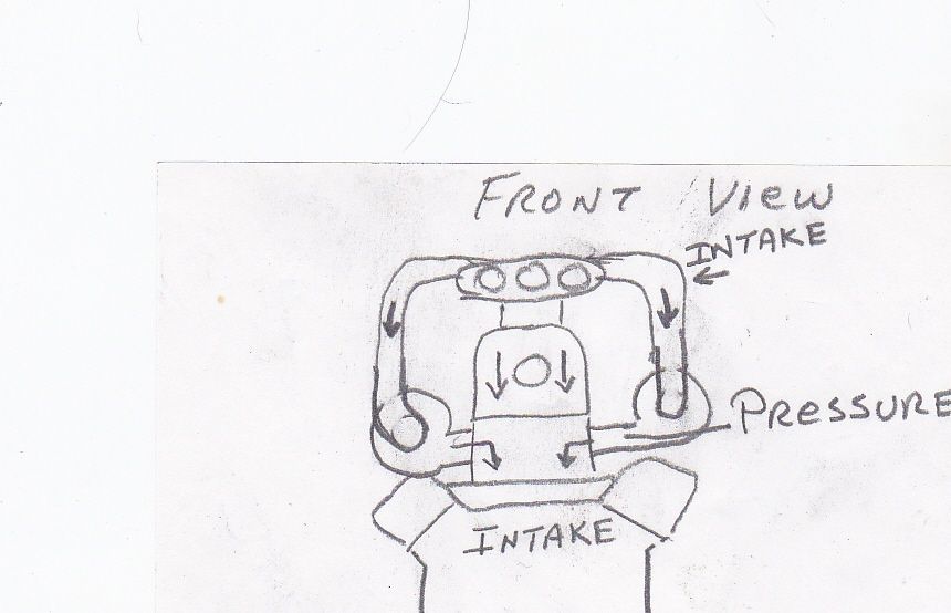

Ace-Garageguy Posted November 13, 2013 I'm particularly interested in the frame of the vehicle in the OP...rather a large cutout for exhaust header clearance where the frame would do well to be its strongest to support that massive amount of hardware. Just sayin'... The Camaro in post #26 should be quite a nightmare to tune too, if my understanding of the plumbing is correct. The turbos appear to be blowing through carbs perched on top of the Roots-type blower (under an apparently dummy injector hat) but it would seem that all the boost from the turbos would blow out the front when the throttle butterflies open. Those fancy S-curves coming out of the turbos are big flow-killers too. Someone please correct my understanding if I'm wrong here. Quote Share this post Link to post Share on other sites

dwayne4385 Posted November 14, 2013 I'm particularly interested in the frame of the vehicle in the OP...rather a large cutout for exhaust header clearance where the frame would do well to be its strongest to support that massive amount of hardware. Just sayin'... The Camaro in post #26 should be quite a nightmare to tune too, if my understanding of the plumbing is correct. The turbos appear to be blowing through carbs perched on top of the Roots-type blower (under an apparently dummy injector hat) but it would seem that all the boost from the turbos would blow out the front when the throttle butterflies open. Those fancy S-curves coming out of the turbos are big flow-killers too. Someone please correct my understanding if I'm wrong here. I was just looking at the camaro again and the intake on the turbos is plumb to the injector hat. So there shouldn't be a pressure drop Quote Share this post Link to post Share on other sites
Ace-Garageguy Posted November 14, 2013 (edited) I was just looking at the camaro again and the intake on the turbos is plumb to the injector hat. So there shouldn't be a pressure drop So what happens to the pressure when the butterflies open??? Think like a manometer. It blows out the front (it will ALWAYS take the path of least resistance, and it's easier to flow out the front than it is to flow through the restrictions under it). Or correct what I'm not getting here, please. EDIT: I completely and stupidly failed to notice that it was the intake side of the turbo compressors that is plumbed to the injector hat, so there will be 'suction' (negative pressure) behind the butterflies with the engine running, rather than positive pressure as I mistakenly wrote above. My apologies for my momentary lack of brains. Edited November 14, 2013 by Ace-Garageguy Quote Share this post Link to post Share on other sites
dwayne4385 Posted November 14, 2013 When the butterflies open the airflow to the turbos would increase. I don't think that his setup is the best way to go, but he refers to his car as a trailer queen. SO I'm sure he doesnt mind restricting airflow to the turbos as long as it looks "good" Quote Share this post Link to post Share on other sites
Ace-Garageguy Posted November 14, 2013 (edited) When the butterflies open the airflow to the turbos would increase. I don't think that his setup is the best way to go, but he refers to his car as a trailer queen. SO I'm sure he doesnt mind restricting airflow to the turbos as long as it looks "good" Duh...my dumb. I wasn't noticing that it's the intake side of the turbo compressors that's plumbed into the injector hat, so you're entirely correct. Where does the output side of the turbo compressors blow? Into the manifold under the Roots-type blower? Edited November 14, 2013 by Ace-Garageguy Quote Share this post Link to post Share on other sites
DonW Posted November 14, 2013 (edited) So what happens to the pressure when the butterflies open??? Think like a manometer. It blows out the front (it will ALWAYS take the path of least resistance, and it's easier to flow out the front than it is to flow through the restrictions under it). Or correct what I'm not getting here, please. I agree with Ace - when I started racing my 2002 turbo I had big problems with the ducting from the t/c to the plenum chamber using some old hose we found - under boost, maybe .8 bar, it would find any weak spot and open it up and all the boost was gone, no matter which way the tubing was pointing. So that big old bugcatcher would actually become a bug deflector! Silicon hose fixed my problem, but the Camaro is obviously just for show!I also missed the obvious, that the air from the scoop feeds into the turbos - but it looks like the air from the turbos goes up and in above the blower too! So that would still go back out of the bugcatcher. Or if it is fed back under the blower then the turbo might stall depending on how much boost the blower makes as against the turbo In fact at low reves the blower will blow air into the turbo, so the turbo might never be able to overcome that and may never spool up at all! Edited November 14, 2013 by DonW Quote Share this post Link to post Share on other sites
dwayne4385 Posted November 14, 2013 I agree with Ace - when I started racing my 2002 turbo I had big problems with the ducting from the t/c to the plenum chamber using some old hose we found - under boost, maybe .8 bar, it would find any weak spot and open it up and all the boost was gone, no matter which way the tubing was pointing. So that big old bugcatcher would actually become a bug deflector! Silicon hose fixed my problem, but the Camaro is obviously just for show! I have built 4 turbo cwrs and worked on many others. I have never ran hose straight from the turbo to the plenum. Maybe I misunderstood you. Another problem is you said some old hose. Well of course an old dried up hose isn't going to hold up under boost. Quote Share this post Link to post Share on other sites
rel14 Posted November 14, 2013 The turbos blow in under the blower, which will only work if the turbos force more air in, then the blower puts out, if the blower has more pressure , then the turbos, it will never work,, ( for looks, its cool, for real use,,i don't see how.) Quote Share this post Link to post Share on other sites

dwayne4385 Posted November 14, 2013 How would it not work? If the blower is compressing air and pushing it In the motor and the turbos are forcing even more air in after the blower I would think it would make crazy horsepower. More air more fuel more horsepower Quote Share this post Link to post Share on other sites
dwayne4385 Posted November 14, 2013 (edited) I just watched the video again. Looks like he has the turbo going In before the supercharger. Edited November 14, 2013 by dwayne4385 Quote Share this post Link to post Share on other sites
DonW Posted November 14, 2013 I have built 4 turbo cwrs and worked on many others. I have never ran hose straight from the turbo to the plenum. Maybe I misunderstood you. Another problem is you said some old hose. Well of course an old dried up hose isn't going to hold up under boost. On a 2002 turbo (as with most turbo setups) the pressurised air from the turbo goes to the plenum chamber (on mine, via an intercooler) and is mixed with the fuel and on into the inlet manifold pipes. I agree about the old hose! we used what we had and it wasn't good enough hence the new silicon hose which fixed it.Thanks Randy for clearly illustrating what I was trying to get across! Quote Share this post Link to post Share on other sites
dwayne4385 Posted November 14, 2013 Ok I understand how a turbo works and an intercooler. On my turbo cars I have never ran a hose from the intercooler to the throttle body. I have always used 3" exhaust pipe with a bead wlded all the around about 1/2 from the end and silicone couplers with t clamps. Quote Share this post Link to post Share on other sites
Ace-Garageguy Posted November 14, 2013 (edited) How would it not work? If the blower is compressing air and pushing it In the motor and the turbos are forcing even more air in after the blower I would think it would make crazy horsepower. More air more fuel more horsepower The concept is that pressure isn't necessarily additive. IF the Roots-type blower is making, let's say, 20psi (pick any number, really...don't go arguing about how much boost a blower will make), and IF the turbos are only delivering air at say, 10psi, the 20psi will leave the intake manifold heading into the lower-pressure turbo impellers, and stall the airflow coming from them. In principle (juggle the numbers as you see fit) a 20psi output from one airpump and a 10psi output from another airpump, both blowing into the same manifold, will not make 30psi. Maximum manifold pressure will only be equal to about the maximum pressure available from the compressor that makes the most boost. COMPOUND turbo-supercharging (or compound mechanical supercharging) works, usually, because compressed air LEAVING one compressor (either the turbo or mechanical supercharger) is fed into THE INLET OF THE OTHER compressor, which raises the pressure even more. Edited November 14, 2013 by Ace-Garageguy Quote Share this post Link to post Share on other sites
dwayne4385 Posted November 14, 2013 i understand if the turbos are after the blower, but they are before the blower. So the turbos are sending compressed air into the blower. Which is compressing it along with fresh air. I'm not saying its going to make a million pounds of boost. But it will make more togeather than either setup alone. There's a guy around here with a compound turbo eclipse. He is running a 16g turbo feeding a hx40. Last I heard he was running 65 pounds of boost. Now there is no way either turbo can push that much boost seperatly. But togeather they can Quote Share this post Link to post Share on other sites
Ace-Garageguy Posted November 14, 2013 (edited) i understand if the turbos are after the blower, but they are before the blower. So the turbos are sending compressed air into the blower. Which is compressing it along with fresh air. I'm not saying its going to make a million pounds of boost. But it will make more togeather than either setup alone. There's a guy around here with a compound turbo eclipse. He is running a 16g turbo feeding a hx40. Last I heard he was running 65 pounds of boost. Now there is no way either turbo can push that much boost seperatly. But togeather they can If you look carefully at the photos and the illustration of the Camaro (which I failed to do earlier) you'll see that the turbos are blowing into the manifold AFTER the blower. They would have to be blowing into the inlet side of the blower (the top) to have the effect of raising pressure above what the blower is capable of delivering when the intake side of it is at atmospheric pressure. Properly plumbed compound turbo-blower. Air filter to turbo compressor, to blower, to intake manifold. Yes, as you say, THIS setup will raise boost considerably. Edited November 14, 2013 by Ace-Garageguy Quote Share this post Link to post Share on other sites
