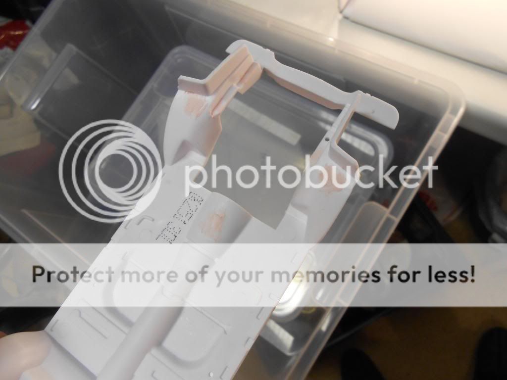

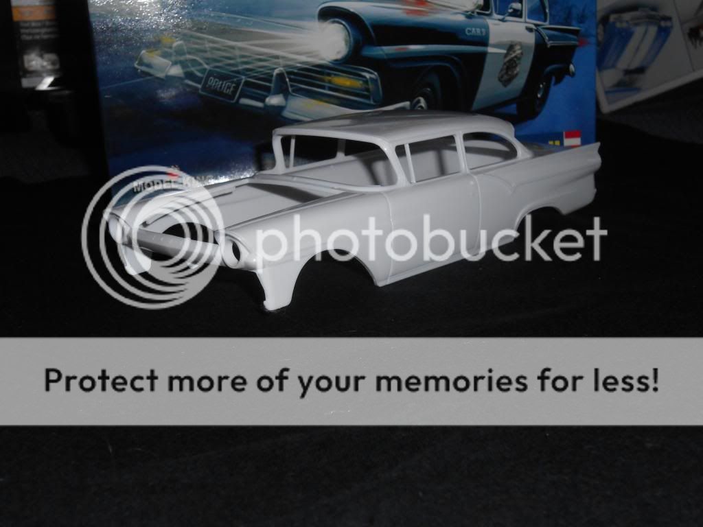

W-409 Posted December 5, 2013 Share Posted December 5, 2013 I have wanted to do a more detailed WIP Thread on here for a long time. The idea is to tell in more detailed way how I do these things and I hope that someone will find these things helpful, or at least enjoy the progress on this '57 Ford. At least I enjoy reading and looking those very detailed WIP-Threads and I learn lots of good tips and tricks from them. I got this Revell / Model King '57 Ford Police Car kit as a Birthday Present a couple of days ago. The kit is an excellent one, everything seems to be correct. I'll be building something like Sean's Box Art Build from this one. I'm a bit afraid of that black paint job, but I hope it will turn out somewhat successful... Here are pictures of all parts trees and parts that are included in the kit: http://s486.photobucket.com/user/nigot58/library/57%20Ford%20Police%20Car?sort=3&page=1 I started from the engine, as usual. I glued the block halves together with liquid glue. I normally use Plastruct's Plastic Weld or Tamiya Liquid Cement. This time I went with Tamiya. After the parts dried, I sanded the seam between those halves smooth and brushed more liquid glue on that seam. After sanding that again, it looked good for primering. Just the regular Spray Can Primer that can be found from any Hardware Store was sprayed on. It looked really smooth after primer, that no Putty was needed. At the same time I removed mold seams, flash etc (Though there was very little of flash) from other engine parts that will be painted the same red color as the engine block. I sprayed the same Primer on those parts as well. If everything goes alright, tomorrow is the time for red paint. The chassis/interior part needed some putty work. First I sanded the molded in Copyright Textes away from the chassis. Then I put some putty to smooth things out and same thing on the interior side to cover ejector pin marks. There are a couple of Ejector Marks left, but they will be all covered with seats or dashboard. Also the Dashboard needed just a little sanding. I started removing a couple of mold seams of it with a file and then continued with 600 and 1,000 grit sandpaper and finished with 2,000. After Primer it looks ready for paint as well. Quote Link to comment Share on other sites More sharing options...

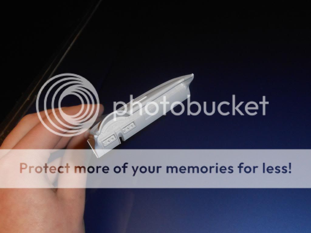

charlie8575 Posted December 5, 2013 Share Posted December 5, 2013 Quick notes, Niko. Prototype research has shown that Revell's painting instructions are off. The dash and metal interior parts should be medium metallic gray. The steering wheel and column are both black. Gloss for the column/stalks, and flatish for the wheel rim with semi-gloss spokes and hub, except the horn button, which is more a silver finish. This is a very correct restoration and will give you an idea of what things should look like. http://www.classiccar.com/ford/custom/ford-e-series-custom_14916/?age_min=1957&age_max=1957&keyword=Ford&page=5&limit=18&back= Charlie Larkin Quote Link to comment Share on other sites More sharing options...

W-409 Posted December 6, 2013 Author Share Posted December 6, 2013 Thanks Guys, I appreciate the kind words! Charlie: I usually never look at the painting instructions on model kits. But I haven't found that good reference pictures of this type of cars... All seem to be the "Basic" '57 Ford Customs. I guess the gray dash and other metal parts will be painted with Revell or Humbrol Enamel Paint from Airbrush. I just have to go and pick on bottle up. Those pictures are really helpful, Thanks a lot! I forgot to say on the first post, that all reference pictures and information about these cars would be highly appreciated. I'm not a Ford-Expert.... Quote Link to comment Share on other sites More sharing options...

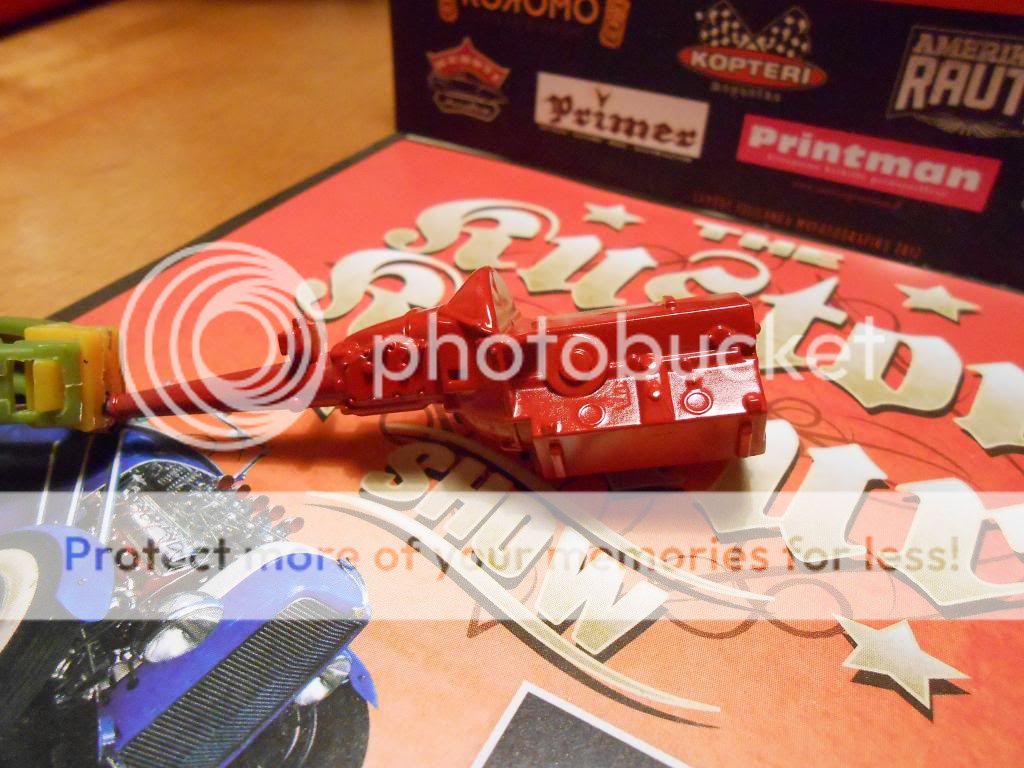

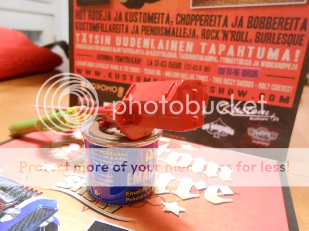

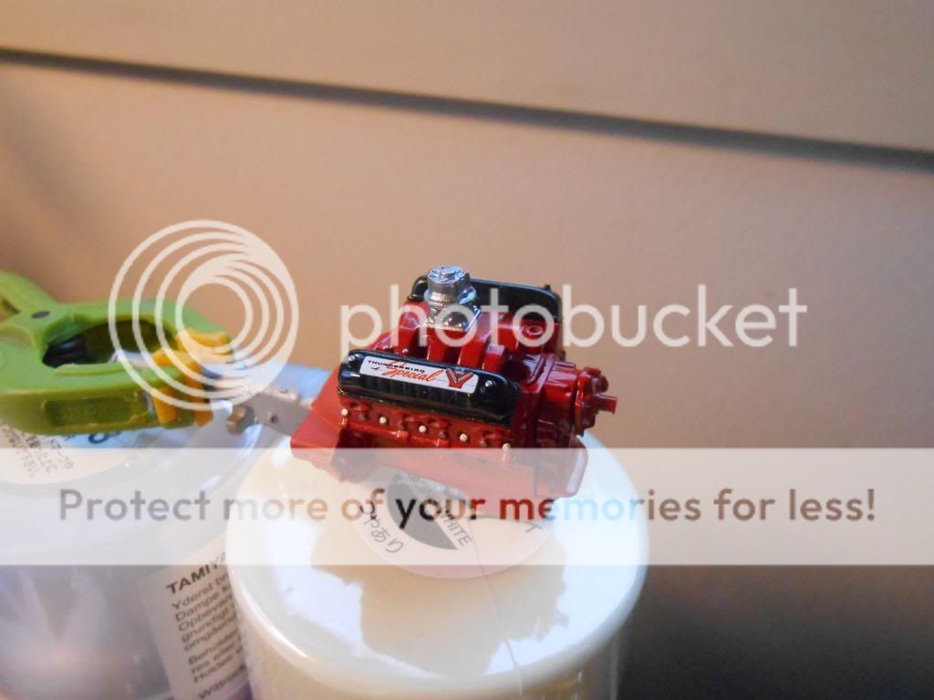

W-409 Posted December 7, 2013 Author Share Posted December 7, 2013 Today I went to our Capital, Helsinki, where was a Christmas Swap Meet with lots of cool Hot Rod style stuff for sale. One of Helsinki's Model Shops was on the way back home, so I stopped there and found a bottle of gray paint to be used on the Metal parts in the interior. It's a Semi Gloss paint, but hopefully Gloss Clear Coat will do the trick... But I got something visible done as well. I painted the engine Yesterday with red straight out from Spray Can. I think it turned out okay. I think the most important thing when painting engine or any other part that has lots of curves and different kinds of shapes, is spraying many light coats instead of just one light and one wet coat. Now I put the parts in Sauna so they hopefully are dry tomorrow and I can start assembling. Quote Link to comment Share on other sites More sharing options...
charlie8575 Posted December 7, 2013 Share Posted December 7, 2013 The semi-gloss might actually be a better move than gloss for the interior parts. They tended to be a little flatter finish. A sauna? I would think the humidity in there would cause all kinds of problems with paint drying? I suppose when in Finland, you use what you have... Charlie Larkin Quote Link to comment Share on other sites More sharing options...

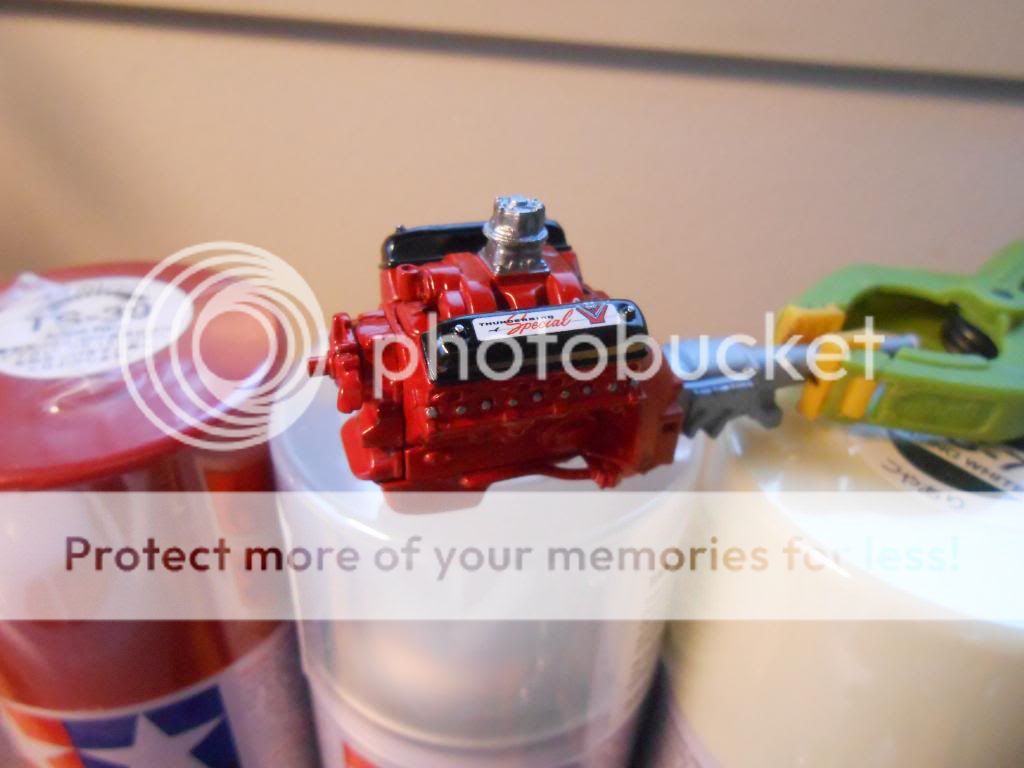

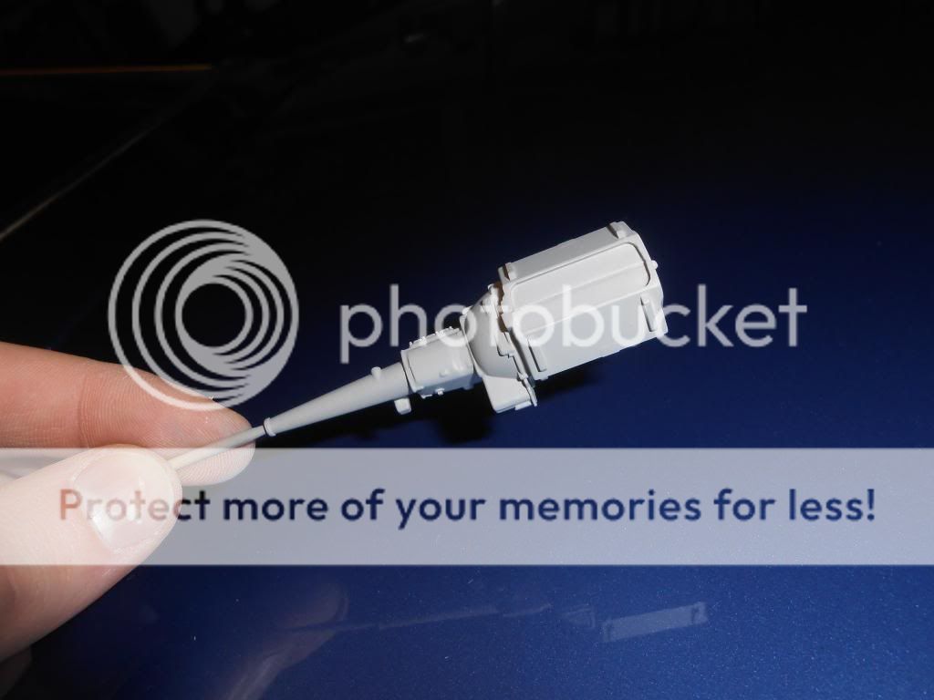

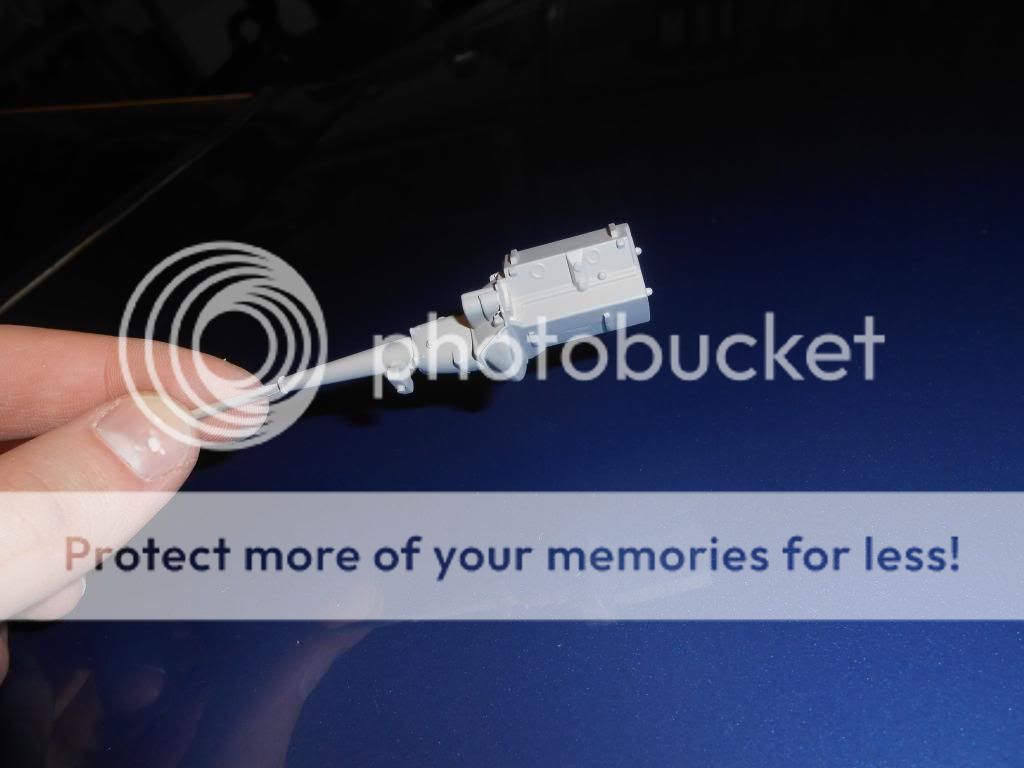

W-409 Posted December 12, 2013 Author Share Posted December 12, 2013 Thanks Lee and Carl! Today I thought that the engine is dry enough and painted the transmission with silver. But I can't get any further, because I have no idea what color I should paint that part that is circled in the picture. And what part it is? I'm really not a Ford Expert... Quote Link to comment Share on other sites More sharing options...
charlie8575 Posted December 13, 2013 Share Posted December 13, 2013 That, Niko, is an auxillary oil passage. Ford Y-Blocks had problems with their internal oil galleries sludging up, and as a result, the upper part of the engine would lose lubrication. Ford added that extra gallery around 1955-56 from what I understand to help maintain oil pressure. From the pictures I've seen, they generally seem to be red along with the rest of the engine. The bellhousing should be oxide red primer. Hull red, or a mix of flat red and flat brown to simulate that color, would be a good approximation. The transmission is cast iron. I like Tamiya X-10 Gunmetal for simulating that. Charlie Larkin Quote Link to comment Share on other sites More sharing options...
W-409 Posted December 13, 2013 Author Share Posted December 13, 2013 Thank You, Charlie. I had really no idea about the function of that part. I don't ever remember seeing it before. Another thing that I had no idea about was the color of the bellhousing. I thought that it might be a different color than the transmission, but really had no idea so I left it the same red as the engine is. Thanks for the information on that, too. I'll go ahead and paint it with some kind of a mixture... The transmission is painted with Humbrol Gunmetal, and I think it looks pretty good. Thanks for the information. I really appreciate it, since I want to get this one correct. Now Let's Paint! Quote Link to comment Share on other sites More sharing options...

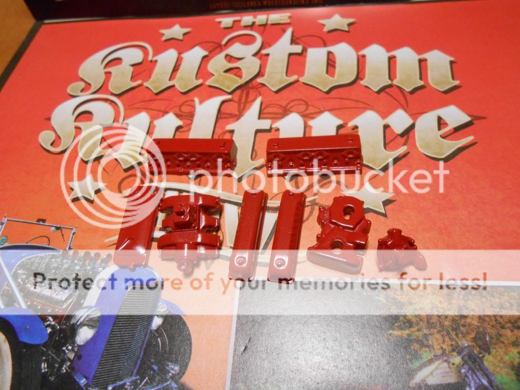

espo Posted December 13, 2013 Share Posted December 13, 2013 Niko, I have been enjoying your progress on the '57 Ford. Charlie has been giving you some very good advice on the color of things and such. As a past owner of two different '57 Fords many years ago including a standard coupe the only thing I would suggest is that originally the valve covers were painted black with the decals on them. The valve covers on the sample photos are from the T-Bird engine dress up kit This may very well been an option on this engine, but if you chose to use the "factory" valve covers in the kit the indentations.in the covers should be on the bottom side. Another possible source of information is Collectible Automobile magazine . Try collectibleautomobile@pubint.com. Their Aug, 2011 and April 2012 issues both have a lot of info and pictures on the '57 Fords. Quote Link to comment Share on other sites More sharing options...
W-409 Posted December 13, 2013 Author Share Posted December 13, 2013 Thanks David! I really appreciate your help on this! You're actually correct about the valve covers. I don't know where did I get the feeling that they should be painted red, even though the reference pictures that I used clearly show their black color... Maybe it's because Chevy valve covers usually are the same color as the block. Well luckily I have paint stripping liquid very close and I will remove the red paint and spray some black over the valve covers. I have found pretty much pictures of the engine, but in the interior everything isn't that sure. And I have a very little idea about the chassis. I have to go and visit at my friend's place to see if he has those magazines (He has lots of them! ). Thanks for the tips. Today I painted the bellhousing with red oxide primer that I mixed using Humbrol Brown and Red paints. I will put some flat clear on it tomorrow and post a picture then. Quote Link to comment Share on other sites More sharing options...

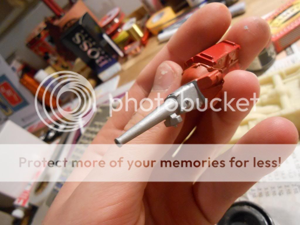

W-409 Posted December 25, 2013 Author Share Posted December 25, 2013 I guess I'll paint my valve covers black and that's why I started removing paint from them yesterday. Once they are in bare plastic, I can continue the engine. I did something, though. The bellhousing was painted earlier with a mixture made of Humbrol brown and red paints and then it was clear coated with a flat clear. Yesterday I painted the transmission with Humbrol Gun Metal. Just a fast little update to show that this is not forgotten yet! Quote Link to comment Share on other sites More sharing options...
Speedmaven Posted January 5, 2014 Share Posted January 5, 2014 That line on the side of the Y block's oil pan is the oil pump and pickup tube. The 292 and 312 have an external oil pump at the back of the driver side of the block, and the pickup tube runs along side until it goes into the pan and down into the sump. Coolest thing about it is if your pump goes bad, there's no need ot drop the pan. The bad thing about it, is that it leaks all over everything...Hard to keep it sealed up. Those auxiliary lines went into the valve cover from a pressure source, like a oil pressure gauge fitting with a TEE added to transfer the oil to the rockers. Mainly, those were needed because of the low quality oils available back then, paraffin based oils would sludge up and clog the small oil galleries to the rocker shafts. Sorry to ramble on, just shedding a little light on the old Y block... Quote Link to comment Share on other sites More sharing options...
W-409 Posted January 5, 2014 Author Share Posted January 5, 2014 Thanks James! That's a great information, since I don't know much about these Y-Blocks, it's good to learn these things. As far as the project goes, it's not forgotten. I finally got the valve covers from paint removing. I'll shoot some Primer on them today and I'll paint them black as soon as possible. I'm working on a couple of Mild Customs at the same time, so the progress isn't too fast, but at least it's better than no progress at all I guess... Quote Link to comment Share on other sites More sharing options...

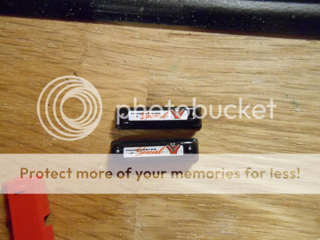

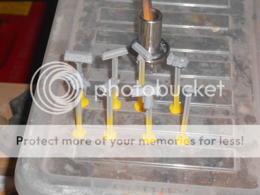

W-409 Posted February 27, 2014 Author Share Posted February 27, 2014 Thanks Richard! It is a nice kit and it's a lot of fun to build. Well I haven't done lots of progress with this, but anyway I was able to get the valve covers painted and decaled (Finally!). They are painted with Maston Spray Paints straight from the can, and before installing the decals, I trimmed the excess decal film away around the decal. Then there won't be any silvering. Now I will start putting the engine together and detailing it. Quote Link to comment Share on other sites More sharing options...
