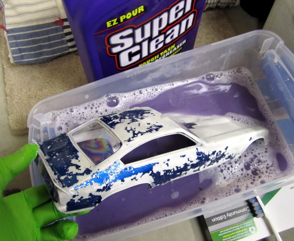

Has anybody ever heard of/tried castrol super clean degreaser? Before I kinda dwindled out of the hobby for a while it seemed to be great as far as dipping and soaking bodies over night. I know it works well for base clear, model master and the Boyd customs type paints as I had stripped those. But what some if the other 20plus year old paint was I have no idea as I received somebody's old collection and that was all I knew of it lol
Share this post
Link to post
Yep, Super Clean does a very good job on enamels and some soft laquers.

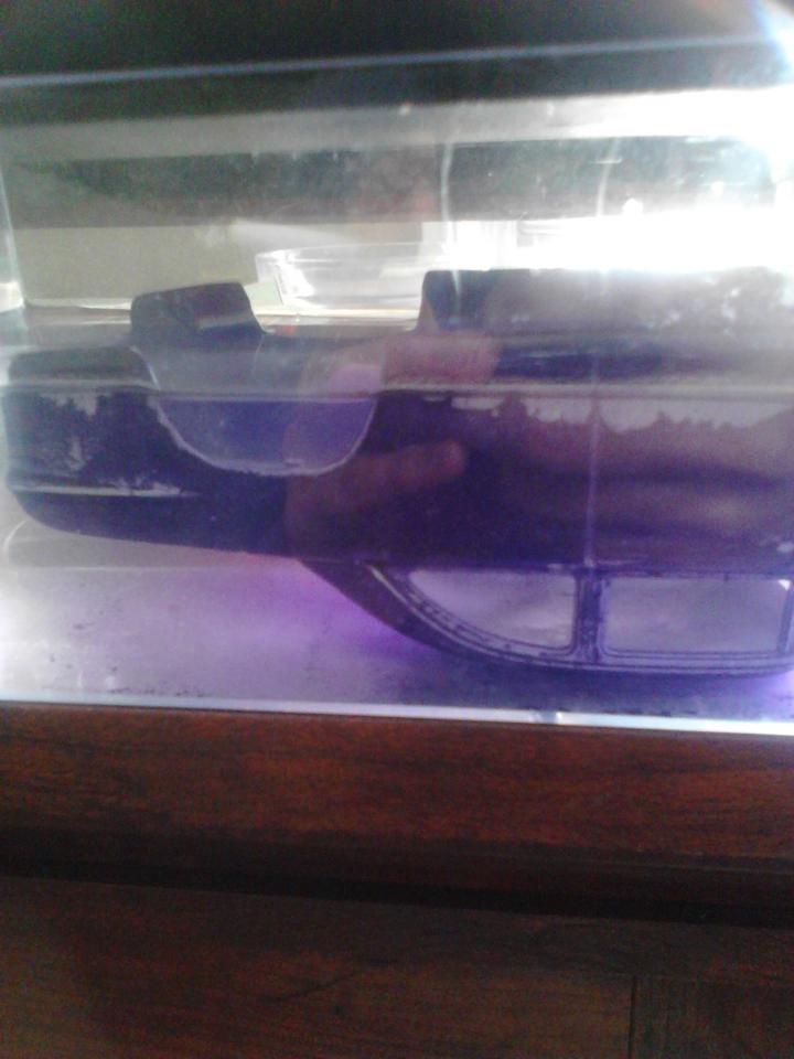

Also if there still just a lil bit paint just dip rag in the dip and wipe away I got another one in the same dip working now then have one more after so we see how good it is so far o good :)
Share this post
Link to post
What kind of paint did you strip and how long was it on the body?
Share this post
Link to post
Clear coat was rustoleum enamel never again base was modelmasters laquers and primer was cheap stuff the its been cured for about 4 days the other one in now been cured for over a month all laquer paints and clear it's about ready to come out now

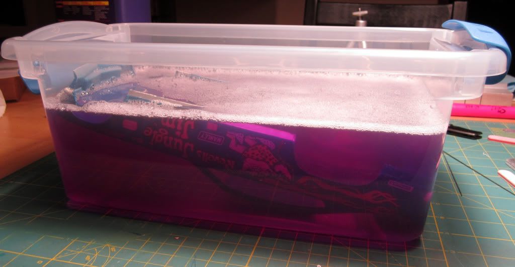

On Facebook, a page names ScaleTunedCustomz posted this picture of the Integra they are working on. To me, this is an ingenious idea. Figured I would post it here. They are using an old Revell Display case turned upside down.
903061_523369591053207_314859411_o_zps6c
Share this post
Link to post
Hey James.... here is a tub I bought at walmart that I use for the purple pond...but using an old display case works great too.
Share this post
Link to post
Nice idea, I like the clear look to see the progress. I have a non clear tub but can do up to 3 at a time. That sounds bad , but when inspiration strikes and zero planning is involved it comes in handy. Some can relate. But I might have to find a clear tub, I like that . Thanks
lol I use the exact same tub basically purchased at the Dollar General for a buck. Then went to Walmart and got Purple Power (Walmarts brand of Super Clean) for $5 and filled the tub up. Purple pond for $6 lol.

I've been using upside-down AMT showcases for about 10 years now, mostly because they're stackable; I have 2 in almost constant use with different strippers in them(CSC and ScaleCoat) depending on the job at hand.
