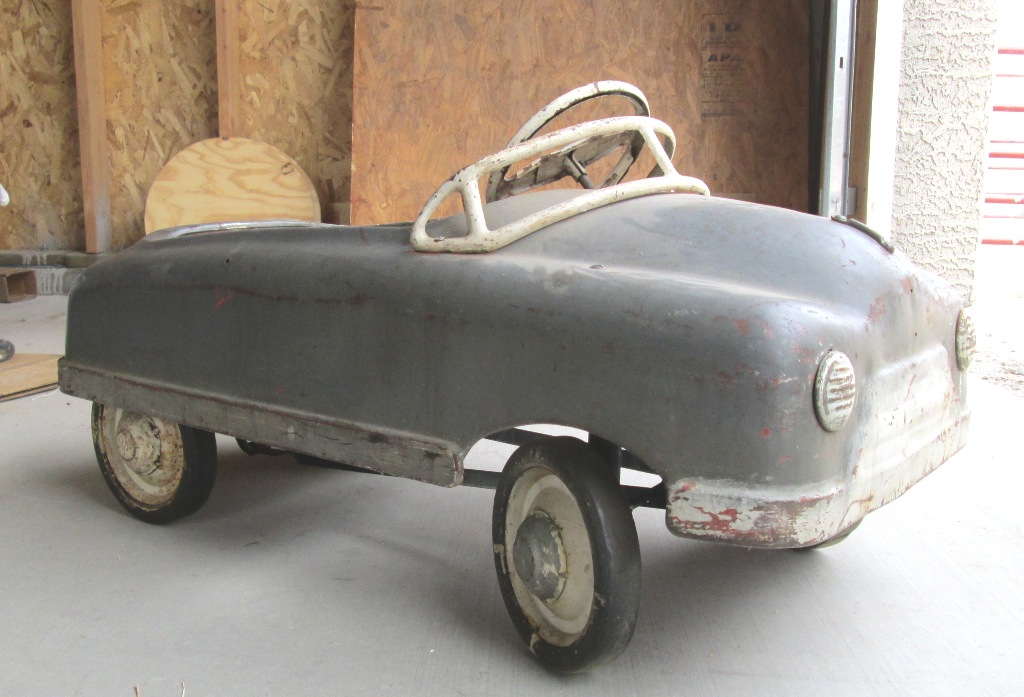

Report post Posted November 10, 2015 I will admit it has been many years since I used the Purple Power because at that time I didn't think it worked as good on tested items.I just did some chrome using Super Clean and it took less than five minutes, and no brushing.You'll like this one. This pedal car was in the rafters for about nine years and got pretty dirty. I decided to get it down and clean it up, with Super Clean. I was amazed that the gray started coming off rather easy so I just kept spraying some on, wait a few minute and scrub. Took about an hour and I had it mostly red again. BeforeAfter Share this post Link to post Share on other sites

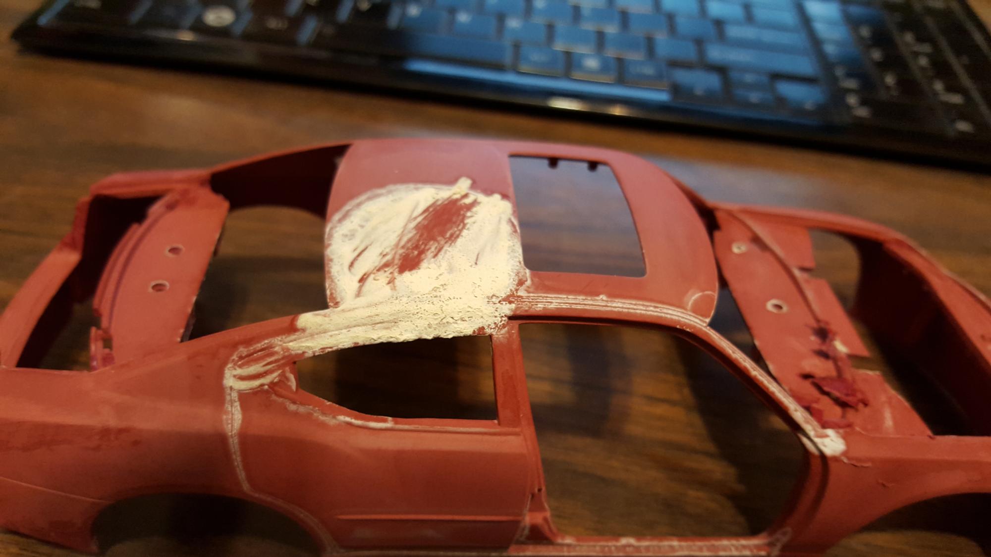

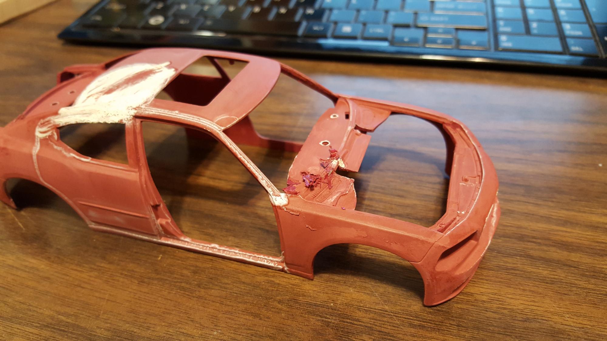

Report post Posted December 1, 2015 I wish i could get the same results some of you get, this last body is really giving me trouble. I messed up the body and the hood on this charger, left it in Super clean for about 3 weeks, eventually it managed to get through the paint, but its barely touching the primer. I had it soaking int 91% alcohol for a few days and it didnt even discolor it, Same with Brake fluid. I still have the hood soaking in it. The white blotch on top was an Easy off test. Didnt even get a speck off after rubbing it. I ended up just ordering a new body and hood. But it would be nice to figure out how to clean this up. Share this post Link to post Share on other sites
Report post Posted December 23, 2015 Well, if that body is important to you, you may want to invest in an actual hobby paint stripper.I got some dot3 at a hardware store and it didn't even do anything after a week. I think there is a new formulation. Share this post Link to post Share on other sites
