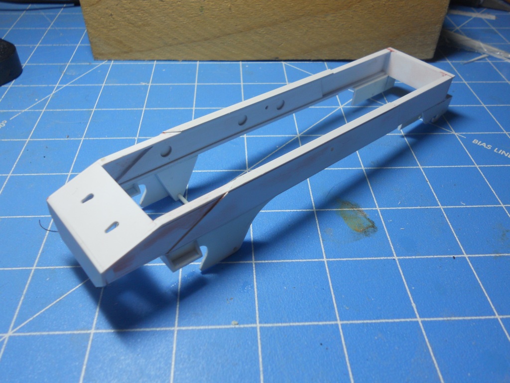

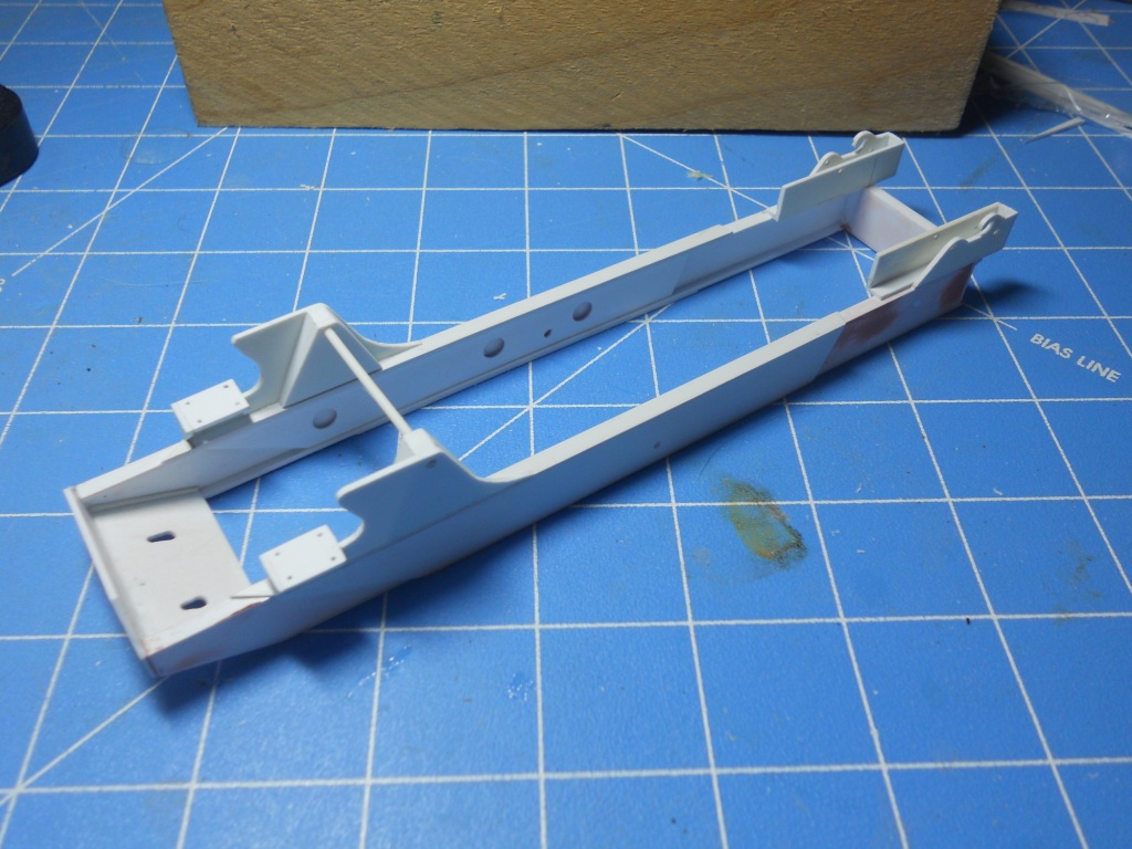

What peaked my interest is the fact that the rear axle bolts to the frame with no suspension and the cab sits level but the frame does not. Here is my start on the frame. In photo yt1 it is sitting on my multi-color line drawing. I got in a hurry and forgot to cut out the vent in the front cross member and the stop and backup light holes in the rear member. I can still fix it. It has a main frame with both inner and outer Frame stiffeners. Not perfect but it is a start. I am correcting my drawings now based on information I have since located. Always wanted one of these. I am thinking about building a Capacity model as well just to show how different they are.
