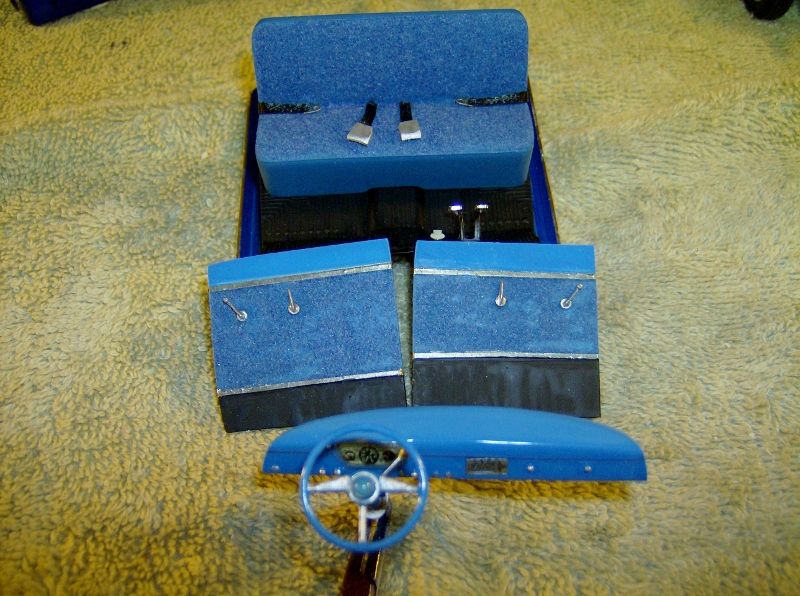

You'll have to make your own inner door panels (as has been said here) as the details molded to the interior doors are barely there. Here's how I did mine using sheet plastic, BMF & flocking...
wow, nicely done...now to just get to work
