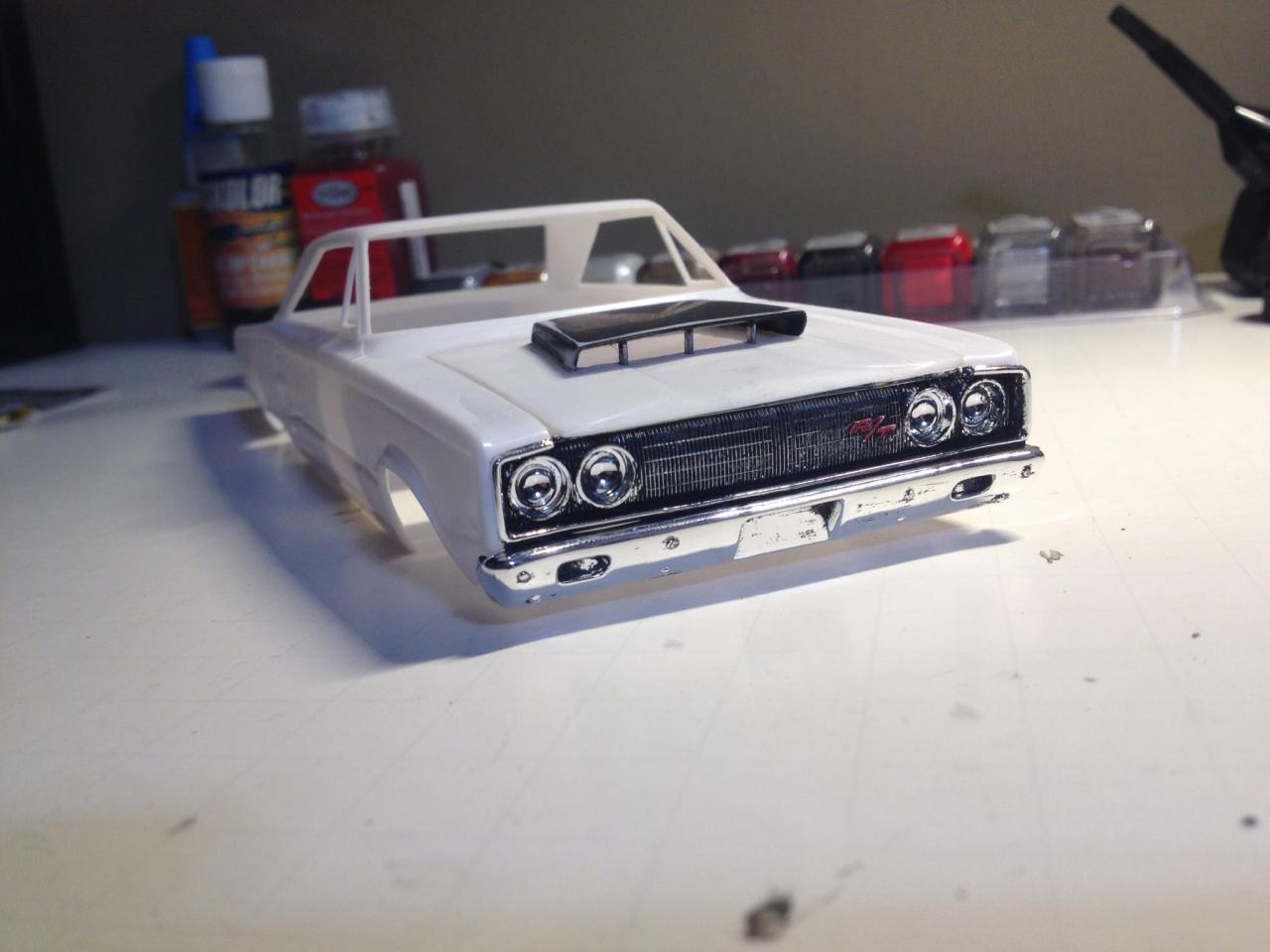

I'm new to the world of detailed modeling and desperately want to build nothing but weathered or barn find style cars. Never even tried it before but here goes nothing. I'm using ideas out of my head until I grasp some of the techniques I've seen on this forum. Always loved this body style so I grabbed it. Opting out of the chip foose design for a more 60's-70's street/race look.
post-13414-0-35641000-1392519914_thumb.j
did some test fitting with the foose wheels first and hated it.
post-13414-0-04745000-1392519981_thumb.j
added the hemi scoop from a dart kit I had.
post-13414-0-51148400-1392520030_thumb.j
added some detail to the grille.
post-13414-0-09198100-1392520124_thumb.j
laid some flat over the chrome to dial it down a bit.

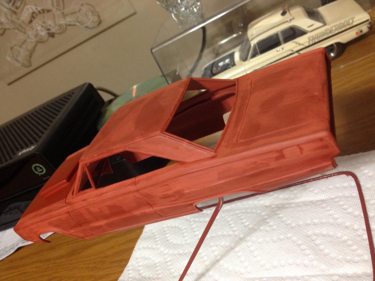

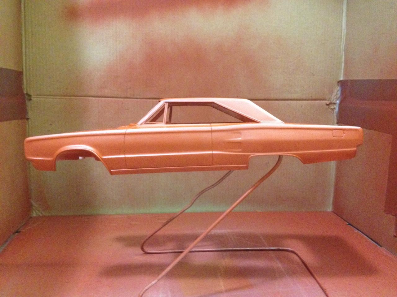

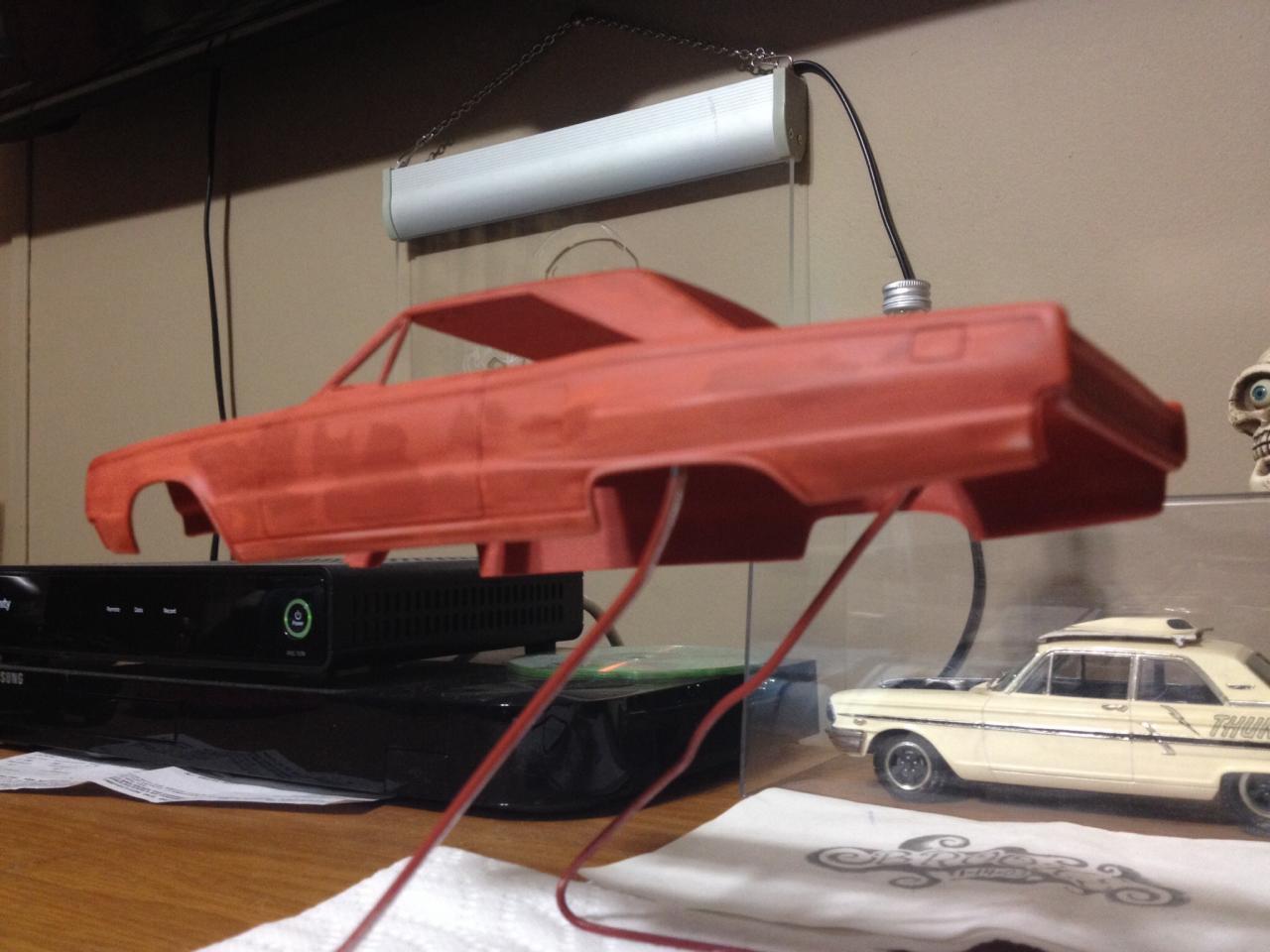

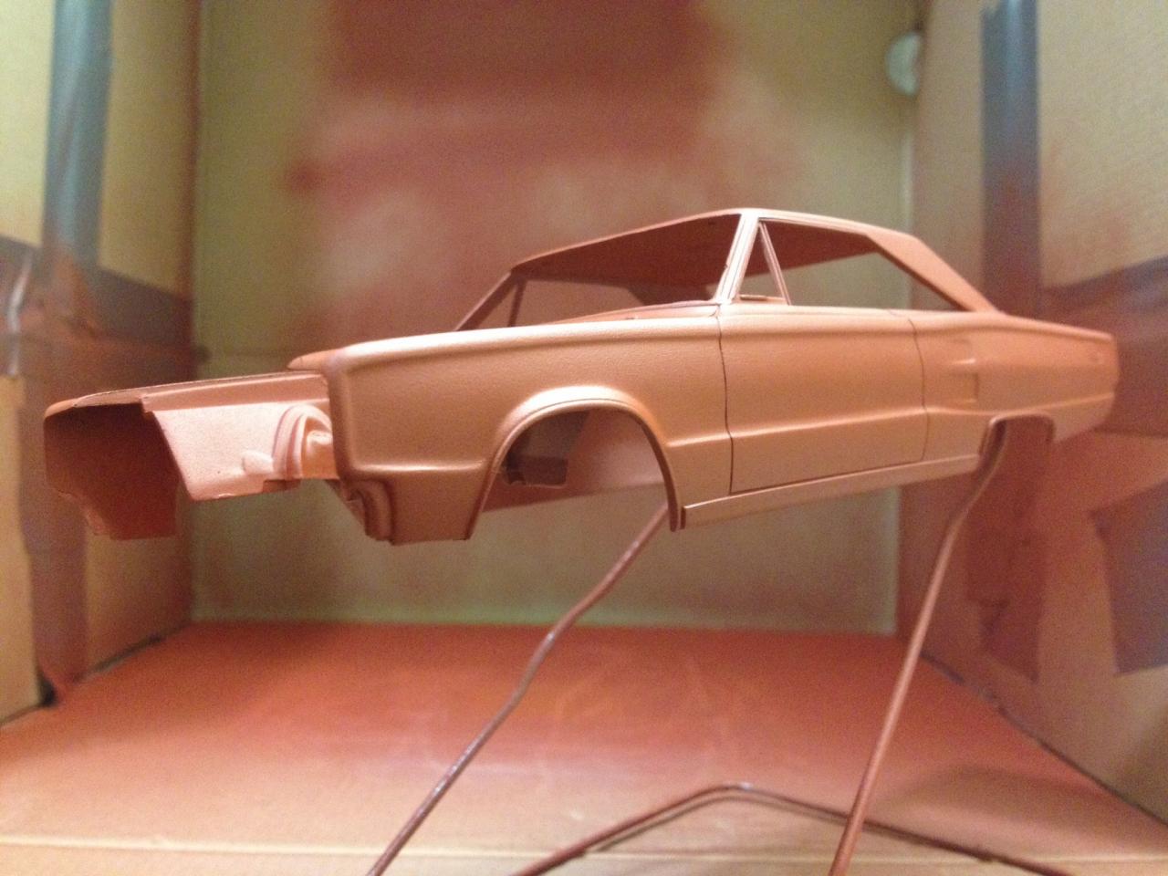

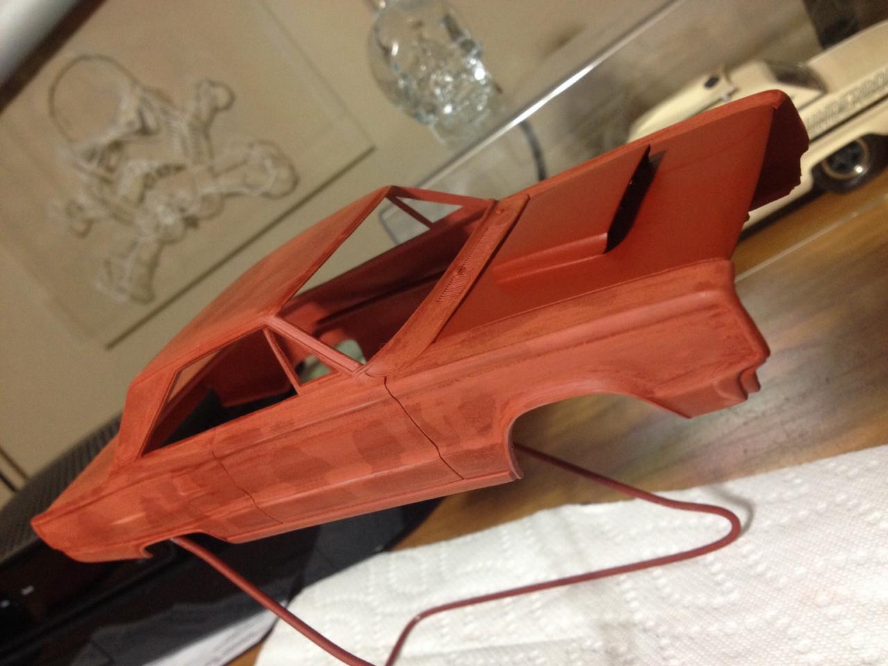

Well tonight I laid down my first primer coat aka base coat. Going to give the salt method a whirl.
post-13414-0-28593000-1392622777_thumb.j
Did a light dusting after sanding
post-13414-0-84599500-1392622833_thumb.j
So far it's laying down nice
post-13414-0-07041500-1392622894_thumb.j
After 3 light coats things are looking good. I see a couple areas that require attention that I missed during clean up like the a pillar divot in the plastic
post-13414-0-47735800-1392623021_thumb.j
Again I'm happy with the results so far. Hope the top coat and the salt method works out this nicely
Looking good brother. the salting method is a great way to show wear and tear on a model. if you have pastel chaulk i can show another method of making realistic looking rust using salt water. i have another tutorial i will be finishing up and then i will get to work on the salt water rust if interested
Thanks man. I would love to see your tutorial. I'm hoping to get some chalk this weekend. But I will keep my eyes peeled for any weathering technique I can learn from.

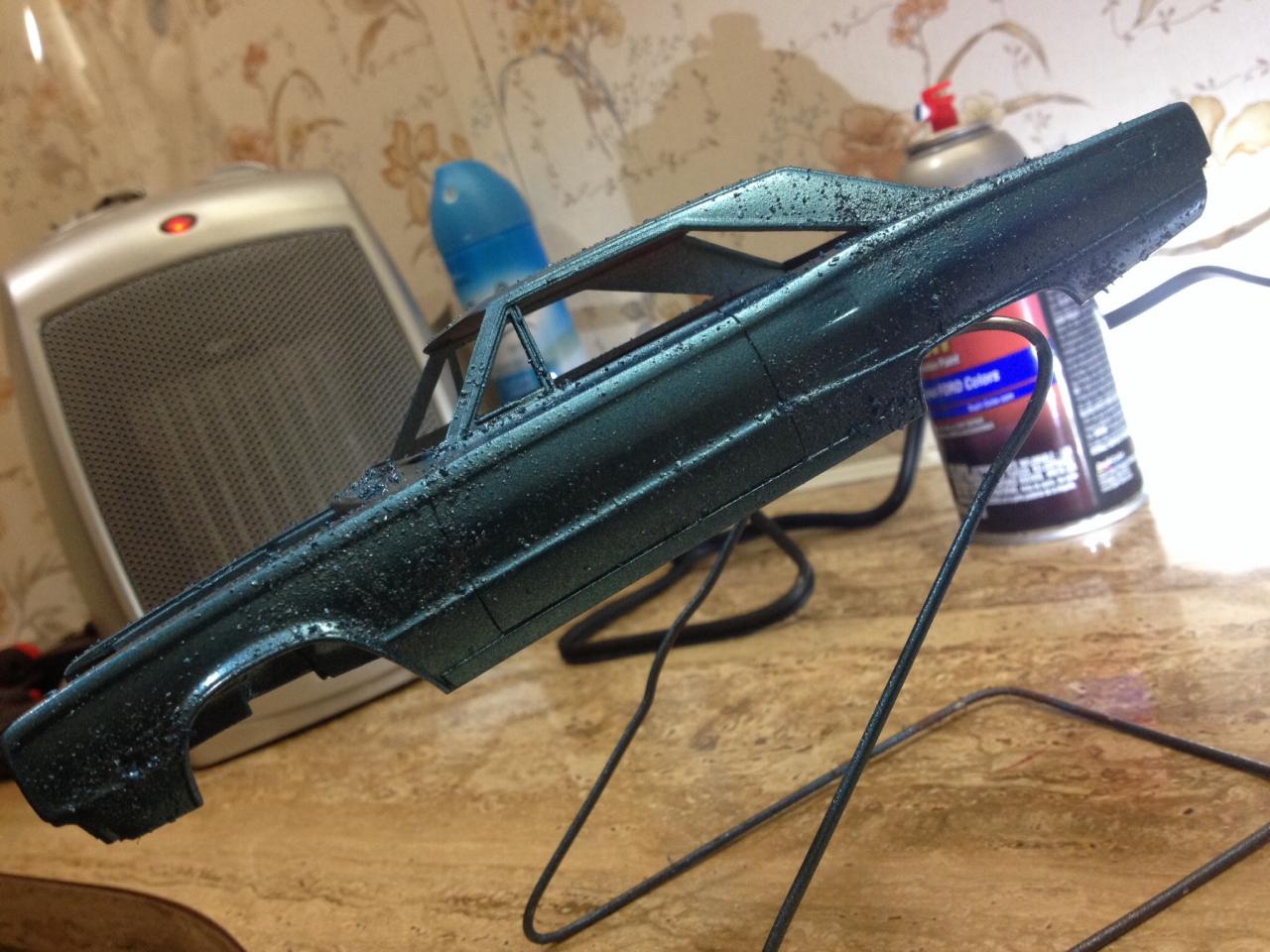

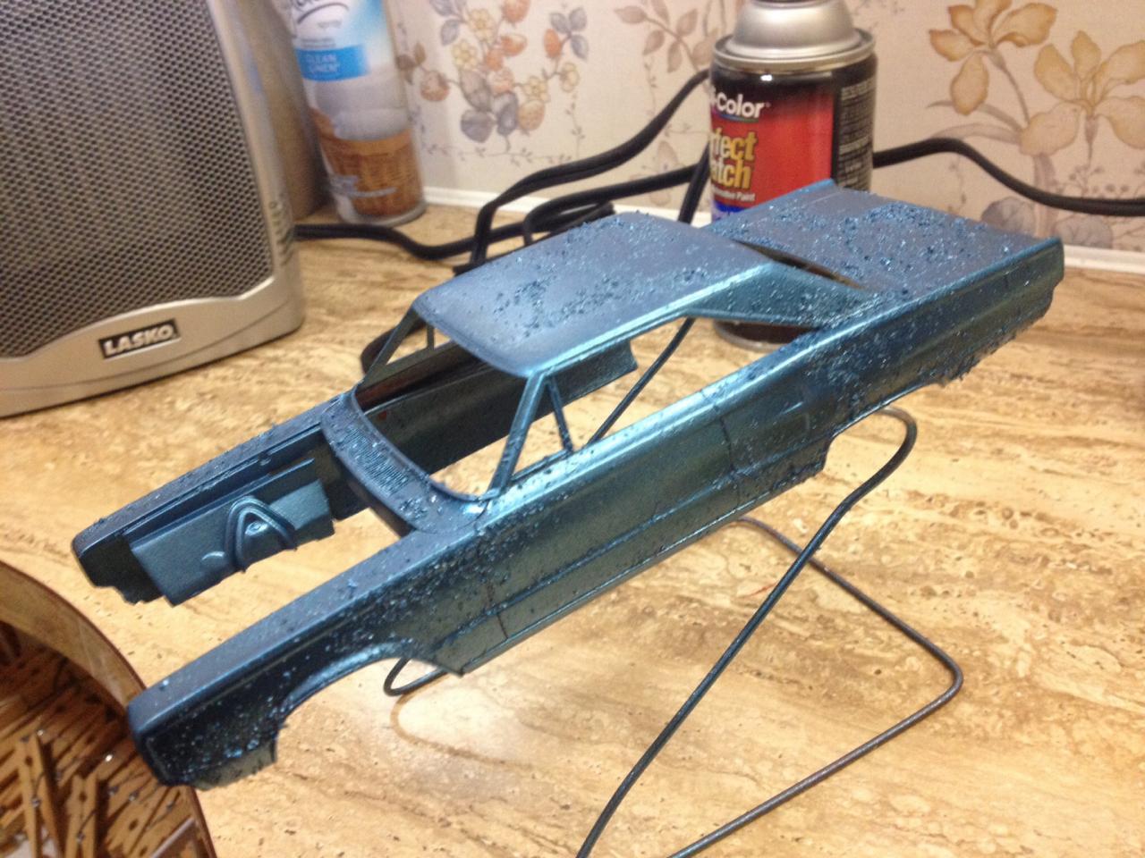

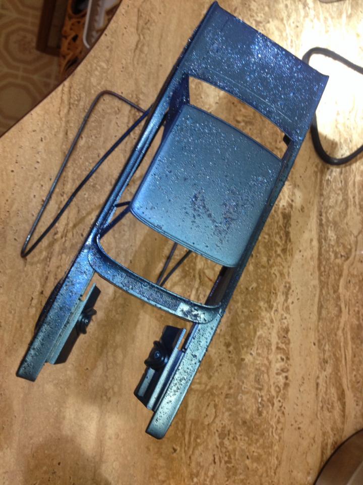

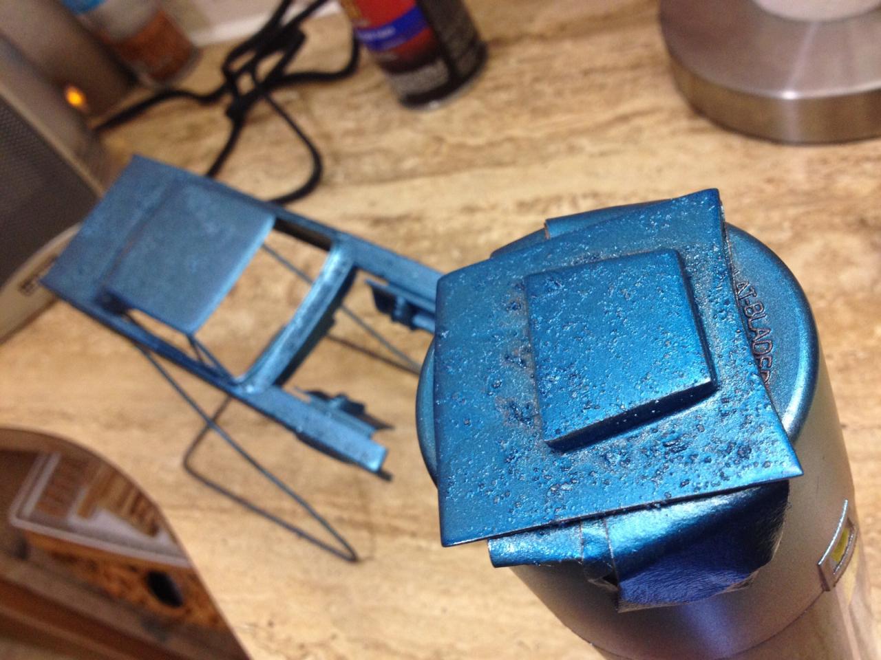

Well I think I'm pretty much ready to add salt. Don't have an airbrush yet so it's all rattle can. Hoping I don't get over excited and lay down too much salt and top coat. We'll see how it goes from here. So far I'm still happy with it. After I lay the salt I will start working on rest of interior. Wish me luck.
post-13414-0-56374000-1392764070_thumb.j
post-13414-0-51757800-1392764090_thumb.j
post-13414-0-07319400-1392764115_thumb.j
These were before I sanded the hood. I'm happy with how the seems on the hood look. What do you think?

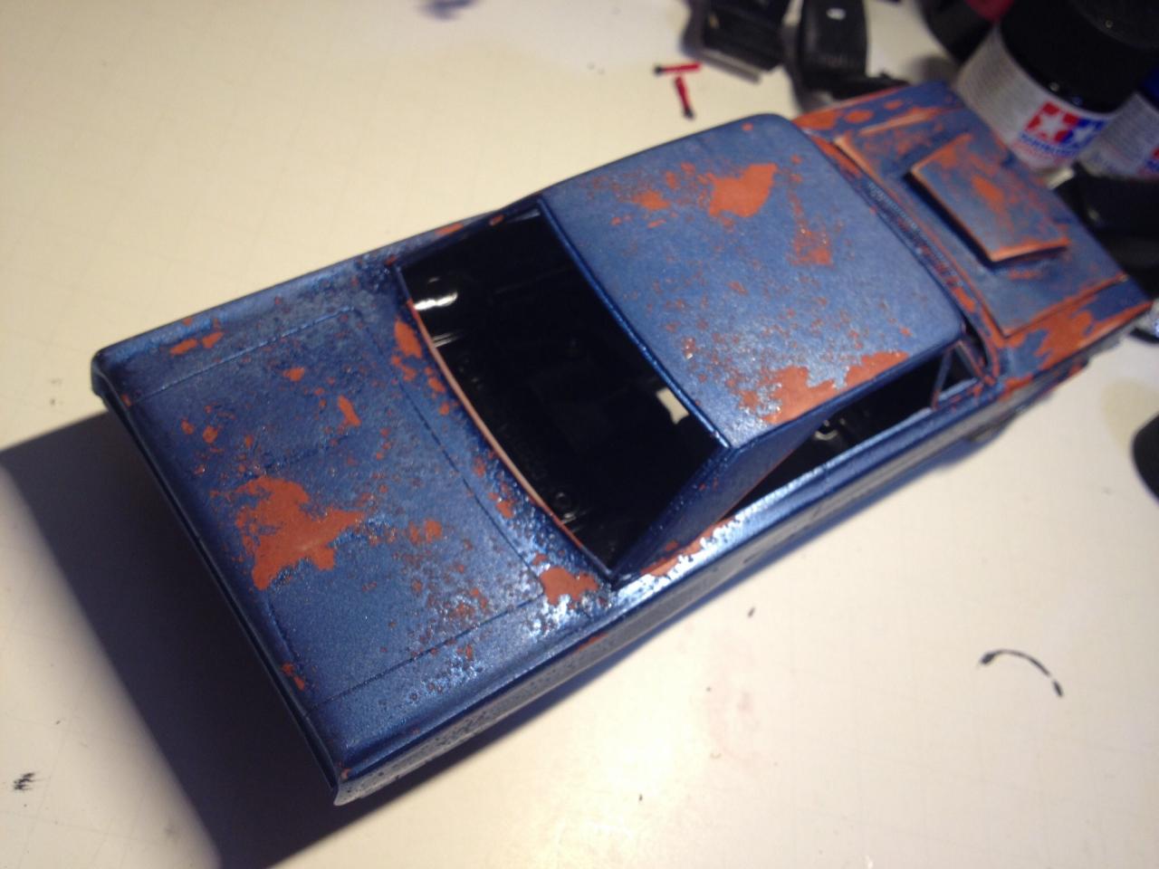

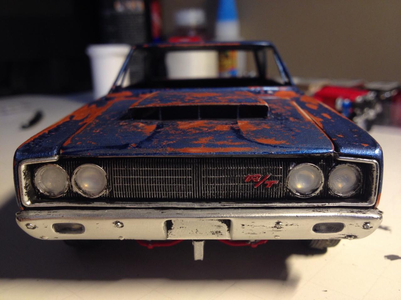

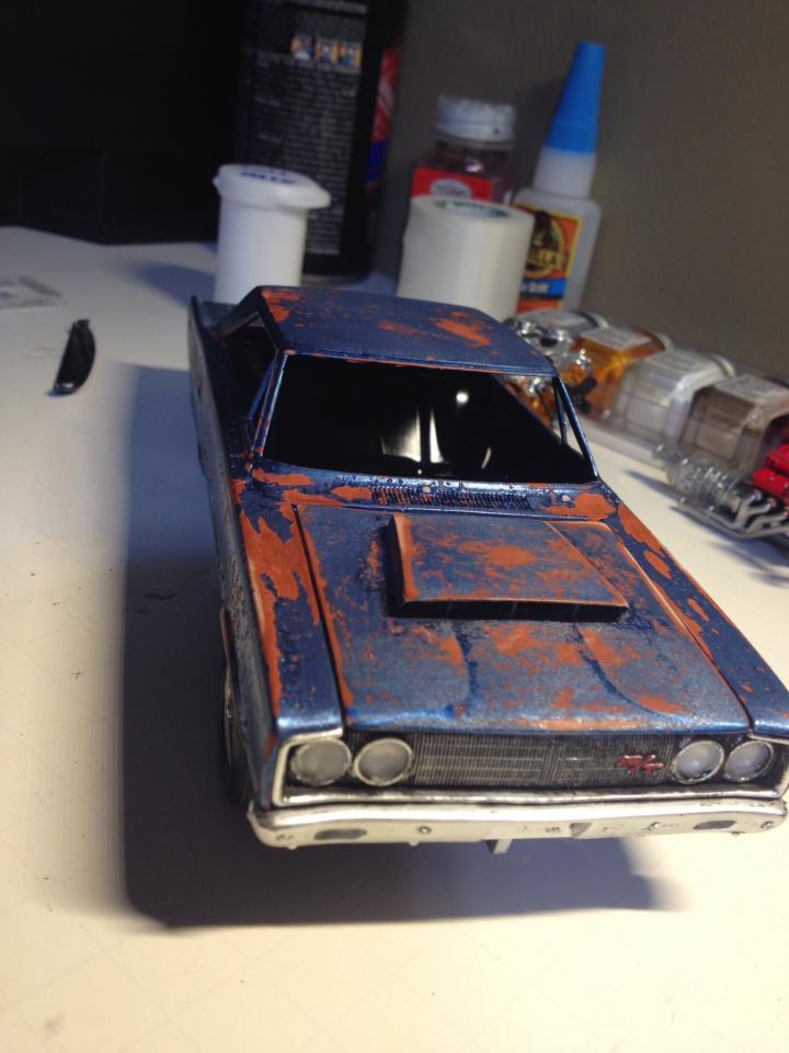

As I'm a very impatient man I had to rush the process a bit. Baked the body to cure the paint and started beating it up to remove the salt. For my first time I couldn't be happier with the results. I'm hoping to get some chalk and some sort of rusting agent to add more detail but this is what I have so far... Please give me honest opinions.

thats lookin good! salt works great, i use it all the time.......so does hairspray, and believe it or not......silly putty!
i usually just rub the salt off with a soft brush and some warm water right after the paint has "flashed" it will give it that "peeling" look, there will be actual flakes of paint barely hangin on.....but im impatient, LOL
keep up the good work, youre doing great!
