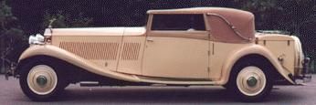

sjordan2 Posted July 6, 2015 Share Posted July 6, 2015 (edited) Your body modifications are sleeker and more stylish than the Pocher kit, which seems to have been influenced by Barker and Hooper Sedanca/cabriolet coachwork, and a bit closer to a Gurney-Nutting Phantom II Continental. This is the Gurney-Nutting car that Revell's 1/16 kit is based on. I might add that threads like this and some that Harry has done are invaluable to any modeler who wants to build a classic Rolls in any scale, especially a PII. Edited July 6, 2015 by sjordan2 Quote Link to comment Share on other sites More sharing options...

Cato Posted July 7, 2015 Author Share Posted July 7, 2015 Thank you Skip and Mike. Nice to have your support. Yes Skip your example photo of 201 RY has been a huge influence on me. No stock Pocher kit captures the low roof line, dead level hood line and level louvers; something very hard to do on a Pocher. I'm not making an exact Gurney replica but taking all the classic cues with a little of my own expression. I'm about 90% there with the main architecture. Quote Link to comment Share on other sites More sharing options...
