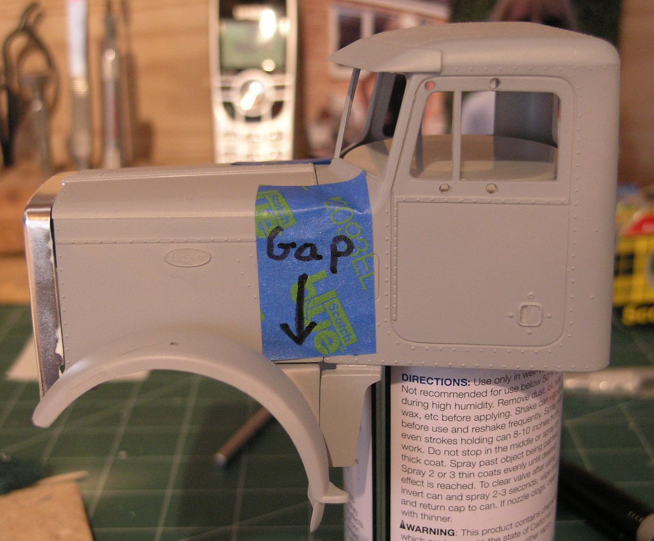

Old Buckaroo Posted March 14, 2014 Share Posted March 14, 2014 (edited) I have been looking at this kit on the bench now for several days. I am hitting a stumbling block on attaching the fenders to the hood. The hood has that nice groove for them. If you position the fender all the way to the front groove it does not fit right due to the step up on the rear of the fender. If you position to where it is level there is about a .030" gap. So you guys that have built this kit what did you do about this, have the gap and fill it with a strip of styrene or did you eave the gap , Or remove some material off the step up to where it fits flush against the hood sides ? Edited March 15, 2014 by Old Buckaroo Quote Link to comment Share on other sites More sharing options...

Old Buckaroo Posted March 14, 2014 Author Share Posted March 14, 2014 (edited) Thanks Hoss, I should of known you would be of assistance. This is the gap I am referring to. I am going to go ahead and fill it with a strip of styrene. Edited March 14, 2014 by Old Buckaroo Quote Link to comment Share on other sites More sharing options...
Force Posted March 14, 2014 Share Posted March 14, 2014 (edited) Ahh I see what you mean...well I would do that too. I just bought me the first version of the AMT California Hauler 359 with a Detroit Diesel 8V-71 for a decent price, the later 359 versions has a Cummins NTC. Edited March 14, 2014 by Force Quote Link to comment Share on other sites More sharing options...
Old Buckaroo Posted March 14, 2014 Author Share Posted March 14, 2014 I traded for three of these kits, but only one is the early version with the Detroit and it has a smaller back window also. Which I think is way cooler then the later versions. I just learned from Tim that the step is wrong and should be higher up on the fender - about 3-4 scale inches. It lines up with the internal bracket on the real fender. The kit has it at the bottom. When you going to start on yours ? Quote Link to comment Share on other sites More sharing options...
