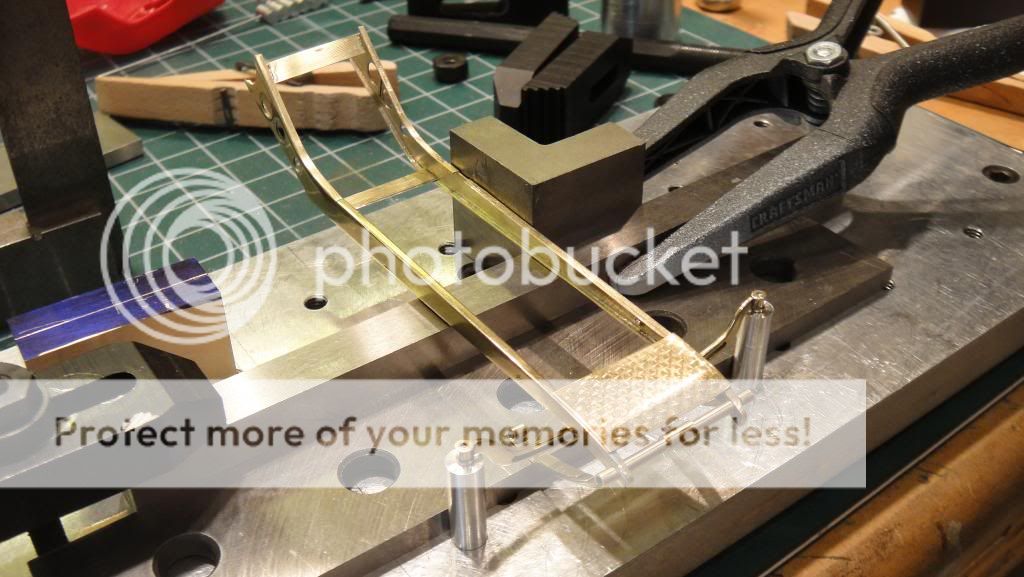

Here is a photo of a jig I made for soldering the axle to the spring assembly on the chassis of a hot rod. As you can see it is quite complex, but I needed to get the bearings as close to vertical and parallel as possible so that the wheels will sit square. It also uses machining parallels on a milling table to keep everything as square as possible.

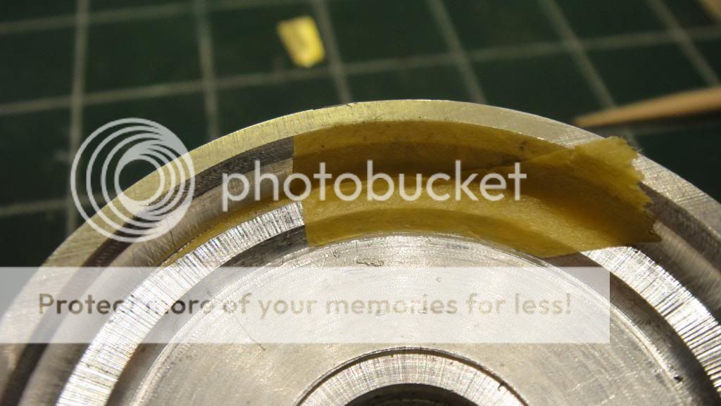

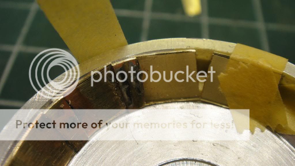

Here is another jig I made to solder several pieces together in an arc at a set angle. Here I used the heat sink properties to my advantage. I took a piece of Tamiya masking tape and put it on my half of my jig. I would solder on the part of the jig that had the tape on it and then move the newly soldered part so that it was on the untaped part, in direct contact with the aluminum and then place the next part to be soldered over the taped portion. The taped part would get hot enough to solder and the untaped part stayed cool enough to not remelt the prior solder joint.

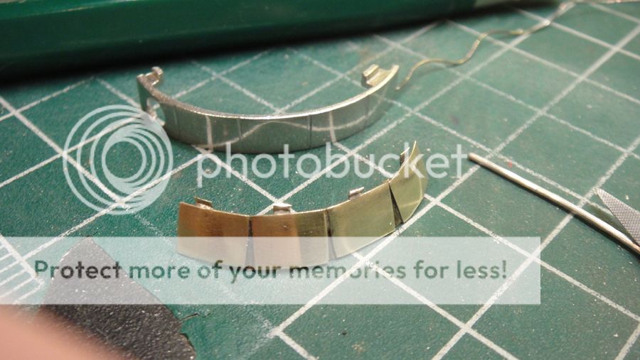

Oh, by the way, I thought you might like to see the final piece that came out of the jig I mentioned above. It is a set of cowl flaps for a radial aircraft engine I am building.
