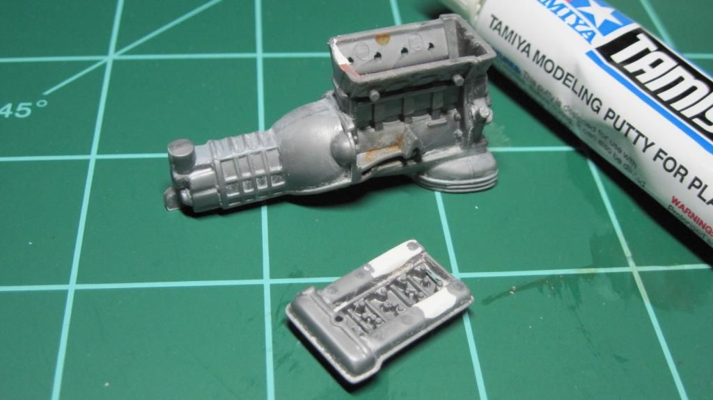

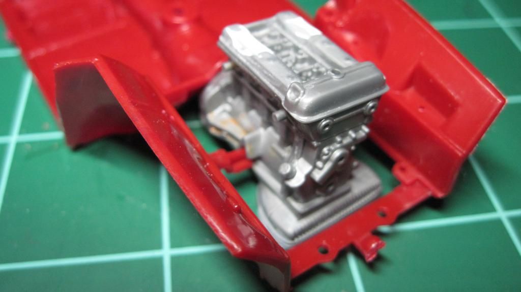

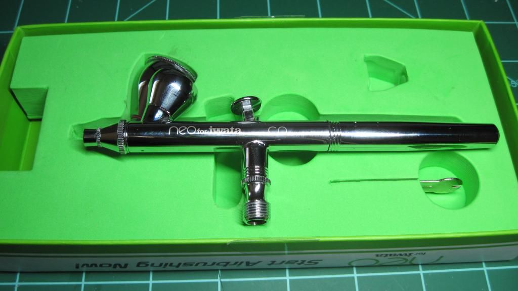

mikevillena Posted April 18, 2014 Author Share Posted April 18, 2014 Thanks guys. @ Skip - I know I'll never get to own one, let alone a real GTA as those are rarely on the market and those that do fetch six figures. Made a quick trip to Hobby Lobby and snagged one of these for 38.99 using their 40% off coupon: Should work a little better than the Harbor Freight one that I bought last year. Did more research and decided to check working clearances for the hydraulic pump: Looks like there will be enough room for the supercharger system after all. Next step is to modify the front engine cover to add the cast pump drive. Quote Link to comment Share on other sites More sharing options...

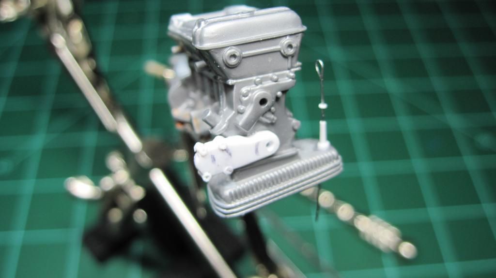

mikevillena Posted April 19, 2014 Author Share Posted April 19, 2014 Well it has literally been decades since I last attempted to scratchbuild anything in 1/24th scale and what little skills I had are long gone so things are crude: Everything will be blended in with some spot primer and additional surface details will be added to the hydraulic pump drive housing. The functional oil dipstick was fabbed out of some cheap necklace wire I bought at Wal Mart whilst everything else is styrene. Back to the bench. Quote Link to comment Share on other sites More sharing options...

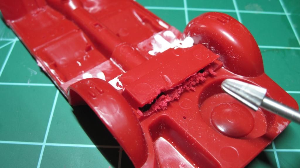

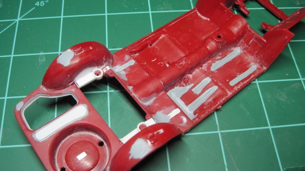

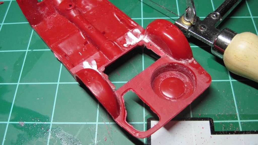

mikevillena Posted April 20, 2014 Author Share Posted April 20, 2014 Managed to find a few reference photos of a GTA being restored from the frame up. Since I'm modeling a stripped down bare bones car with just the drivers and front passenger seat, it looks like I will have a ton of work duplicating the internal structures. The area behind and under the rear seats on the model is totally inaccurate since it was intended to be covered with the rear bench. Time to start hogging out the plastic: I have forgetten what an incredible mess it is to grind and sand styrene as there is work dust all over the place. After a fair amount of grinding and sanding, I managed to level out the rear platform so that I can start building out the rear structure. I will also be detailing the trunk and installing a scratch built fuel cell so I had to cut out the stock fuel tank: I also decided to detail the instrument panel and add depth to the instrument facia. I drilled and reamed out the shallow instrument faces as I will install a backing plate that will carry the decals and will be topped off with a thick clear coating to add more depth. Time to stop and vacuum up the workbench as there is styrene dust all over! Quote Link to comment Share on other sites More sharing options...

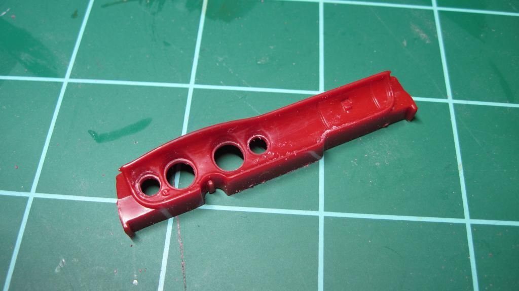

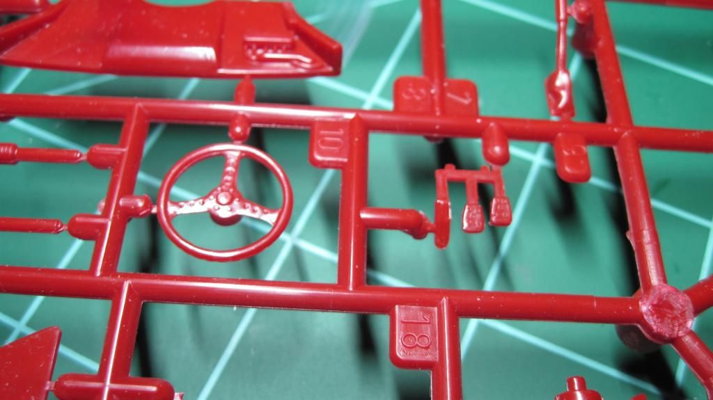

mikevillena Posted April 20, 2014 Author Share Posted April 20, 2014 (edited) BTW, can anyone else spot what's wrong with this picture? Also note the slight misalignment of the mold halves and the flash around the parting lines. Edited April 20, 2014 by mikevillena Quote Link to comment Share on other sites More sharing options...
om617 Posted April 20, 2014 Share Posted April 20, 2014 The scratchbuilding looks good in my eyes. Wrong,are you refering to the pedals? The Gulia have standing pedals. Quote Link to comment Share on other sites More sharing options...
mikevillena Posted April 20, 2014 Author Share Posted April 20, 2014 The scratchbuilding looks good in my eyes. Wrong,are you refering to the pedals? The Gulia have standing pedals. Thank you Tommy. Ah, you are correct as I didn't even look at the instruction sheet Quote Link to comment Share on other sites More sharing options...

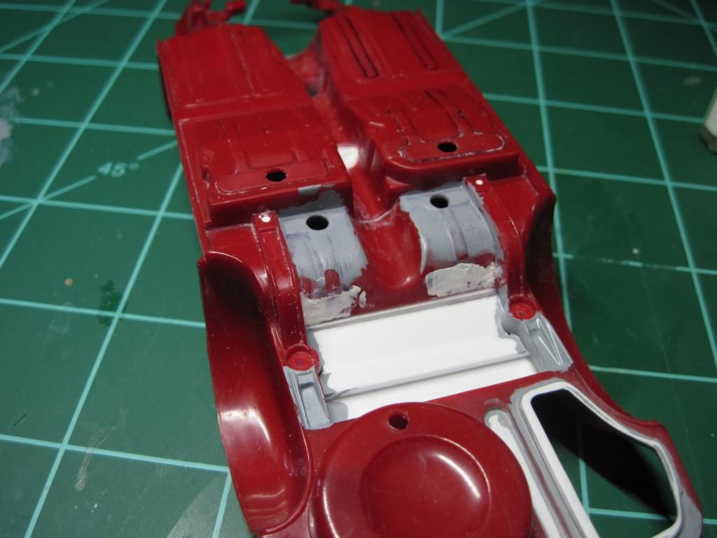

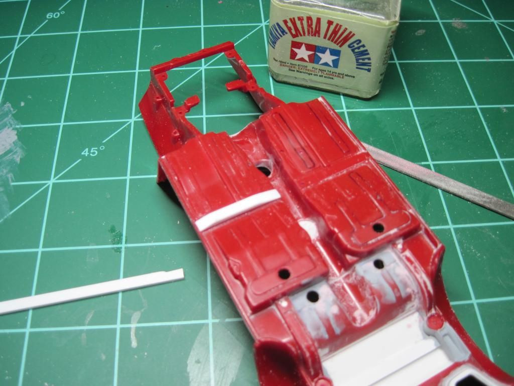

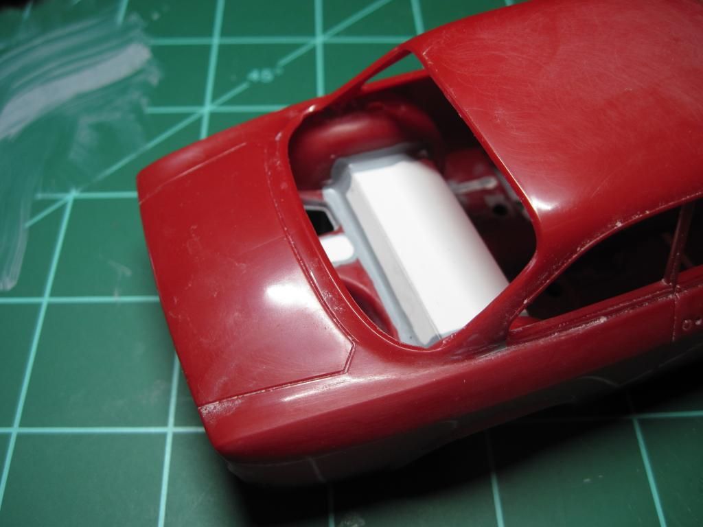

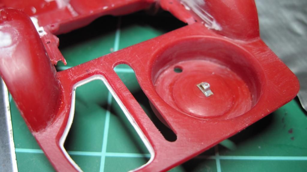

mikevillena Posted April 20, 2014 Author Share Posted April 20, 2014 (edited) Well, very small incremental progress. Since the trunk will be hinged (along with the doors) I'm going to have to add alot of missing details. I built up the opening around the fuel tank cutout and it will ultimately accept a scratch built ATL fuel cell. I also added the spare tire mounting bracket as this is supposed to be a marginal "road" car capable of carrying a spare. I also drilled out the drainage holes and I will leave them unplugged. Anyway, I wish everyone a Happy Easter! Edited April 20, 2014 by mikevillena Quote Link to comment Share on other sites More sharing options...

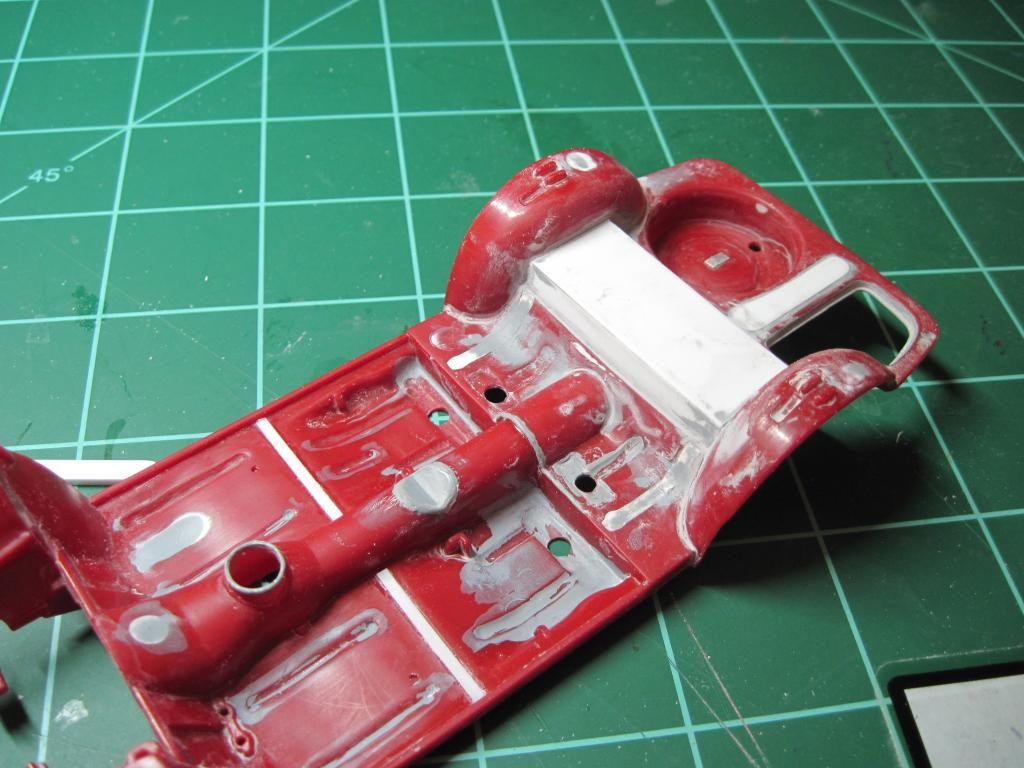

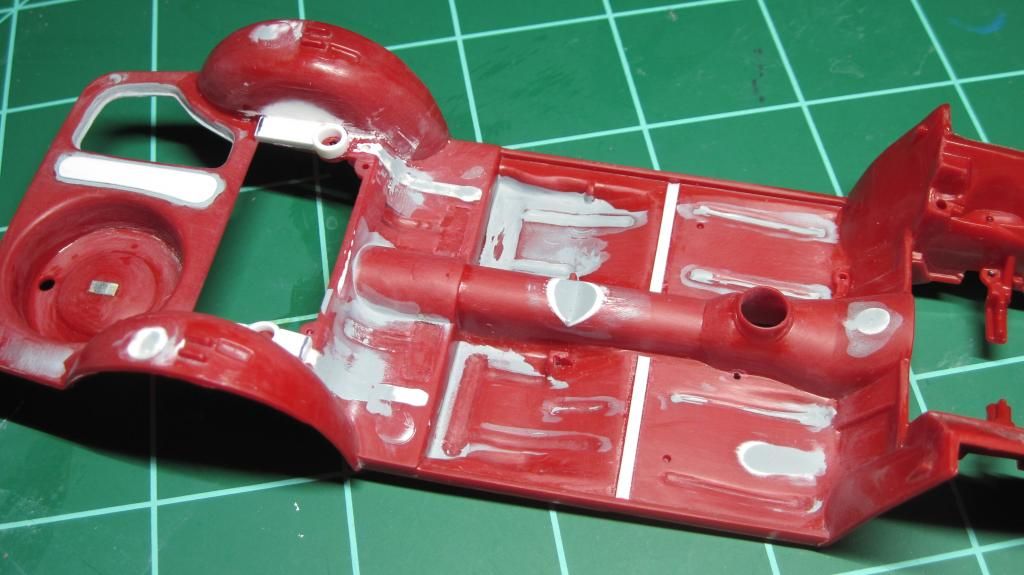

mikevillena Posted April 21, 2014 Author Share Posted April 21, 2014 A little more progress on the build. Since the cockpit will be bare sans carpeting, the floor will be completely visible. After checking my refernce photos, I realize that I'm going to have to engrave a lot of the missing details. I first had to scrape and sand numerous ejector pin marks on the floor. I then used a small ball cutter with my flex shaft toll set to almost stalling to do the engraving. The details are slightly wonky but I think they won't be too noticable. I just wish I had a set of riffler files to make the job easier and get crisper lines. I've also started building up the area over the rear axle: The molded fuse box was ground off of the firewall and I started marking off and planning additional surface detail to be added; Quote Link to comment Share on other sites More sharing options...
mikevillena Posted April 22, 2014 Author Share Posted April 22, 2014 Slow progress: Finished carving the floor details. Will have to re-prime to help me even out the grooves. Also modified the tunnel cap for the hand brake based on my reference photos. Quote Link to comment Share on other sites More sharing options...

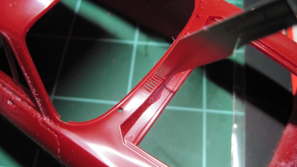

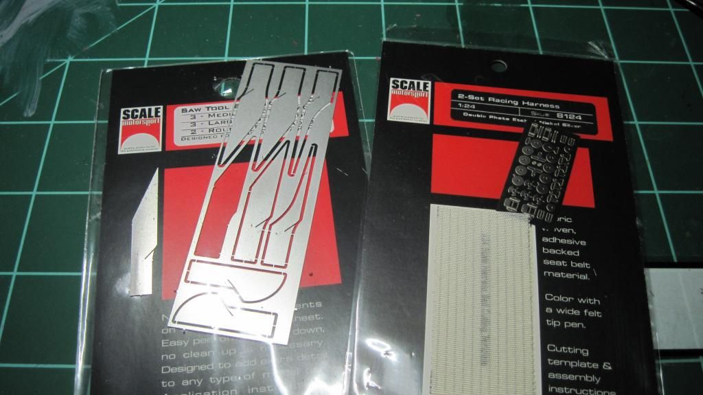

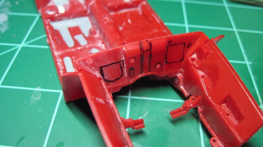

mikevillena Posted April 22, 2014 Author Share Posted April 22, 2014 Received some things I ordered from Scale Motorsport a few minutes ago. Can't wait to try them out: Started the bodywork by opening the vents: This will take a while.... Quote Link to comment Share on other sites More sharing options...

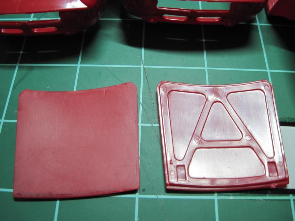

mikevillena Posted April 22, 2014 Author Share Posted April 22, 2014 (edited) Vents cut open: Ground off the molded details on the hood undersides and shaved the hood to the correct scale thickness: I will be scratchbuilding the hood support structure. Quick side by side comparison between the build and the box stock: Edited April 22, 2014 by mikevillena Quote Link to comment Share on other sites More sharing options...

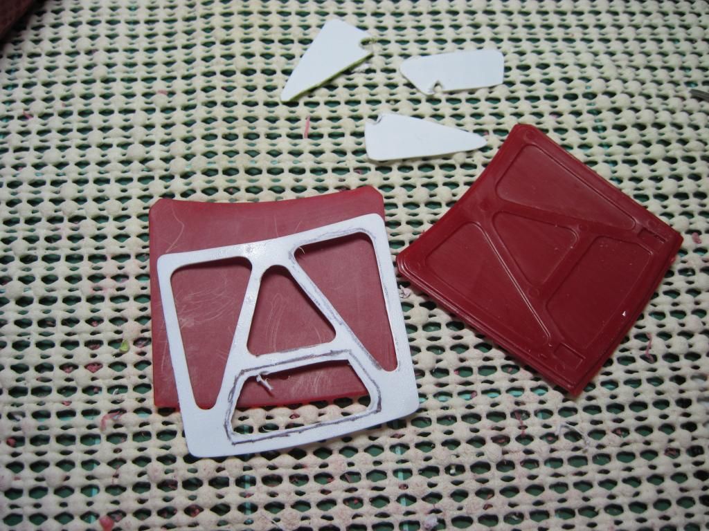

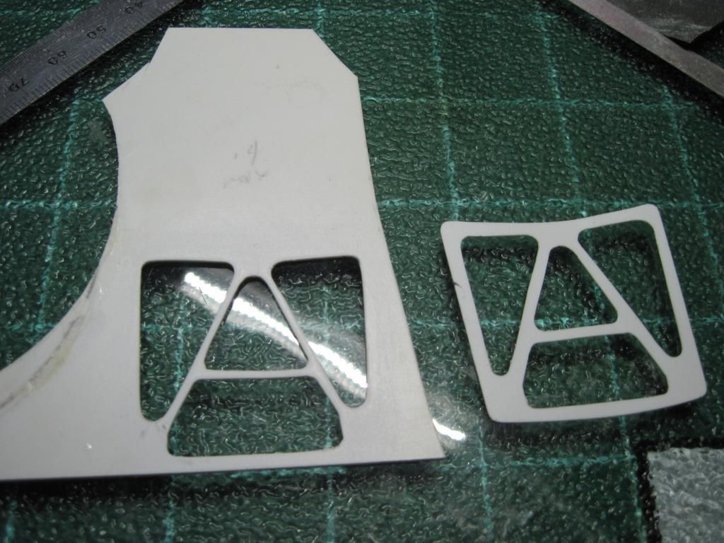

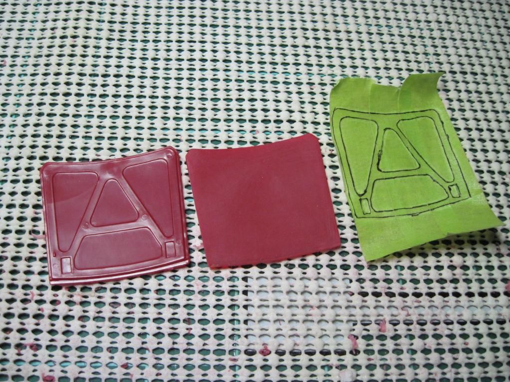

mikevillena Posted April 23, 2014 Author Share Posted April 23, 2014 Decided to tackle the needed details on the hood's underside. Used the spare kit's stock hood to make templates: I didn't have any .010 Evergreen so I had to use .015: Used .030 to make the second layer: Still needs a lot of trimming and sanding. The additional depth should add to the realism. Quote Link to comment Share on other sites More sharing options...

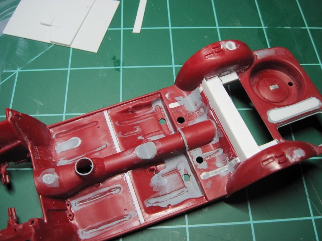

mikevillena Posted April 25, 2014 Author Share Posted April 25, 2014 Nice progress,i look forward to you start on the engine. Thank you Tommy! I'll resume work on the engine after I've tackled the additional details and mods on the chassis/unibody. Slow progress: Quote Link to comment Share on other sites More sharing options...

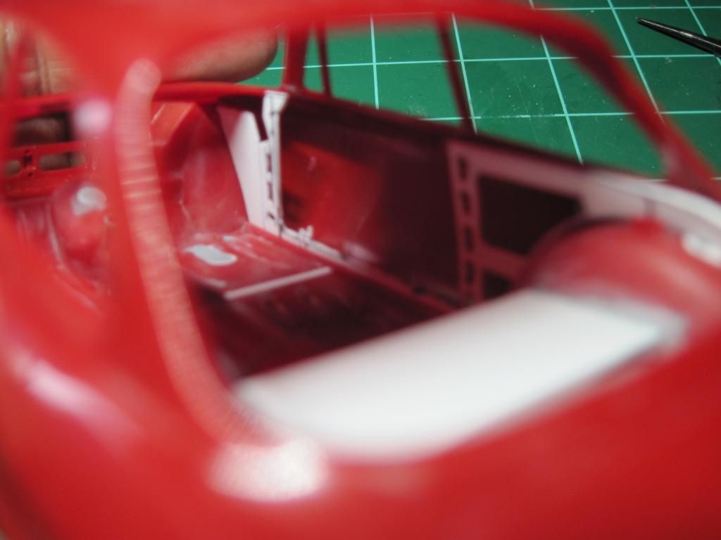

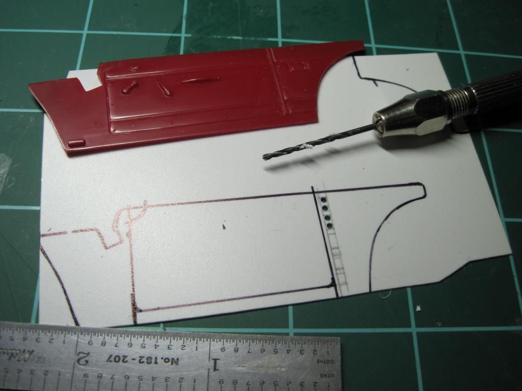

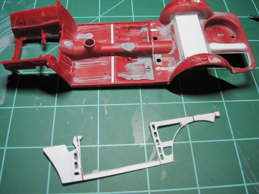

mikevillena Posted April 26, 2014 Author Share Posted April 26, 2014 Began fabricating the internal side structures of the unit body. Used the kit's interior side panels as template: Rough trimmed: Test fit: More sanding and trimming to get it right. Quote Link to comment Share on other sites More sharing options...
