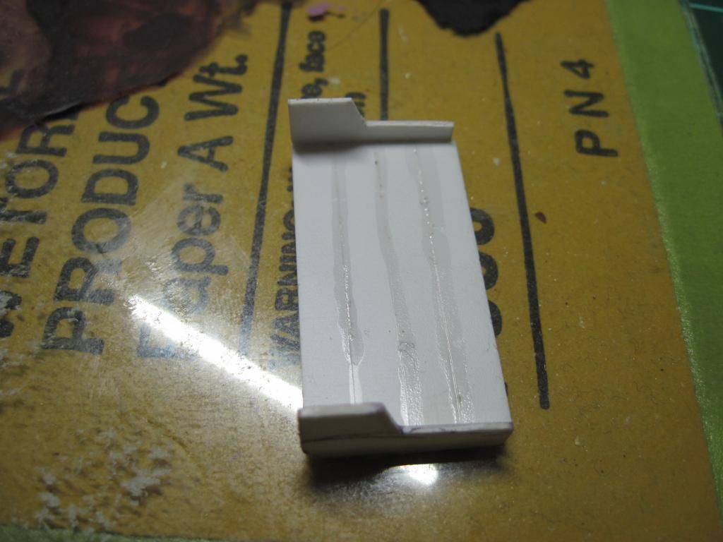

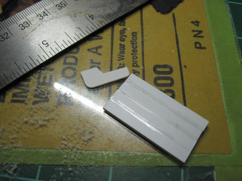

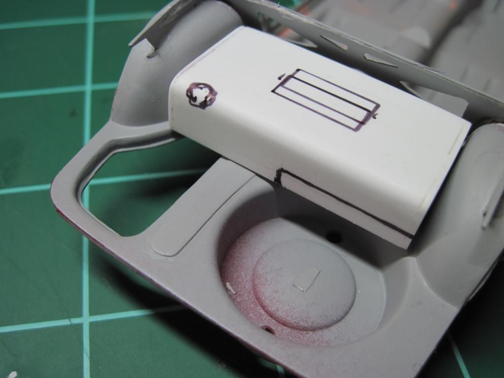

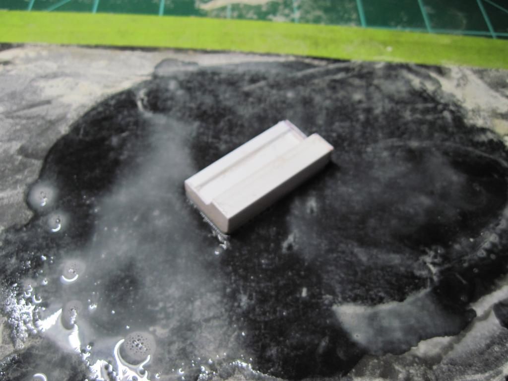

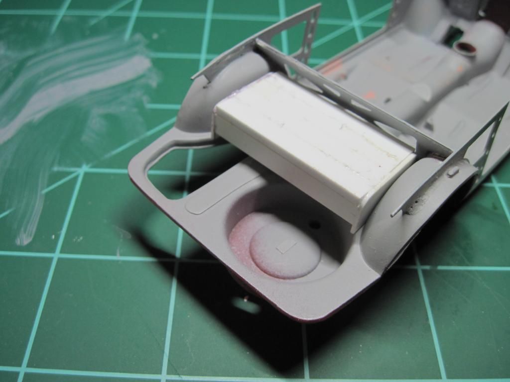

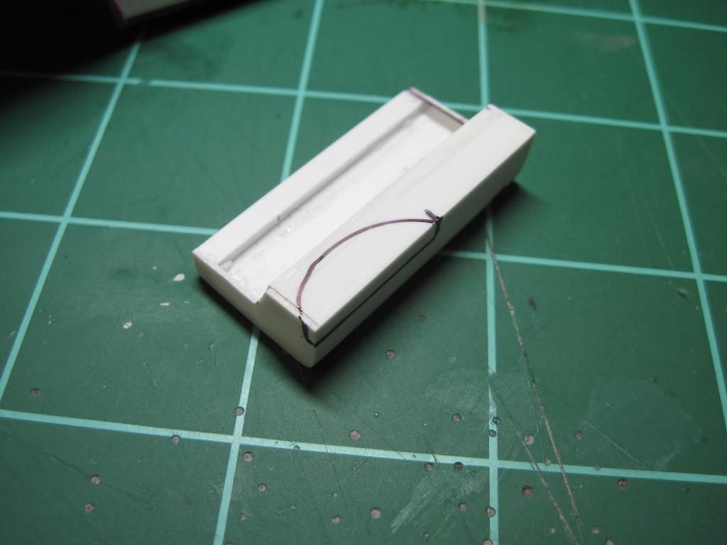

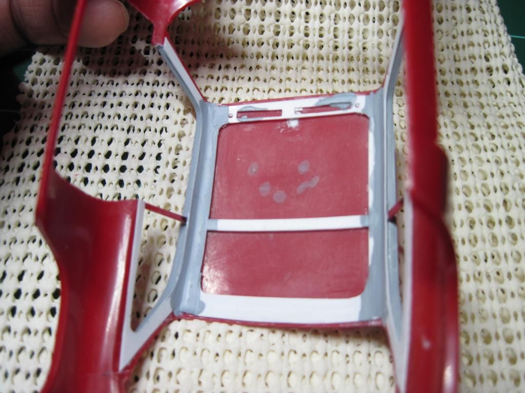

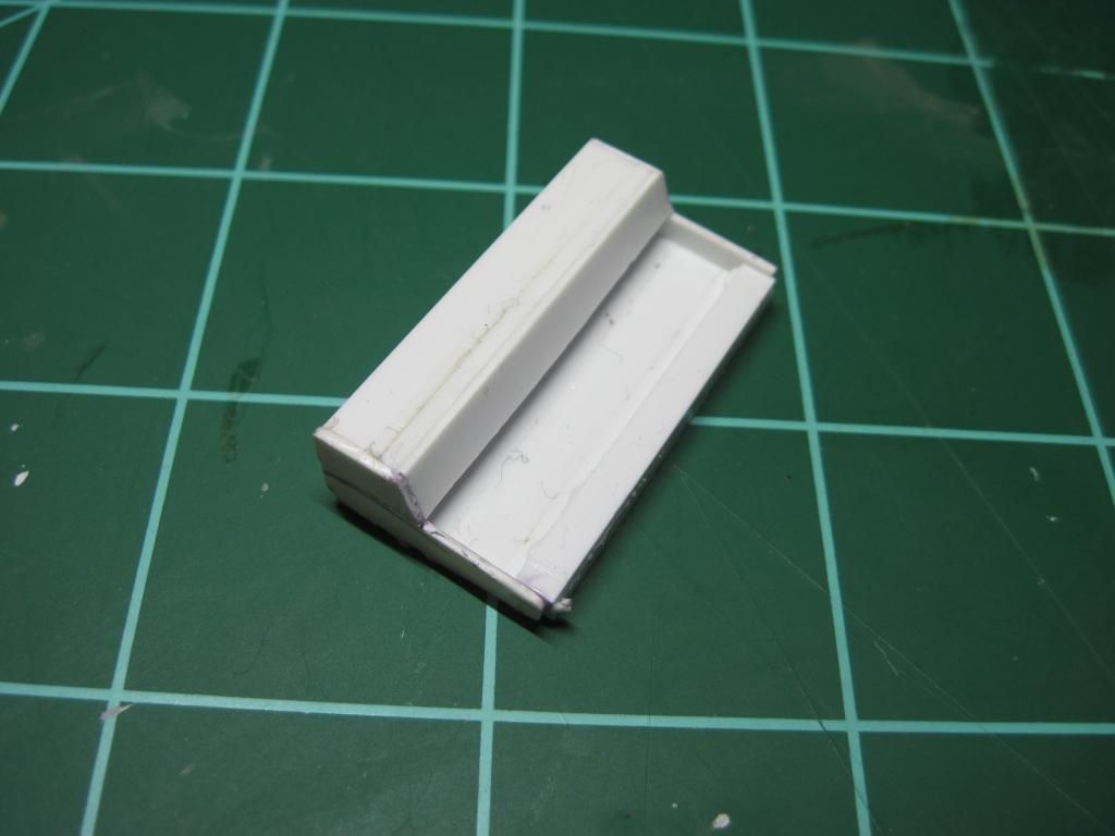

mikevillena Posted May 7, 2014 Author Share Posted May 7, 2014 After several coats of filler/primer on the roof structure were applied, the bodyshell is set aside to throughly cure overnight: I decided to go with a custom fuel cell as that seems to be quite common in race prepped cars. The tank is positioned close to or directly over the rear axle to help improve and maintain weight distribution: Quote Link to comment Share on other sites More sharing options...

afx Posted May 7, 2014 Share Posted May 7, 2014 Mike very impressed with your work. What I like to do with a super detail build is appreciate each step or sub-assembly. I try to take satisfaction and a sense of accomplishment from each step. It helps me to be patient and remain enthusiastic about the build. Your excellent fuel cell for instance is a model in and of itself. Keep up the great work! Quote Link to comment Share on other sites More sharing options...

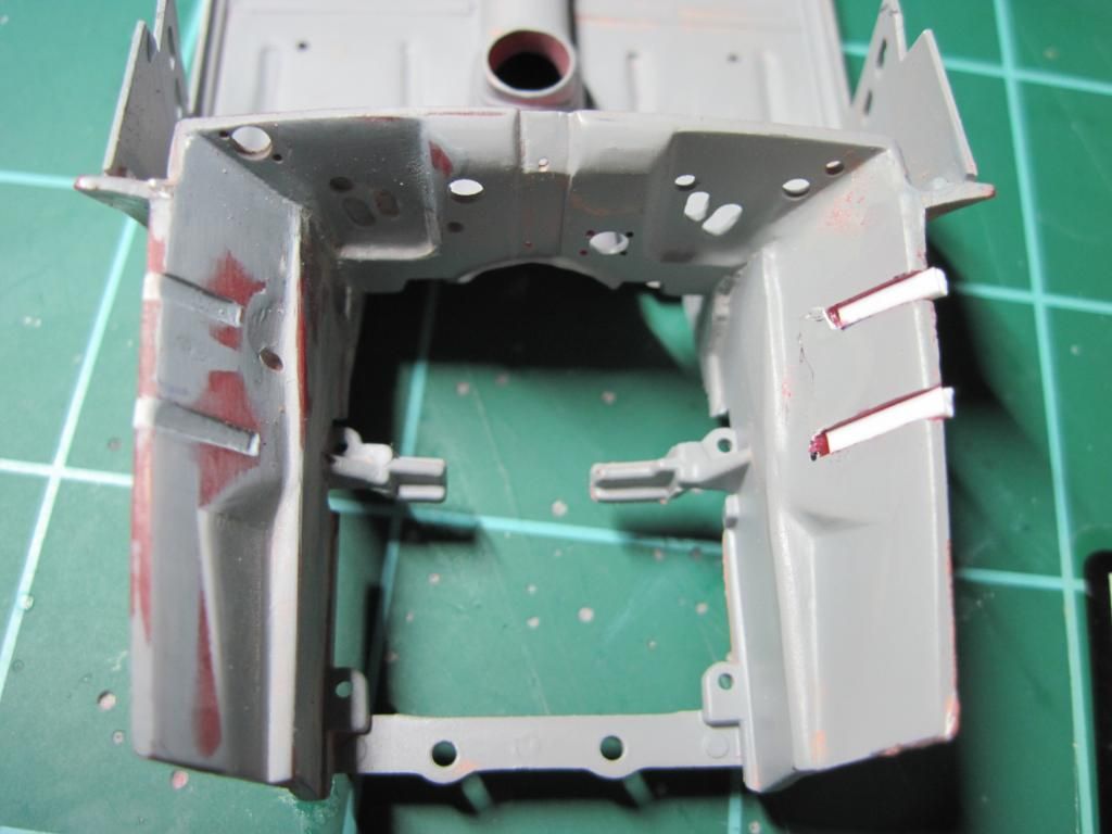

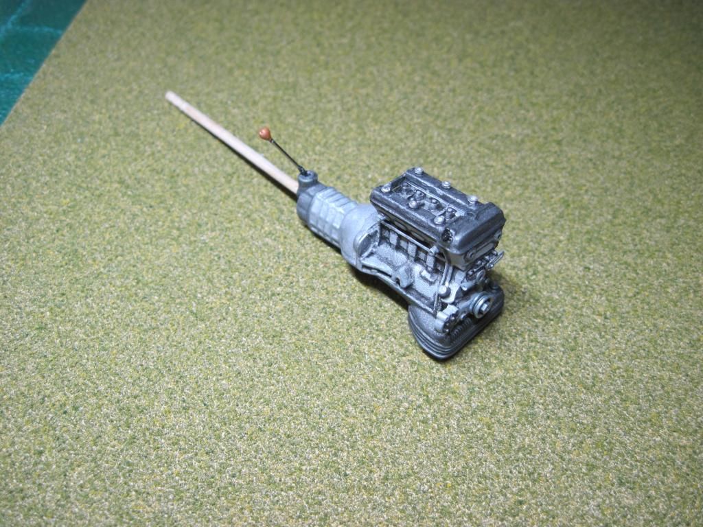

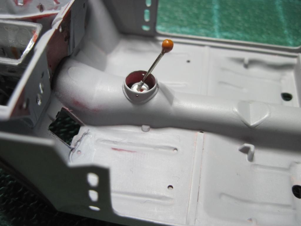

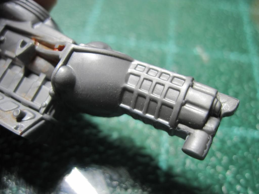

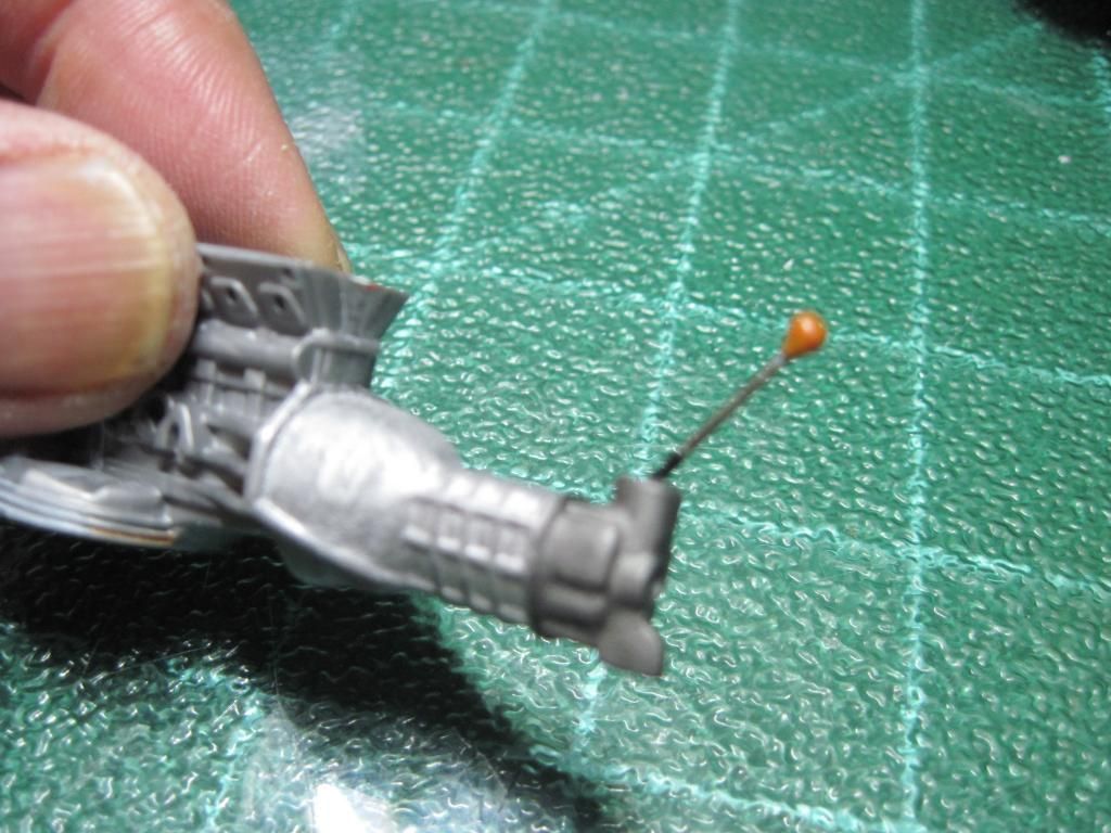

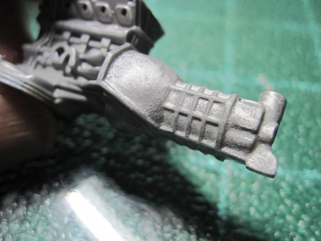

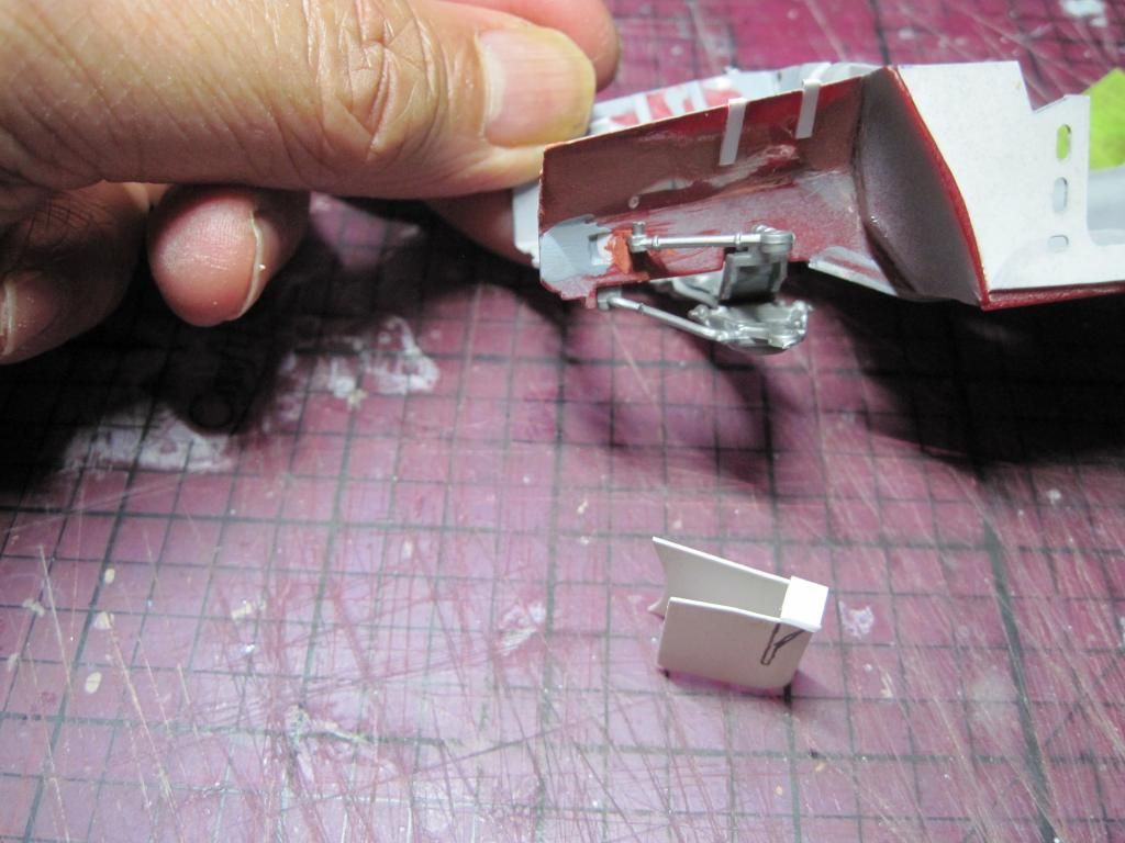

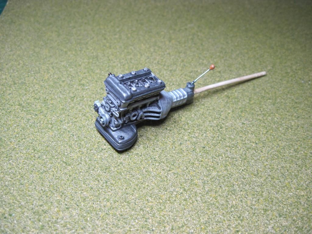

mikevillena Posted May 7, 2014 Author Share Posted May 7, 2014 I'm having to jump around the project as each area gets set aside to allow the primer, filler, repairs , etc. to dry/cure/go away......... A quick look made me realize that the details on the engine bay sides were different from the reference photo so I had to make modifications: Turned my attention to the engine. I wanted to replicate the fine texture on the various alloy castings so I tried many different approaches. I think this technique comes closest: Stock smooth Tamiya surface Texture added Someone must have slipped something funny in my coffee this morning or was it the "zen" that I mentioned earlier but I thought about making the shifter semi-functional. First gear: Second gear: Third gear: Experimenting with different shades of Metalizer: I will be added bosses and fastener details throughout. Thanks for looking in. Quote Link to comment Share on other sites More sharing options...

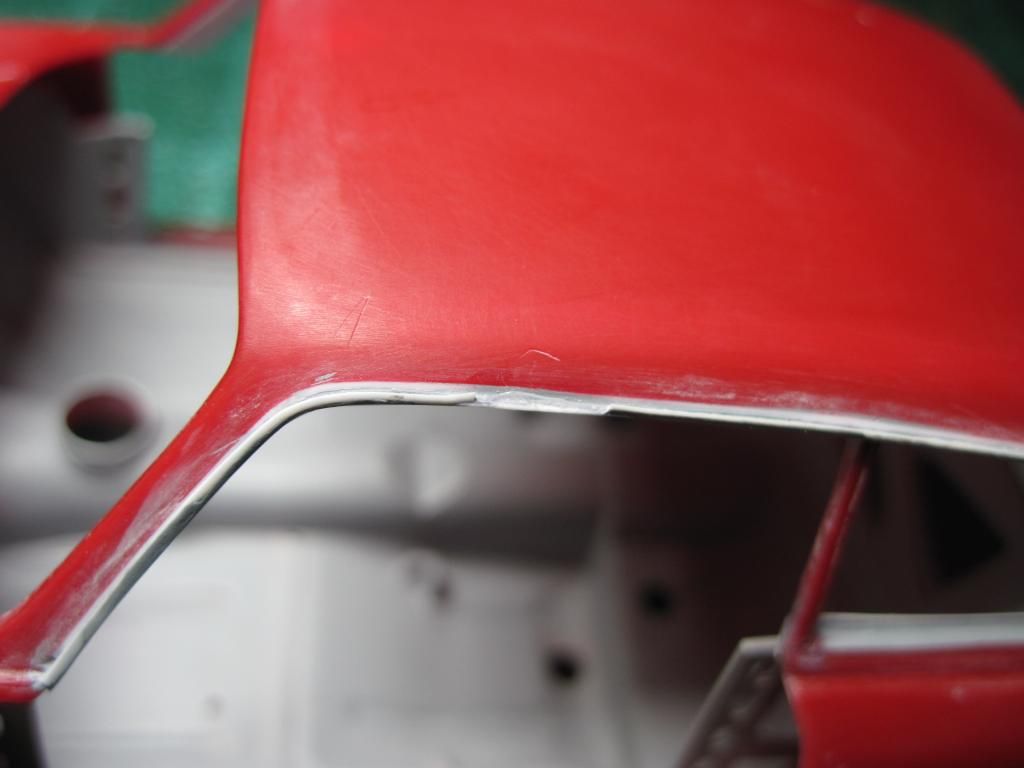

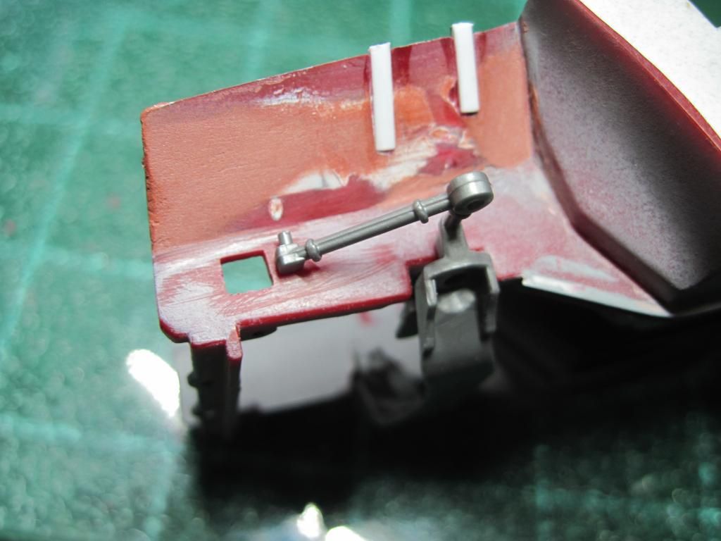

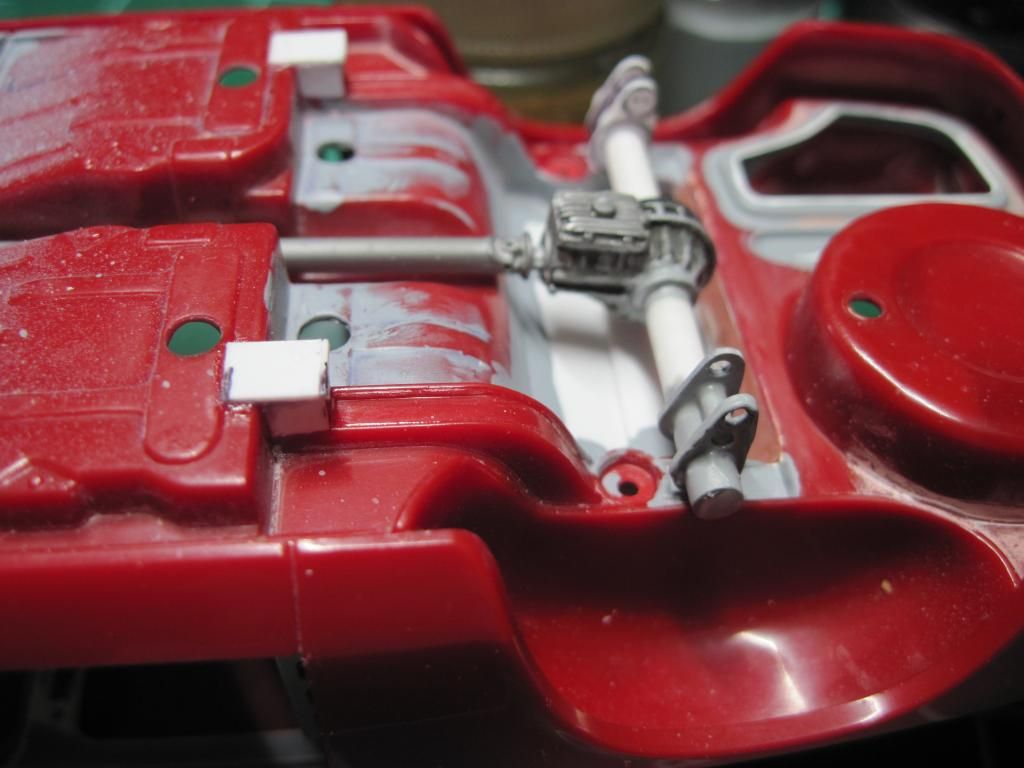

mikevillena Posted May 8, 2014 Author Share Posted May 8, 2014 A bit of "one step forward, two steps back" as the rain gutters proved to be rather fragile: Some careful repairs and I've set the bodyshell aside. Meanwhile, there were several issues with the suspension attachment points that need attention. No fault of Tamiya as they have had to make design compromises because of budget considerations. For the front suspension, I needed to revise the upper leading arm attachment point: The leading arm will be reworked so that it attaches properly. I've also had to build new shock mounts: With everything roughed in: The rear axle/diff housing also needs attention: Quote Link to comment Share on other sites More sharing options...

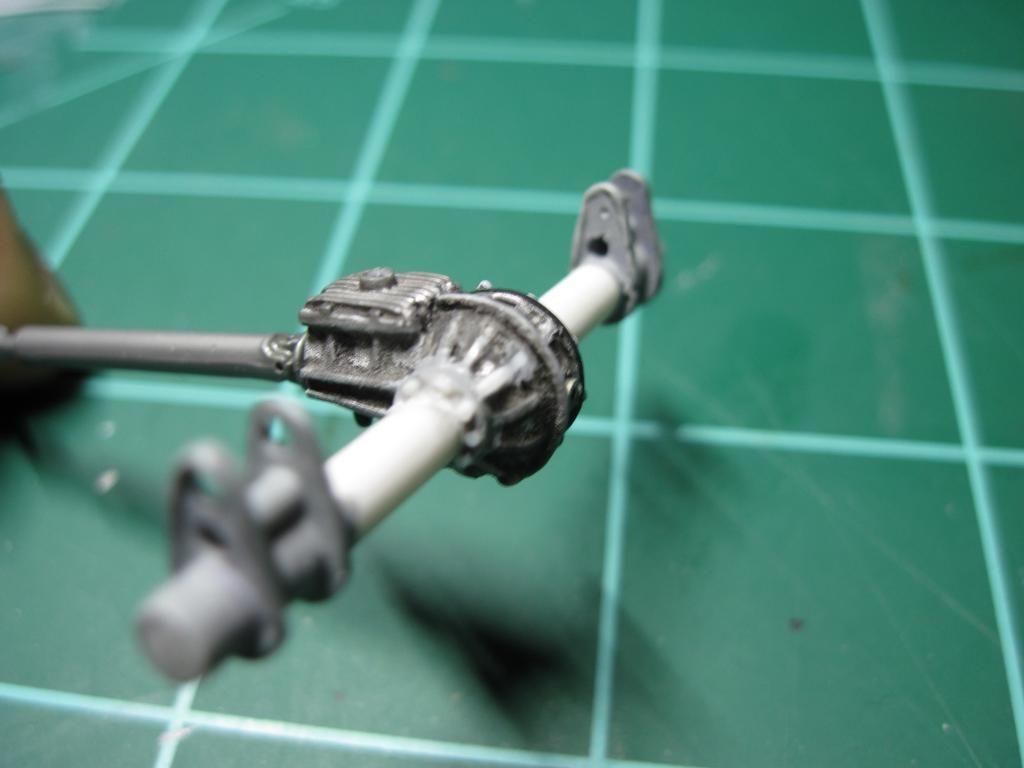

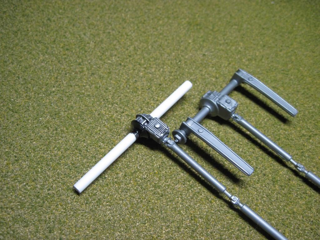

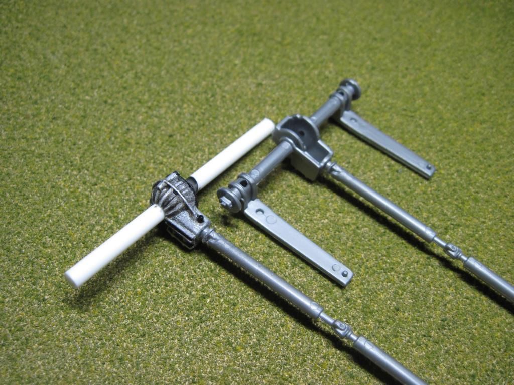

mikevillena Posted May 8, 2014 Author Share Posted May 8, 2014 Not much progress today. A little bit of work on the live axle as well as experimenting with textures and washes: Quote Link to comment Share on other sites More sharing options...

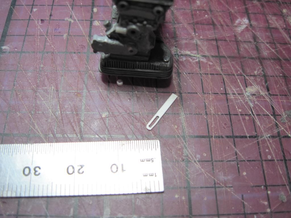

mikevillena Posted May 9, 2014 Author Share Posted May 9, 2014 Did a little more work on the engine. I fabricated the main pulley since the stock pulley/belt part was horrible. I also needed to fabricate the alternator adjusment bracket: Some of the bits in place. I was still experimenting with mixing various shades of Metalizer to simulate the corroded aluminum castings as well as pre-shading. I'll eventually re-spray everything and refine the washes: Quote Link to comment Share on other sites More sharing options...

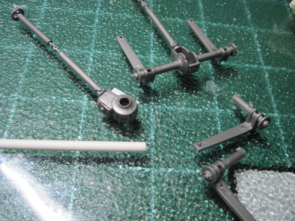

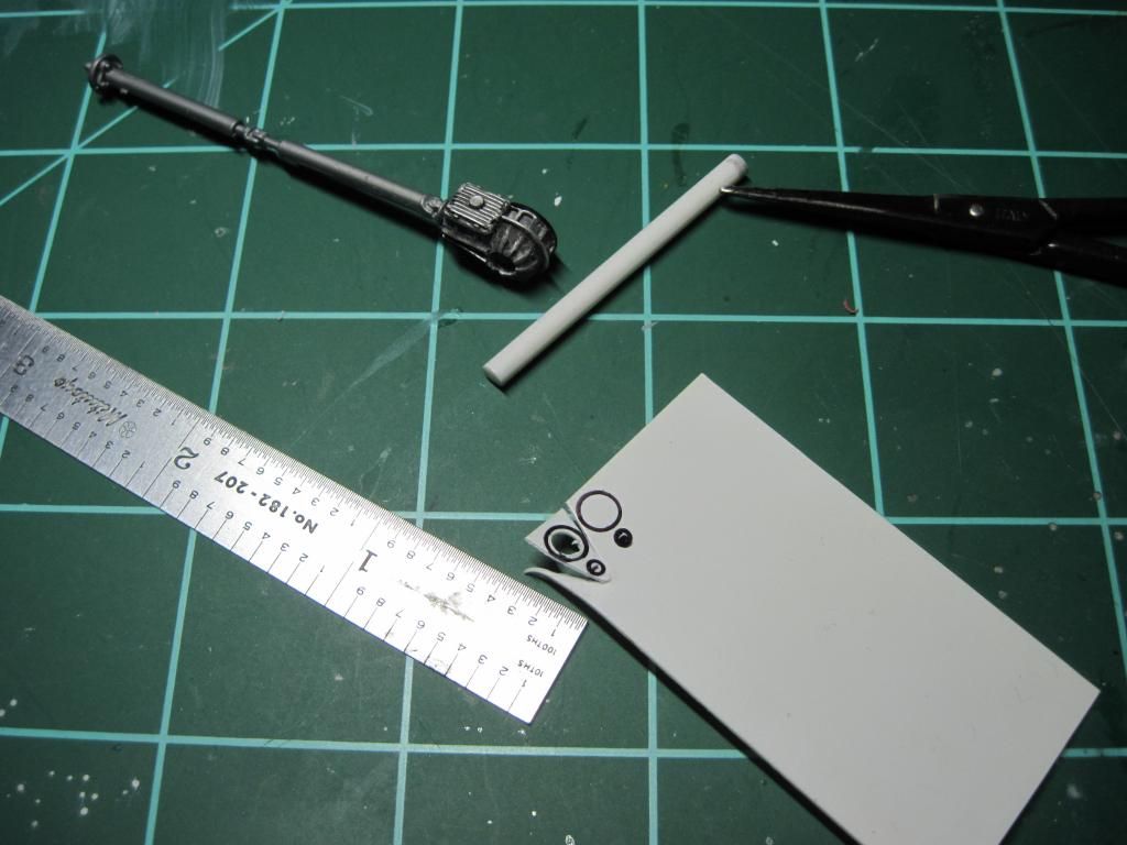

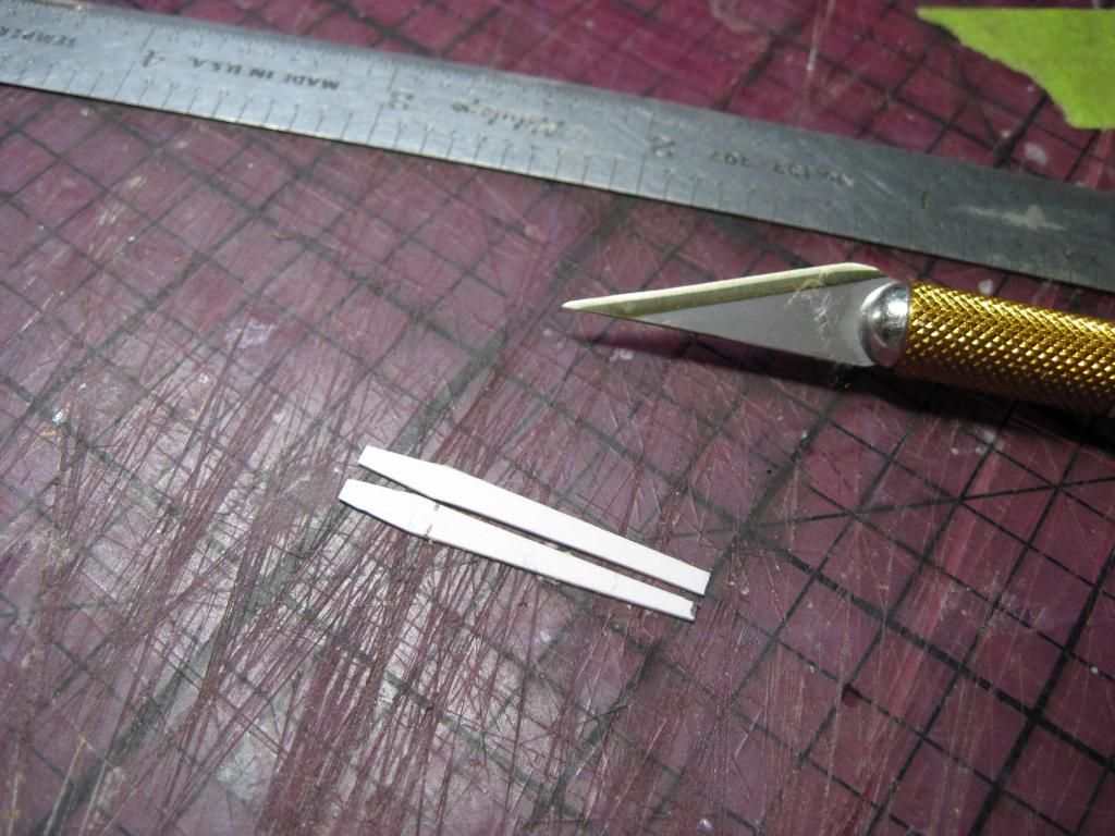

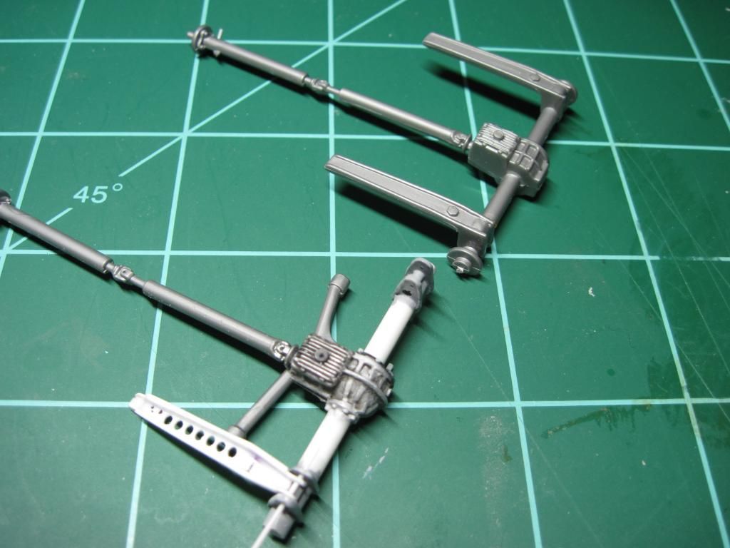

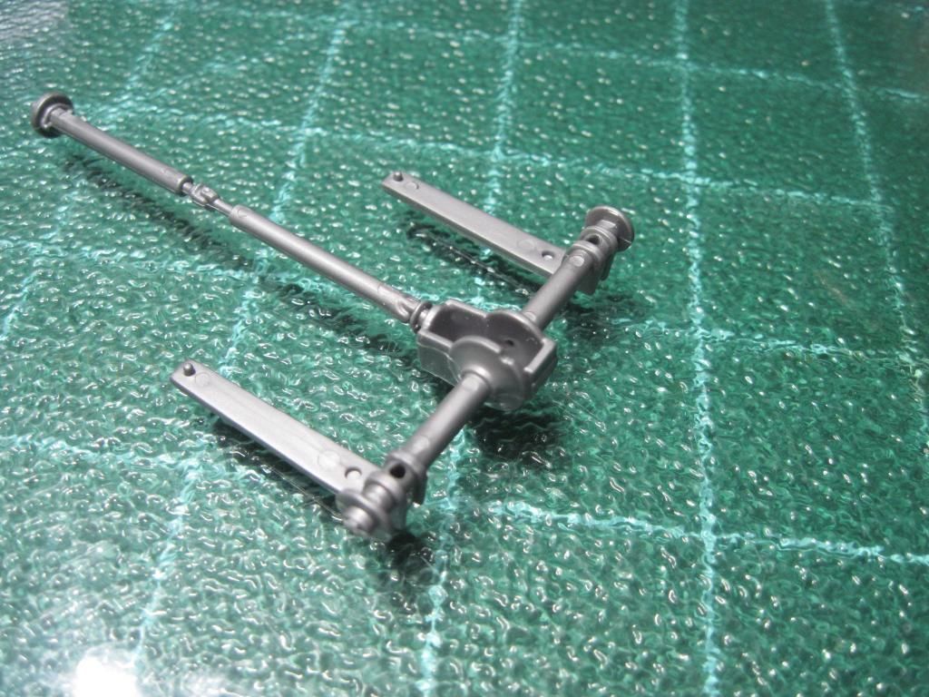

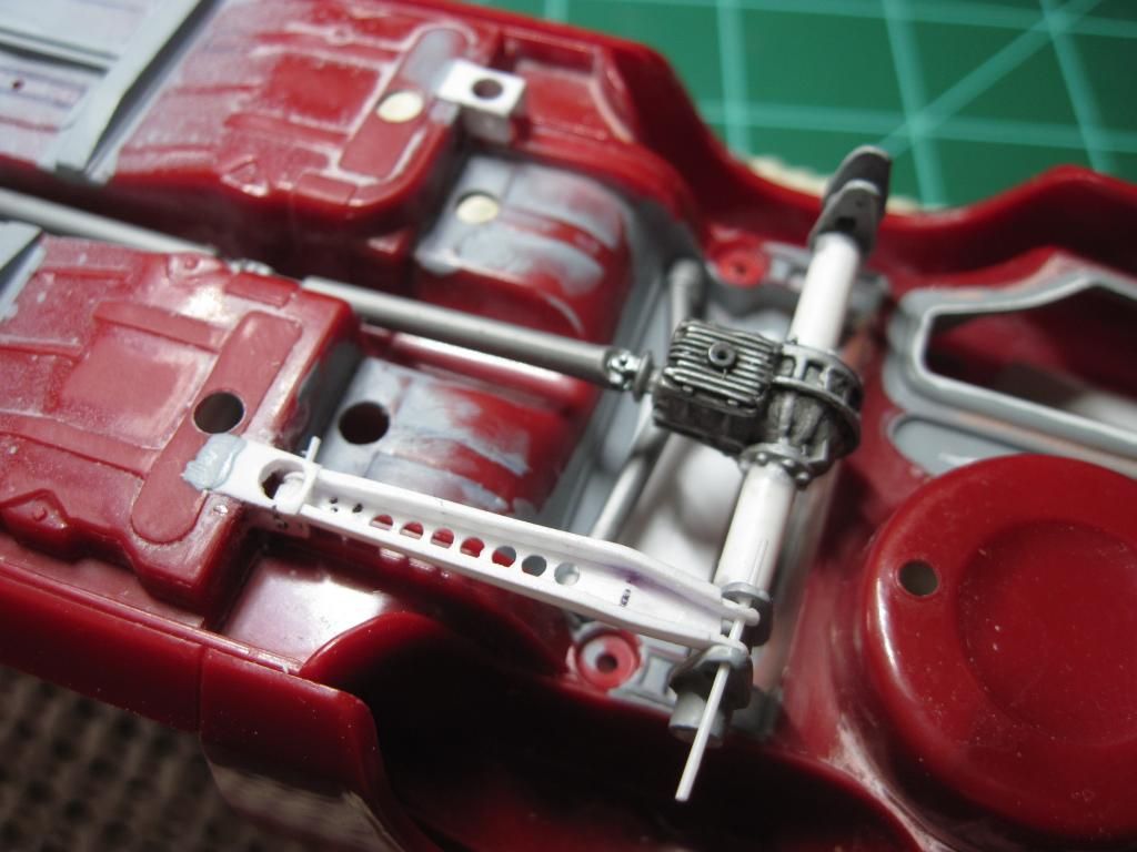

mikevillena Posted May 11, 2014 Author Share Posted May 11, 2014 (edited) Finished adding details to the diff housing and began work on the rear suspension: Fabricating the trailing arms: Sunday morning, having fun scratchbuilding and having some really good Italian coffee served in my favorite antique cup Trailing arm is swagged and lightened. Temporarily pinned to the chassis: An appreciable improvement over the kit's stock parts (I hope) Edited May 11, 2014 by mikevillena Quote Link to comment Share on other sites More sharing options...
