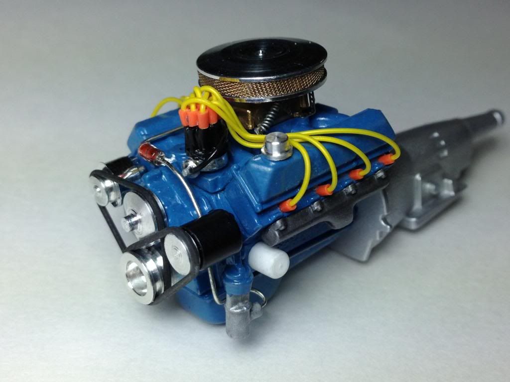

Finally was able to get some time at the bench. Here is the completed engine.

engine looks great!! is that glass in line fuel filter a resistor? like ones i could find in the pull out drawers at any radio shack??
cause that looks sweet!! great work on the motor wish i had a mini lathe and knew how to machine

I believe they at diodes and yes I got them at radio shack

I believe they are diodes and yes I got them at radio shack
