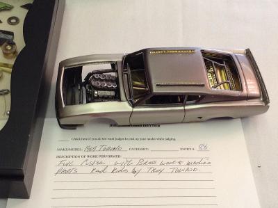

meaneyme Posted May 14, 2014 Cruz, you don't need to use urethanes to accomplish a good paintjob, you have already shown us how great your work is just by sticking with the basics. No disrespect to Jimmy but if you look at that Merc, the panel lines are completely gone. To me, the urethanes are way too thick and yes, I am gonna hear some people suggesting that if you thin them and shoot them the right way they can certainly be used. I know of quite a few people that use them but 1 out of 10 have the trick mastered, the others just have an idea. Quote Share this post Link to post Share on other sites

J Smith Posted May 15, 2014 Kevin, Kevin I didn't take it at disrespectful. The model that I posted the panel lines are not gone. If you could see it in person you could tell. What I do is before I primer is cut the panel lines a little bit deeper so the clear coat won't fill in. Quote Share this post Link to post Share on other sites
cotto Posted May 19, 2014 Cruz, why fix something that's not broken? You are very well known for your awesome paint jobs, you don't need those thick and dangerous urethanes, just keep doing what you're doing and save yourself the hassle and your money. Jimmy, no disrespect but yes, your lines are there of course but sorry, they are completely full of clear, there is really no detail left on your panel lines.. Looks nice, just too "syrupie". Quote Share this post Link to post Share on other sites
