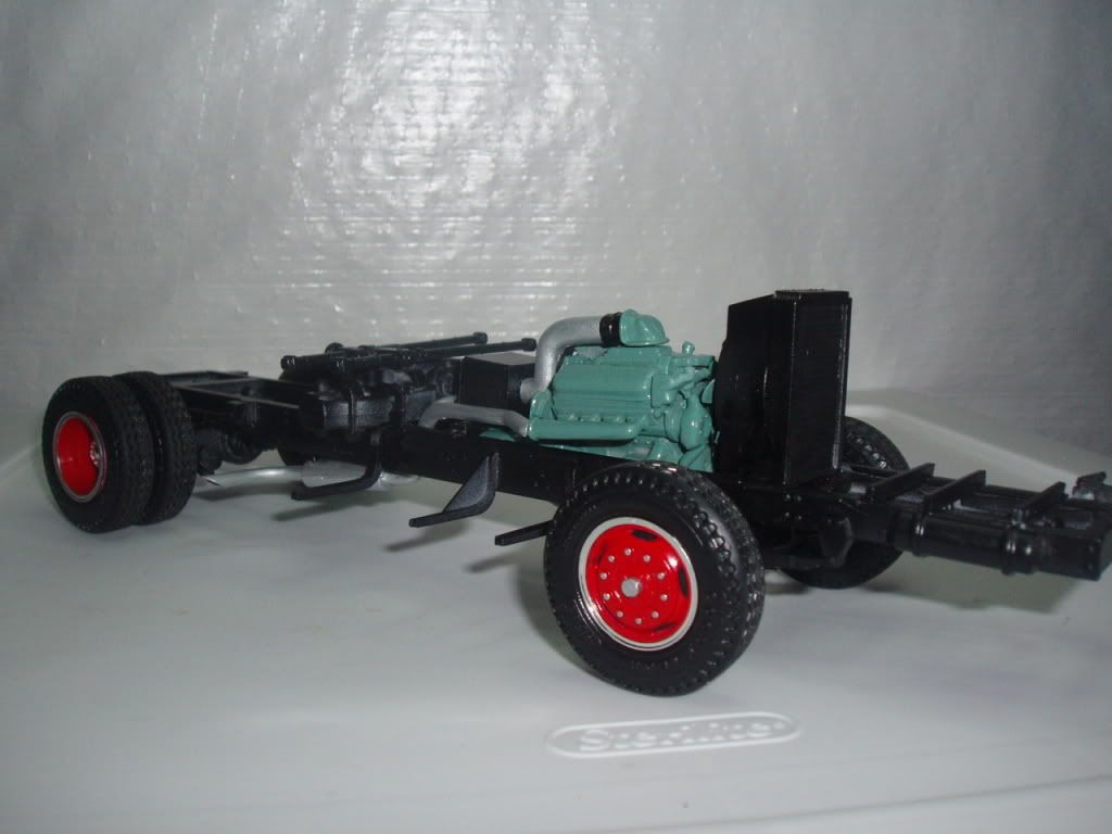

I've found that the Dupli-Color Alpine Green is quite dark for the 1970s Detroit Diesels. What I use is Testors Model Master Grun RLM 62. Here it is an a 1970 American-LaFrance Series 1000:
