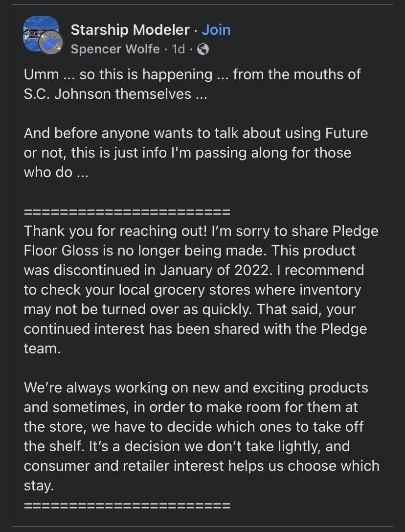

Guys, is Revive It still on the shelves in the USA? Impossible to get here in the UK. Has it gone the way of Klear?
Assuming that no Johnson's similar products are now available can you guys suggest viable alternatives from other manufacturers. I'm not talking about dedicated modelling materials here, but a commercial floor product similar to Klear, Future, Revive It.
Suggestions welcome.
Link to comment
According to the post earlier in this thread (March 12), this floor coating has been discontinued.
Discontinued products show up on amazon and eBay, but usually at ridiculously high prices.
Link to comment
Saw some of the Klear racketeering prices on Ebay......ridiculous!
Came across Flory Models Utube video where Klear and newer alternatives are being compared. The guy in the video is comparing a new clear Johnson's product that is only available in the States as a very good replacement for Klear.
Anybody tried any other acrylic floor products other than any of the Johnson's brands. If so, what are they named and who made by, and how did they perform? I'm talking about commercial floor coatings that will do the same as Klear, not dedicated modelling clear coatings.
