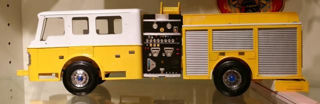

The project began with the Trumpeter kit. I wanted to make roll up doors instead of the standard swing out doors provided in the kit. Careful removal of the doors and replacement of the frame material was built up from Evergreen styrene strip. The recessed style roll up doors were created from Evergreen v-groove sheet.
Note that in many of these photos, the body is just tacked together with masking tape for mock up.

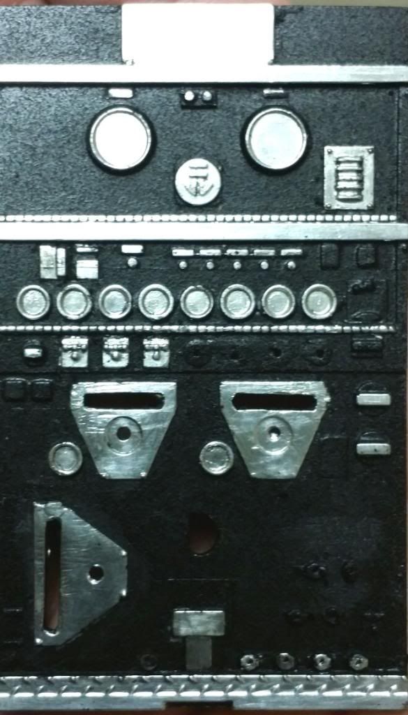

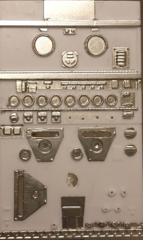

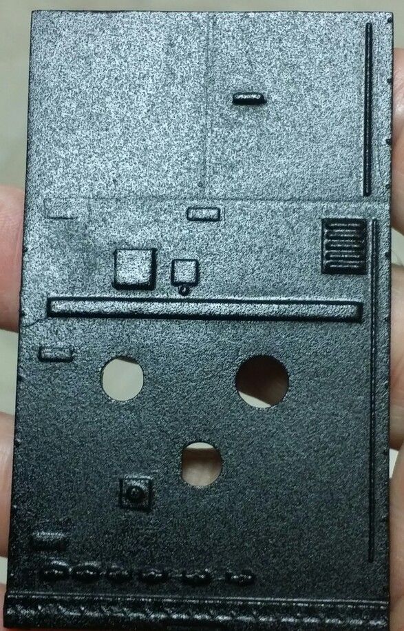

Attention was now turned towards the pump panels. As many of today's apparatus have black gauge panels,I sought to replicate this look. I had stumbled upon this process and thought I would give it a try. I applied BMF to the areas that I wanted chrome or painted instead of the black.

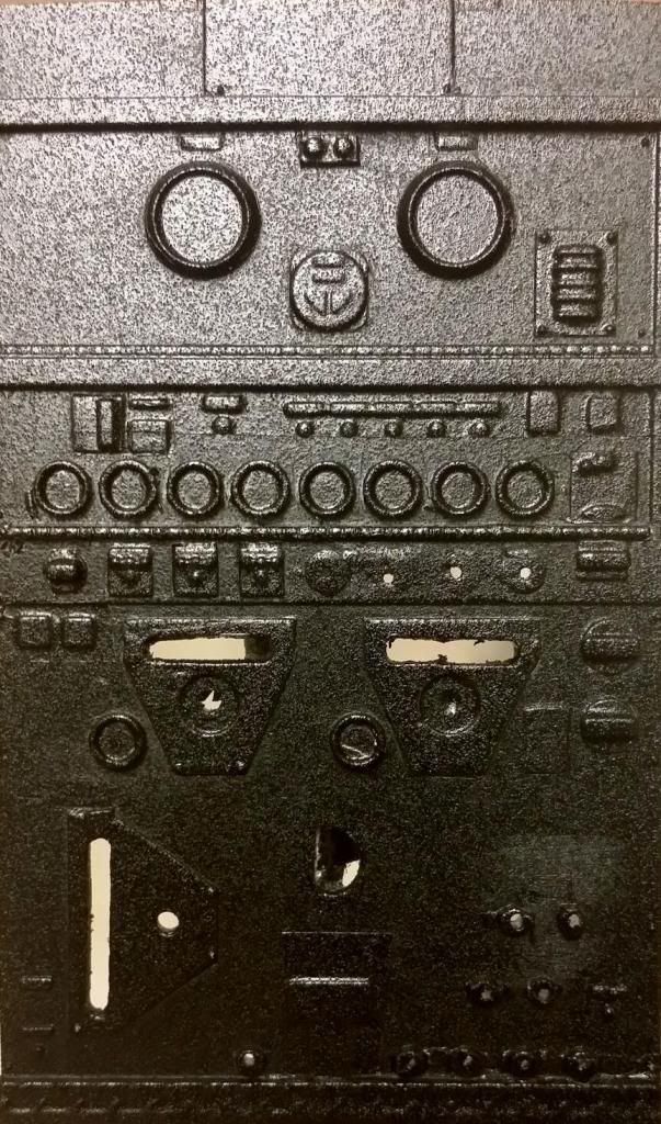

For the textured black areas of the panel, I used Rustoleum Textured paint.
This is how the panel looked after the texture coating:
Some time, q-tips, fine microbrushes, andTamiya fine cotton swabs and small amounts of lacquer thinner revealed this:

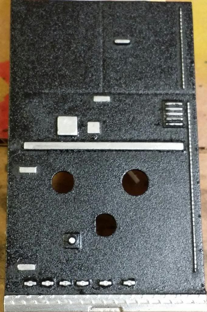

Still have to remove the paint from the officer's side panel:

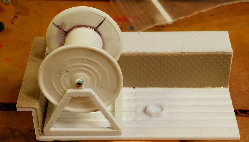

I also modified the area above the pump panel, cutting out and filling it to contain a hose reel.

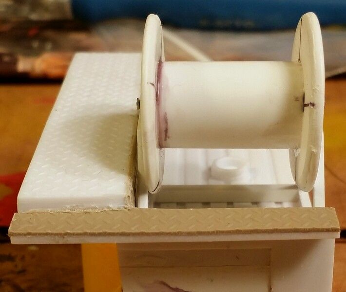

Thanks for the kind comments! @ Jules, I have been involved in emergency services for 30+ years. Thanks Jim for the link. Jules, you can Google "American La France Eagle fire trucks" for reference photos. Here is another little update:
Cleaned off the officer's side panel. Still need to touch up the area where the water tank level lights are.
Here is the modified top area of the pump panel.
The hose reel was made from AMT ALF hose reel ends. The ends were sanded to a much thinner thickness, as from the box they are way too thick. The ends then had Evergreen round stock applied around the outside. The inside ends were filled with dissolved sprue, allowed to dry and sanded. The insides were then sanded flat. The hose reel frame was constructed from Evergreen stock.
Still have to decide on Alclad finishes for the diamondplate. I want to complement the colors and other metallic finishes. I appreciate your comments. Thanks for looking!

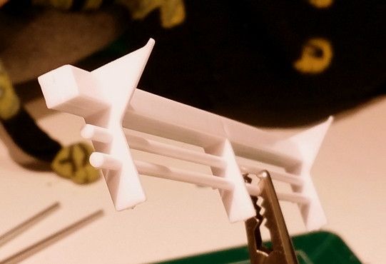

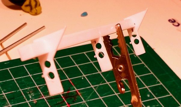

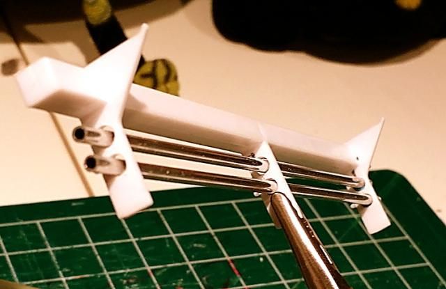

While viewing the ladder rack of the kit, it looked too generic and bland. In an effort to dress it up a little, I took the following steps:
The open areas around the aluminum tubing will be filled in. The rectangular areas at the top of the ladder rack appear to be a storage compartment for a folding attic ladder. I plan to wrap this with diamond plate. Thanks for looking!

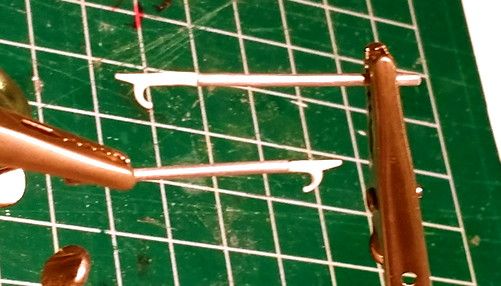

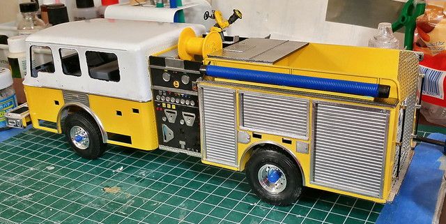

Here is a little update.  The rear body is glued together and the roll up door panels have been secured in place. Working on a hard suction hose. Roughed out the outlining of the windows with a custom mixed Vallejo "rubber" tone.   Lots more to do!
