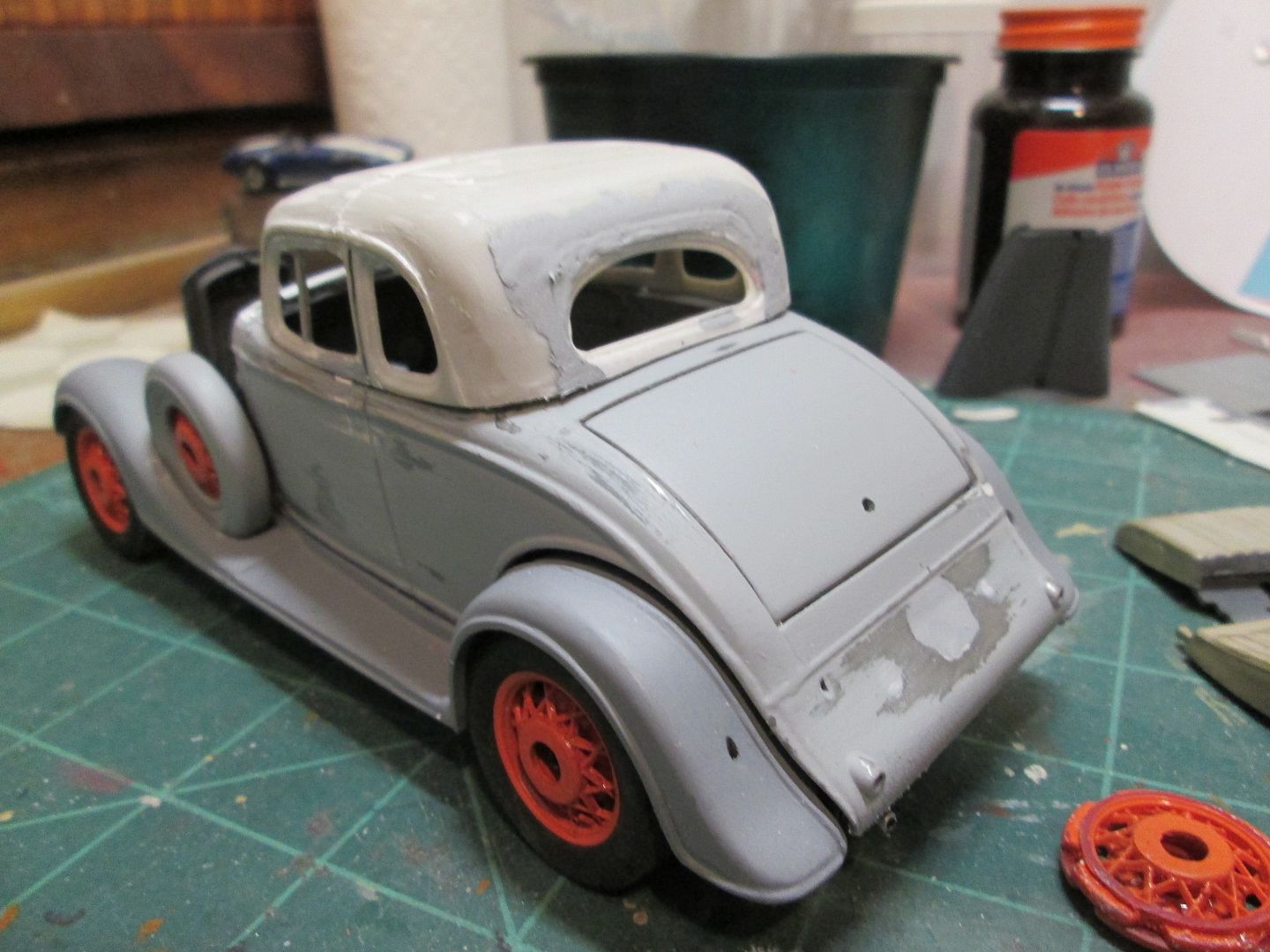

While our friend Fractalign is recuperating down under, I thought I'd take a run at making my own rear window. Using Fractalign's instructions in post #66, I printed the correct size photo on a label sheet and stuck it to a piece of styrene. I then cut out the actual window opening. As per his instructions, I cut out a slightly larger one. Instead of using them to make a mold, I glued them together. I will trim the inner one so the protruding material hopefully looks like a window reveal.

Fiddled with the window. Cut out the Ford window and inserted my home made Chevy one. I won't even hazard an opinion.

Put some putty on the rear window joint and filed and sanded along the bottom of the roof to get it to mate with the top of the deck.

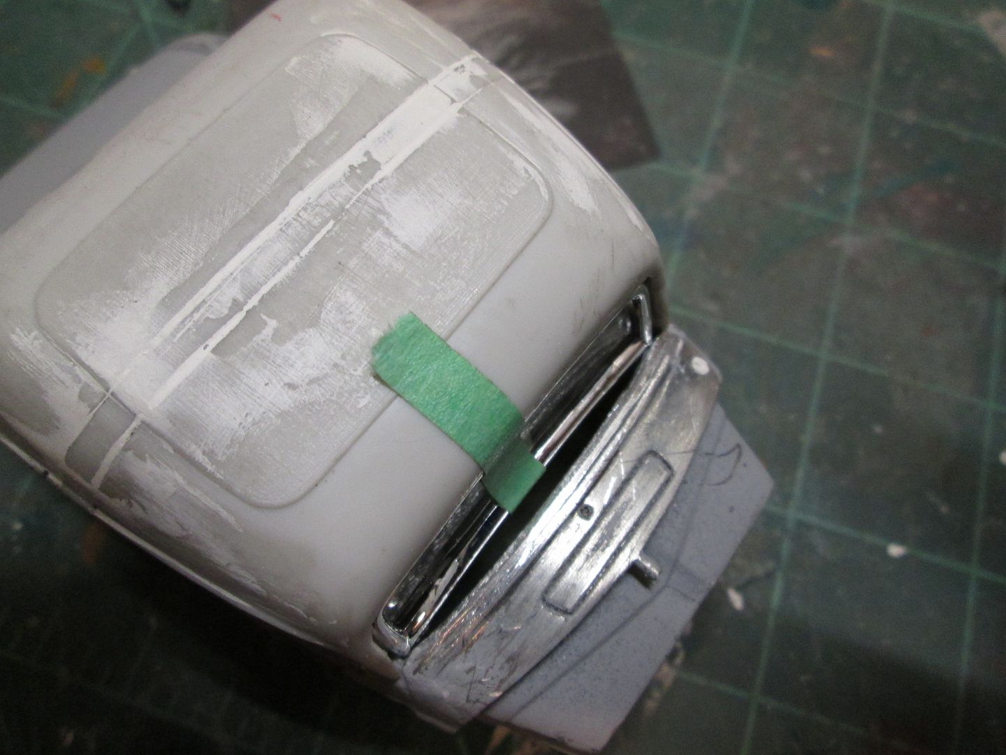

Found another thing which won't work, when I made a bottom for the front windshield I followed a line on top of the cowl. I realize now that isn't correct since the windshield is flat. I'm open to suggestions as how to rectify that blunder.
I will also attempt to make a better line for the front of the door opening.

Spent some time trying to figure out how to make the bottom of the windshield mate the diecast's cowl. This is the gap I have to fill.
File stroke by file stroke we are getting there. I am going to try for the tightest fit possible to avoid using too much filler which may crack.
