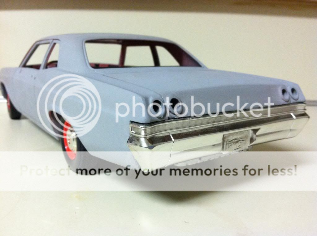

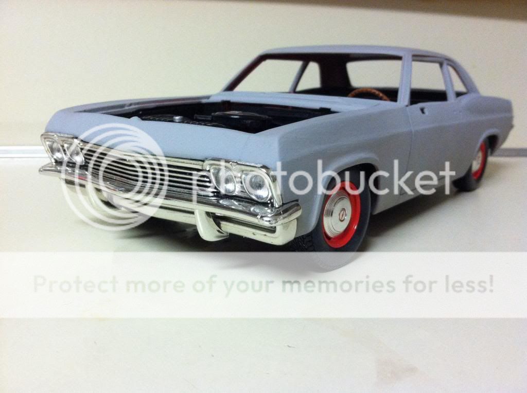

Body is cleared and turned out okay.
Not putting any big wheels on this,it got original brakes so there is no need for it. I put some redline decals on more time correct
tires. Not sure why it looks like there is somthing white on them,there is not. %&/) camera! Dash done,firewall and radiator support
painted. Stupid question maby,but are the original wheel 14" inches on these?
Share this post
Link to post
14" steel wheels were the standard with dig dish caps. Redlines and steelies will look great with the body color you chose.
