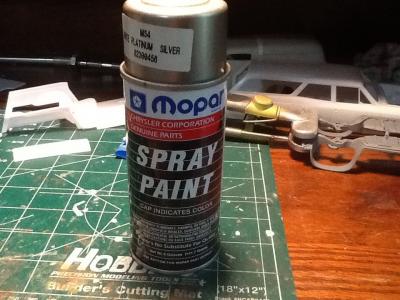

Need to know if this stuff is lacquer ...
Just so I know if I can use lacquer clear coat or if I need to use enamel clear over it...

Don't risk it! Test on scrap plastic.

If you're spraying it from the can (as opposed to an airbrush), why not pick up a can of clear in the same brand?

Shoot it on a white plastic picnic spoon, then shoot your clear over it. If you encounter a compatibility problem, you can repeat with as many spoons as you need until you find the right combination.
A package of spoons is cheaper than a kit.

I have used this paint on a challenger and put testors wet look clear over it. And tamiya clear no problemsIMAG0093_zps31275d27.jpg
