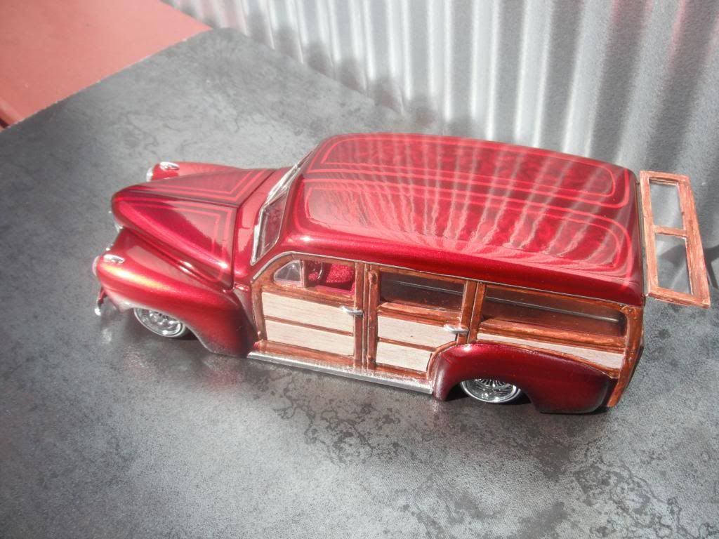

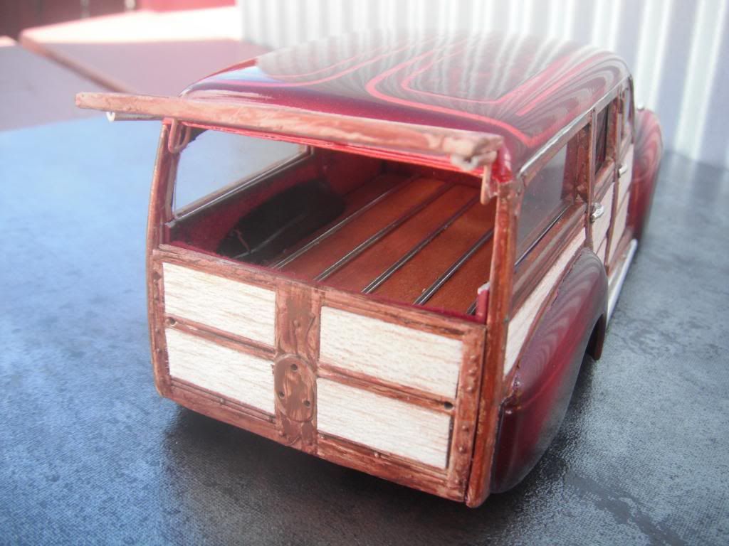

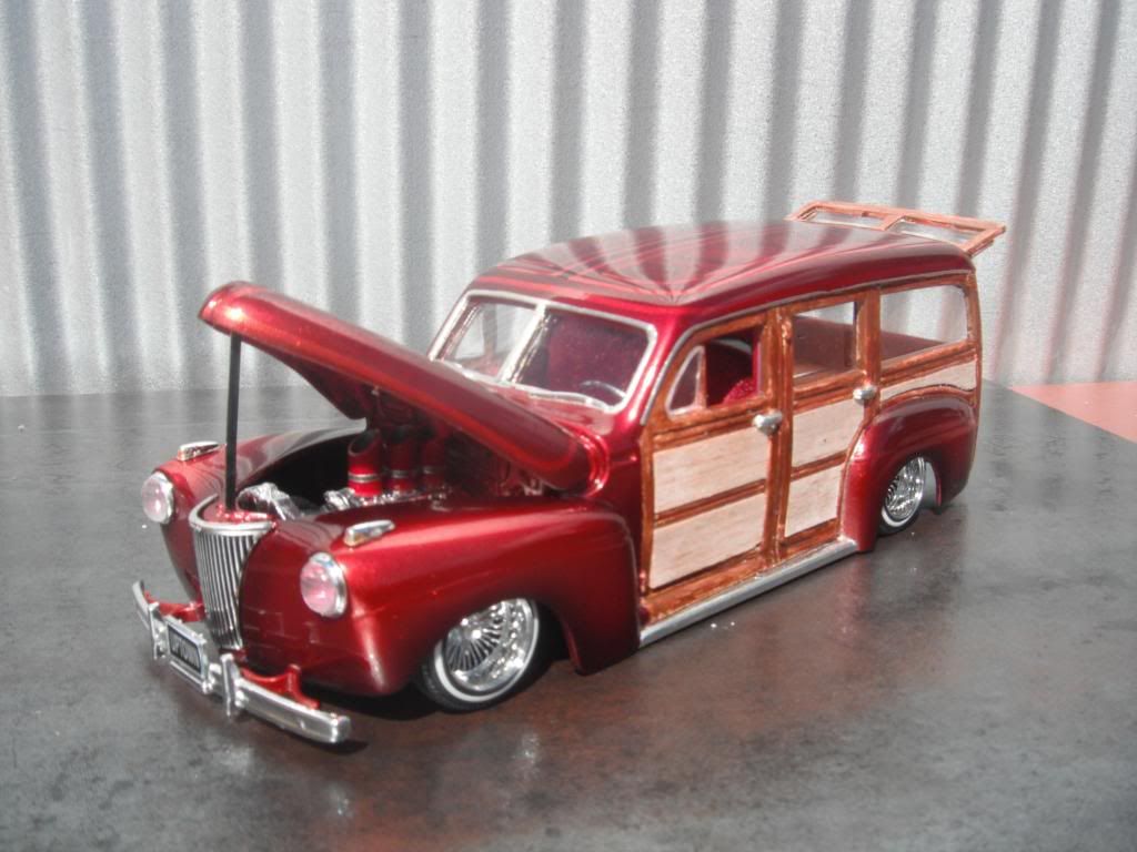

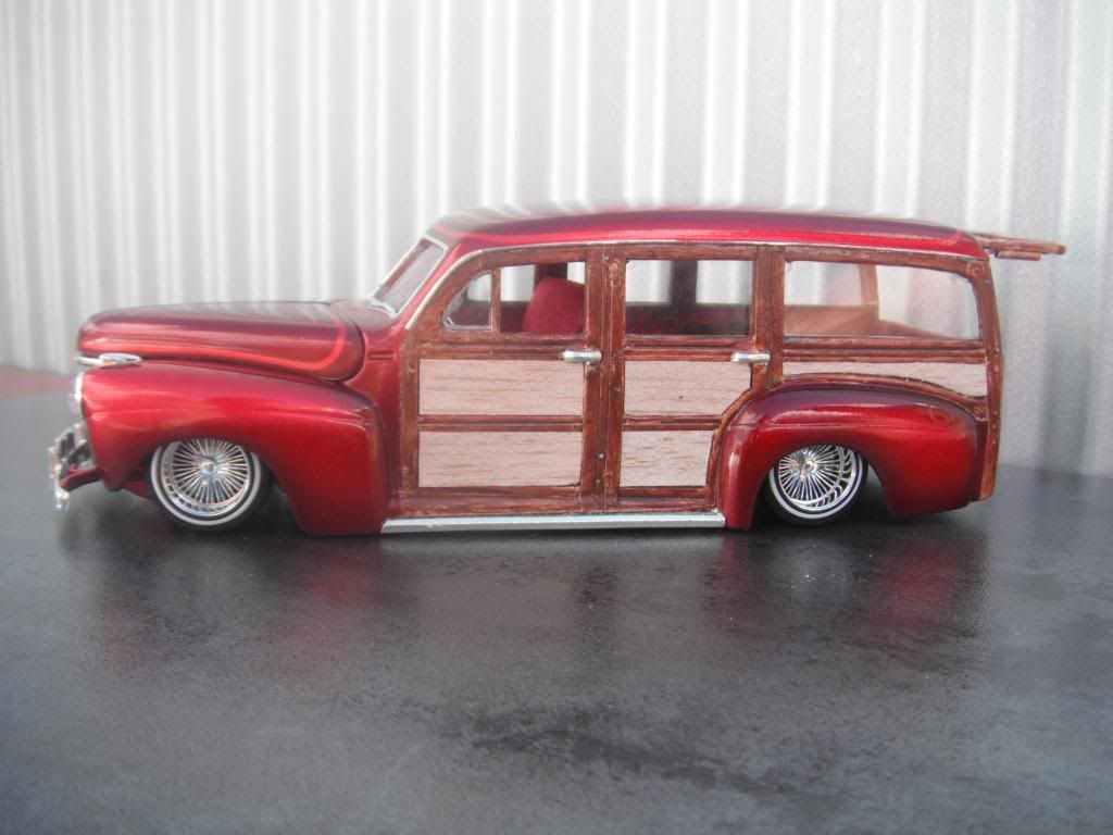

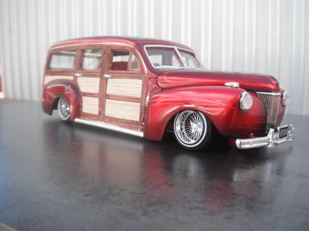

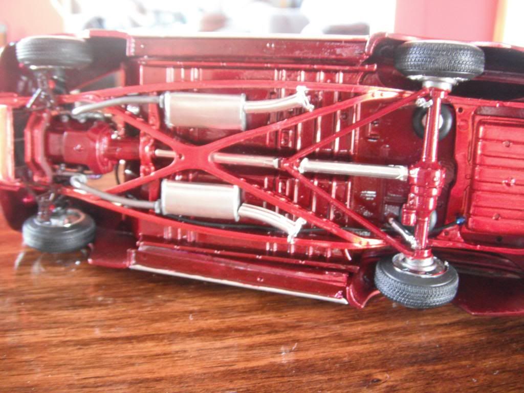

DeeCee Posted July 2, 2014 Share Posted July 2, 2014 This was a recent re-build of a 41 Woody which i originally built 10 years ago. I filled in the front vents to smooth it out, took a slice out of the hood profile, channeled the chassis a little, remover the rear seat and extended the floor in timber. Paint is Automotive acrylic. cheers, Dale Quote Link to comment Share on other sites More sharing options...

1 bad55 stan Posted July 3, 2014 Share Posted July 3, 2014 Nice!Your a master with that air brush mate,What type of masking tape do you use or is there another way? Quote Link to comment Share on other sites More sharing options...

DeeCee Posted July 3, 2014 Author Share Posted July 3, 2014 Nice!Your a master with that air brush mate,What type of masking tape do you use or is there another way? Thank you very much guys, paint is my favorite part of building, so i like to challenge myself from time to time, and just play around with different ideas. If i stuff it up, "it's only paint", re-do it. Stan, i only use top quality tape for masking over paint, 3M blue, which is a low tack painters tape, and have just discovered Nitto-Denko 60 day tape, it comes back off easily with out lifting the lower layers of paint. (hopefully). I lay it on a glass surface and slice it into strips with a brand new hobby blade, that way you get a nice edge. cheers, Dale Quote Link to comment Share on other sites More sharing options...
