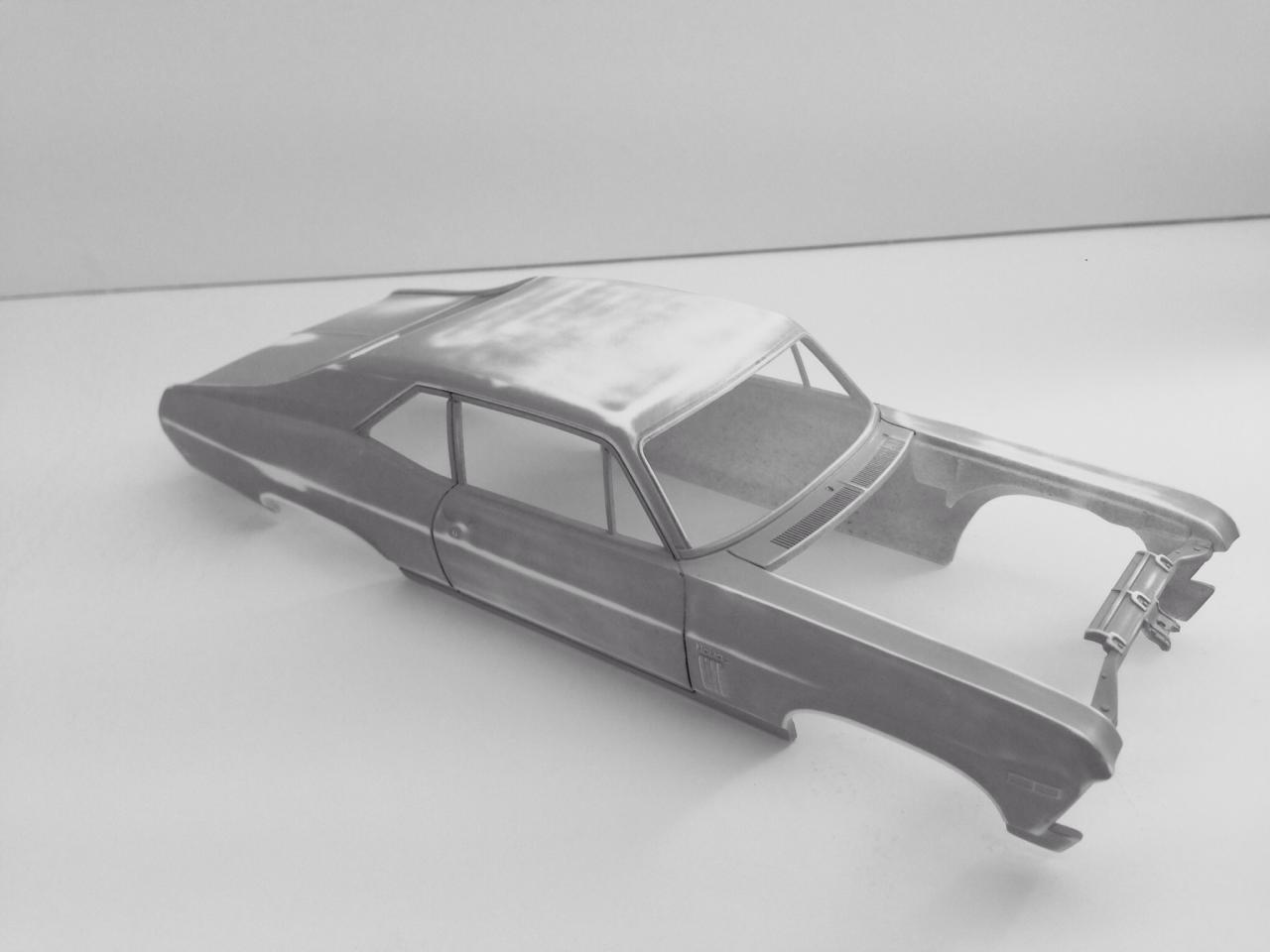

So I cleaned that up and wet sanded the body and the hood using #1000 grit. After that I scribed the panel lines and applied a black wash to the panel lines.
Here's progress so far, I will be priming hopefully by tomorrow.

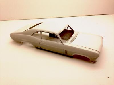

Partially Primed & Problems

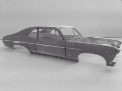

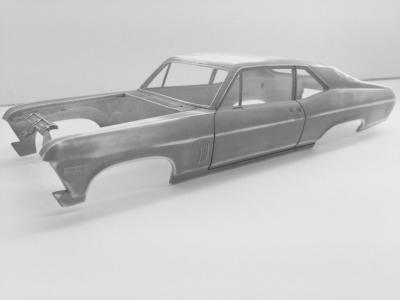

Well I laid the first coat of primer using Tamiya's grey surface primer. And the paint ran out, naturally I tried using all that I could get out of my moneys worth (lol) causing some paint drops on the roof of the car as well as some un even spray. Oh yea and a thumb print after dropping it.
Things happen but we gotta stay patient, so I wet sanded with #1000 grit, mostly fixating on the major parts first and then lightly throughout the rest of the car, then I followed that up with #2000 Grit. Then of course a re wash with soap and water.
Car looks great and is smoother than ever, which I always say, "the smoother it is, the better your paint job will be" And that goes with anything.
So Ill be picking up some Krylon Plastic white primer here in a bit and finish the car up for its primer stage.
Here's a pic after fixing. (I moved some lighting in my booth to help with yellow light tint & added a filter to the pic, to help fully see detail and process. But hey all great pics these days are edited haha. For future pics I'll turn off the background light)

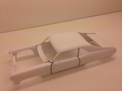

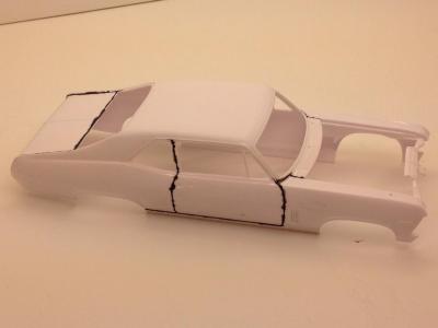

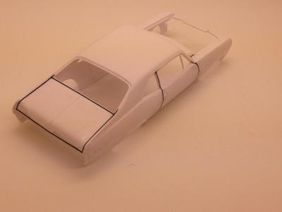

Here's the white primer down. I used Krylon color master white primer.
After 24 hours I will, wet sand and tooth paste(finest wet sand) and then it will be ready to paint.

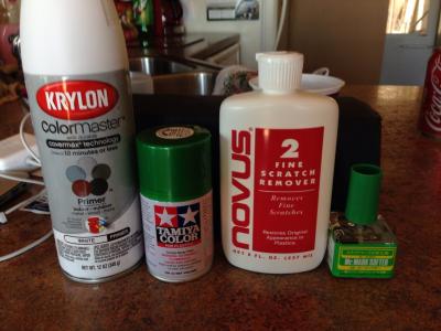

Here's a pic of the primer used, the green that was just sprayed for the first dust coat.
It's Tamiya TS-20
And then my new stuff that came today, novus 2 polish, and Mr. Mark Softer
Will have pics of the second dust coat soon.
